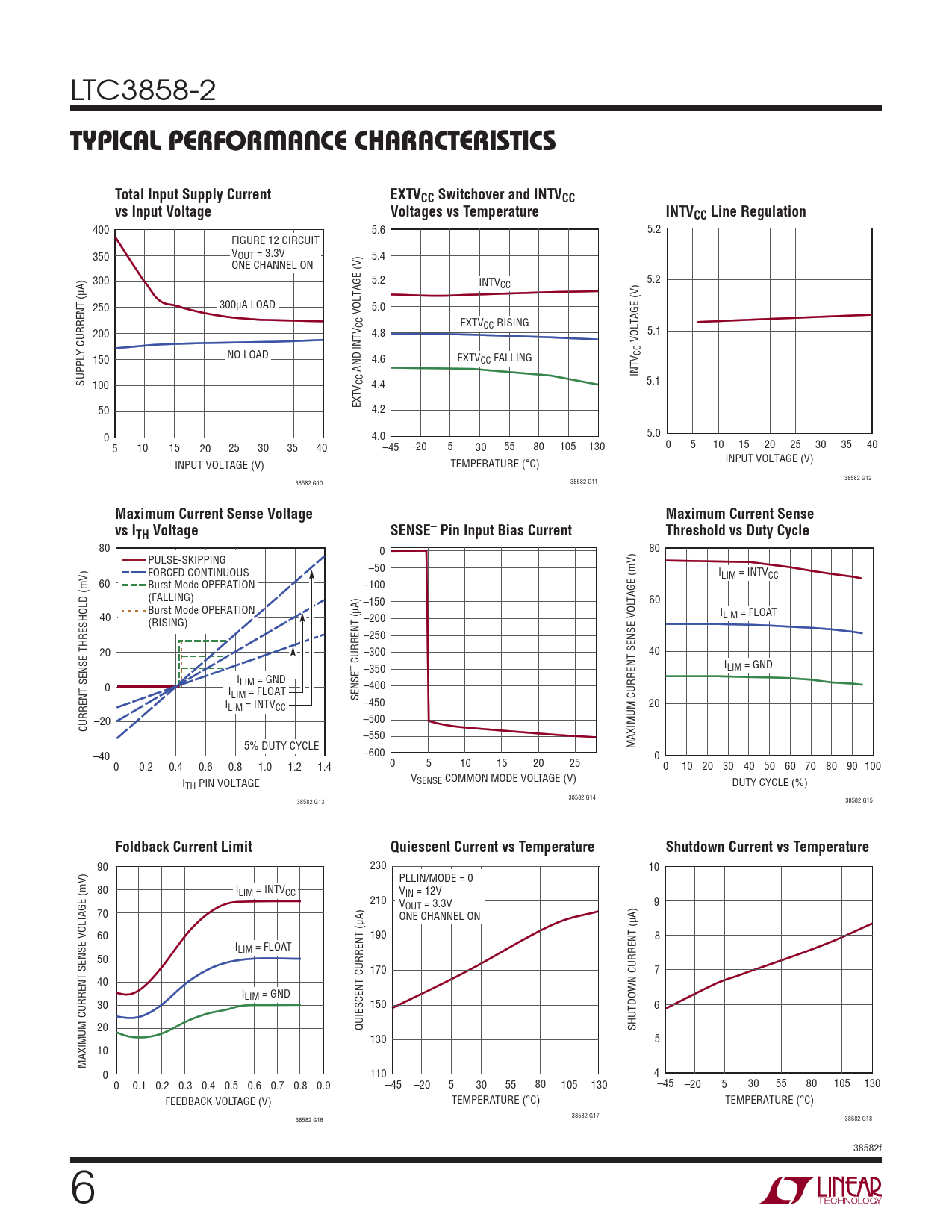

TYPICAL PERFORMANCE CHARACTERISTICS. Total Input Supply Current. EXTVCC Switchover and INTVCC. vs Input Voltage
LTC3858-2
TYPICAL PERFORMANCE CHARACTERISTICS Total Input Supply Current EXTVCC Switchover and INTVCC vs Input Voltage Voltages vs Temperature INTVCC Line Regulation
400 5.6 5.2 FIGURE 12 CIRCUIT 350 VOUT = 3.3V 5.4 ONE CHANNEL ON 300 5.2 INTV 5.2 CC 250 300μA LOAD 5.0 VOLTAGE (V) CC EXTVCC RISING 200 4.8 5.1 VOLTAGE (V) NO LOAD CC 150 4.6 EXTVCC FALLING AND INTV INTV SUPPLY CURRENT (μA) 100 CC 4.4 5.1 EXTV 50 4.2 0 4.0 5.0 5 10 15 20 25 30 35 40 –45 –20 5 30 55 80 105 130 0 5 10 15 20 25 30 35 40 INPUT VOLTAGE (V) INPUT VOLTAGE (V) TEMPERATURE (°C) 38582 G12 38582 G10 38582 G11
Maximum Current Sense Voltage Maximum Current Sense vs ITH Voltage SENSE– Pin Input Bias Current Threshold vs Duty Cycle
80 0 80 PULSE-SKIPPING –50 FORCED CONTINUOUS ILIM = INTVCC 60 Burst Mode OPERATION –100 (FALLING) –150 TAGE (mV) 60 Burst Mode OPERATION I 40 –200 LIM = FLOAT (RISING) –250 20 –300 40 CURRENT (μA)– –350 ILIM = GND ILIM = GND –400 0 ILIM = FLOAT SENSE –450 ILIM = INTVCC 20 –500 –20 CURRENT SENSE THRESHOLD (mV) –550 5% DUTY CYCLE MAXIMUM CURRENT SENSE VOL –600 –40 0 0 5 10 15 20 25 0 0.2 0.4 0.6 0.8 1.0 1.2 1.4 0 10 20 30 40 50 60 70 80 90 100 VSENSE COMMON MODE VOLTAGE (V) ITH PIN VOLTAGE DUTY CYCLE (%) 38582 G14 38582 G13 38582 G15
Foldback Current Limit Quiescent Current vs Temperature Shutdown Current vs Temperature
