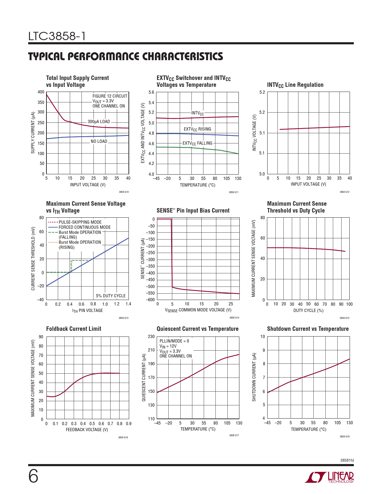

DescriptionLow IQ, Dual 2-Phase Synchronous Step-Down Controller
Pages / Page38 / 6 — TYPICAL PERFORMANCE CHARACTERISTICS. Total Input Supply Current. EXTVCC …
File Format / SizePDF / 439 Kb
TYPICAL PERFORMANCE CHARACTERISTICS. Total Input Supply Current. EXTVCC Switchover and INTVCC. vs Input Voltage
TYPICAL PERFORMANCE CHARACTERISTICS Total Input Supply Current EXTVCC Switchover and INTVCC vs Input Voltage
LTC3858-1
TYPICAL PERFORMANCE CHARACTERISTICS Total Input Supply Current EXTVCC Switchover and INTVCC vs Input Voltage Voltages vs Temperature INTVCC Line Regulation
400 5.6 5.2 FIGURE 12 CIRCUIT 350 VOUT = 3.3V 5.4 ONE CHANNEL ON 300 5.2 INTVCC 5.2 250 300μA LOAD 5.0 VOLTAGE (V) CC EXTVCC RISING 200 4.8 5.1 VOLTAGE (V) NO LOAD 150 CC 4.6 EXTVCC FALLING AND INTV INTV SUPPLY CURRENT (μA) 100 CC 4.4 5.1 50 EXTV 4.2 0 4.0 5.0 5 10 15 20 25 30 35 40 –45 –20 5 30 55 80 105 130 0 5 10 15 20 25 30 35 40 INPUT VOLTAGE (V) TEMPERATURE (°C) INPUT VOLTAGE (V) 3858 G10 3858 G11 3858 G12
Maximum Current Sense Voltage Maximum Current Sense vs ITH Voltage SENSE– Pin Input Bias Current Threshold vs Duty Cycle
80 0 80 PULSE-SKIPPING MODE –50 FORCED CONTINUOUS MODE 60 Burst Mode OPERATION –100 (FALLING) –150 TAGE (mV) 60 Burst Mode OPERATION 40 –200 (RISING) –250 20 –300 40 CURRENT (μA)– –350 0 –400 SENSE –450 20 –20 –500 CURRENT SENSE THRESHOLD (mV) –550 5% DUTY CYCLE MAXIMUM CURRENT SENSE VOL –40 –600 0 0 0.2 0.4 0.6 0.8 1.0 1.2 1.4 0 5 10 15 20 25 0 10 20 30 40 50 60 70 80 90 100 I V TH PIN VOLTAGE SENSE COMMON MODE VOLTAGE (V) DUTY CYCLE (%) 3858 G13 3858 G14 3858 G15
Foldback Current Limit Quiescent Current vs Temperature Shutdown Current vs Temperature
90 230 10 PLLIN/MODE = 0 80 VIN = 12V 210 V 9 OUT = 3.3V TAGE (mV) 70 ONE CHANNEL ON 60 190 8 50 170 7 40 30 150 6 20 QUIESCENT CURRENT (μA) SHUTDOWN CURRENT (μA) 130 5 10 MAXIMUM CURRENT SENSE VOL 0 110 4 0 0.1 0.2 0.3 0.4 0.5 0.6 0.7 0.8 0.9 –45 –20 5 30 55 80 105 130 –45 –20 5 30 55 80 105 130 FEEDBACK VOLTAGE (V) TEMPERATURE (°C) TEMPERATURE (°C) 3858 G17 3858 G16 3858 G18 38581fd 6
