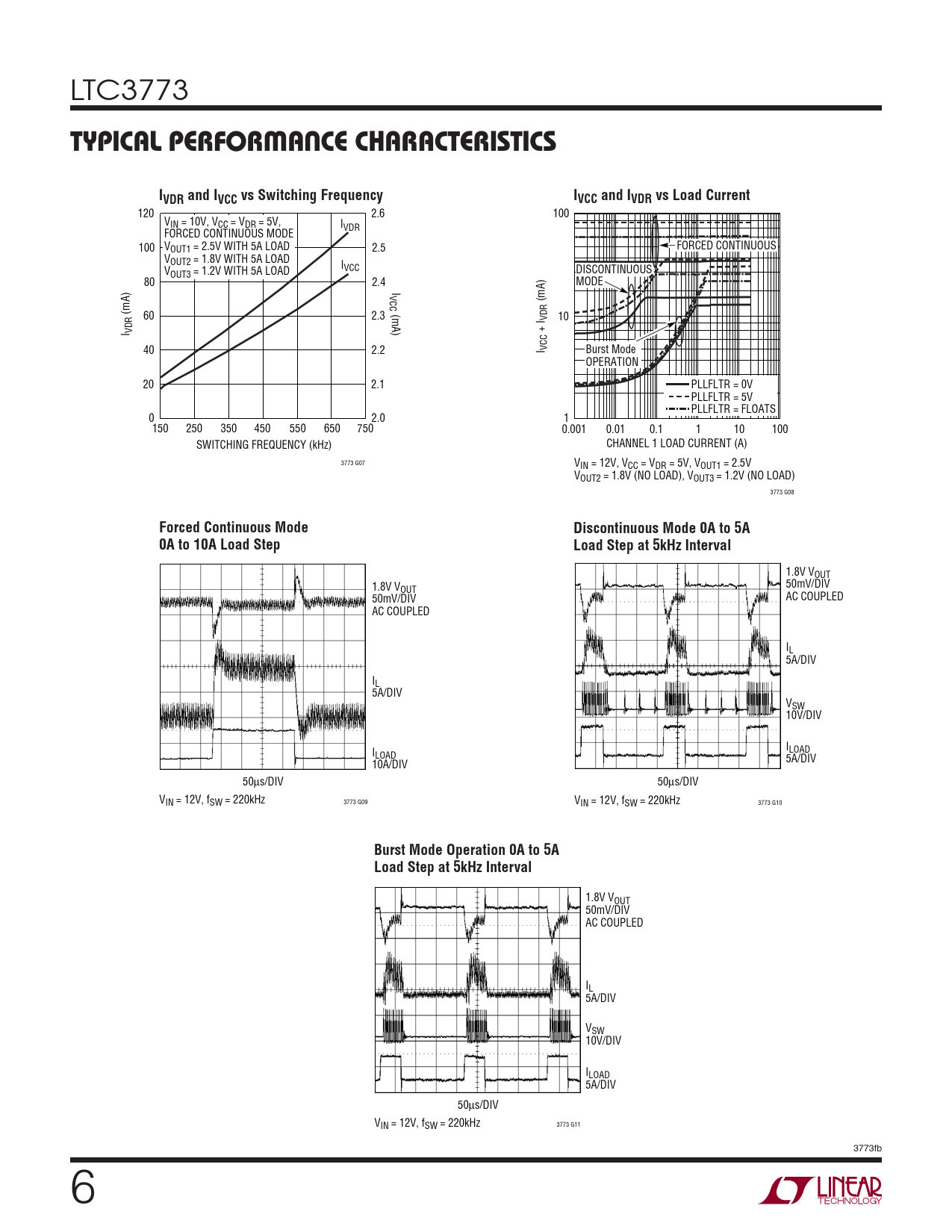

TYPICAL PERFORMANCE CHARACTERISTICS. IVDR and IVCC vs Switching Frequency. IVCC and IVDR vs Load Current
TYPICAL PERFORMANCE CHARACTERISTICS IVDR and IVCC vs Switching Frequency IVCC and IVDR vs Load Current
LTC3773
120 2.6 100 VIN = 10V, VCC = VDR = 5V, IVDR FORCED CONTINUOUS MODE 100 VOUT1 = 2.5V WITH 5A LOAD 2.5 FORCED CONTINUOUS VOUT2 = 1.8V WITH 5A LOAD I V VCC OUT3 = 1.2V WITH 5A LOAD DISCONTINUOUS 80 2.4 MODE IVCC (mA) (mA) (mA) 60 2.3 VDR 10 I VDR + I 40 2.2 I VCC Burst Mode OPERATION 20 2.1 PLLFLTR = 0V PLLFLTR = 5V PLLFLTR = FLOATS 0 2.0 1 150 250 350 450 550 650 750 0.001 0.01 0.1 1 10 100 SWITCHING FREQUENCY (kHz) CHANNEL 1 LOAD CURRENT (A) 3773 G07 VIN = 12V, VCC = VDR = 5V, VOUT1 = 2.5V VOUT2 = 1.8V (NO LOAD), VOUT3 = 1.2V (NO LOAD) 3773 G08
Forced Continuous Mode Discontinuous Mode 0A to 5A 0A to 10A Load Step Load Step at 5kHz Interval
1.8V VOUT 1.8V V 50mV/DIV OUT 50mV/DIV AC COUPLED AC COUPLED IL 5A/DIV IL 5A/DIV VSW 10V/DIV I I LOAD LOAD 5A/DIV 10A/DIV 50μs/DIV 50μs/DIV V 3773 G09 IN = 12V, fSW = 220kHz V 3773 G10 IN = 12V, fSW = 220kHz
Burst Mode Operation 0A to 5A Load Step at 5kHz Interval
1.8V VOUT 50mV/DIV AC COUPLED IL 5A/DIV VSW 10V/DIV ILOAD 5A/DIV 50μs/DIV V 3773 G11 IN = 12V, fSW = 220kHz 3773fb 6
