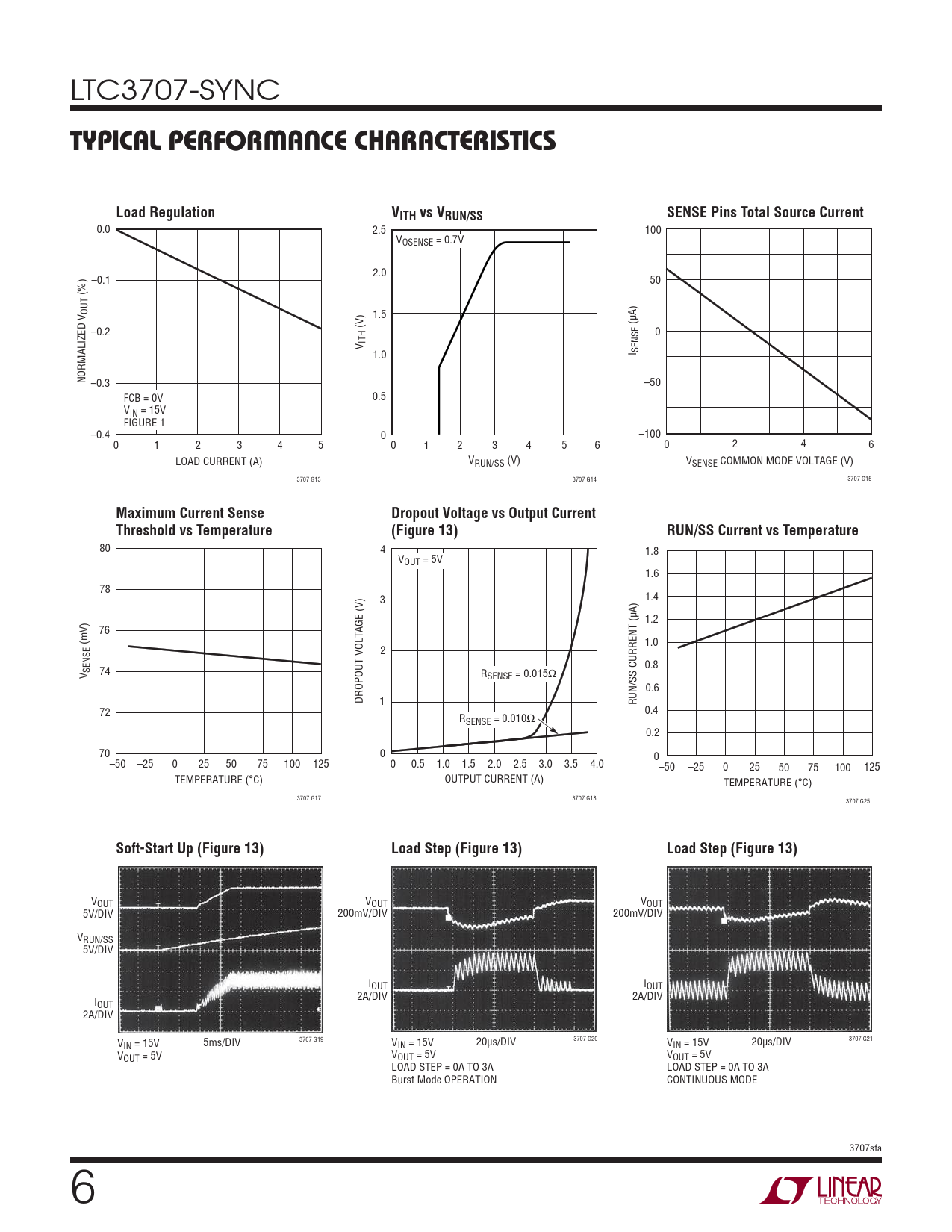

TYPICAL PERFORMANCE CHARACTERISTICS. Load Regulation. VITH vs VRUN/SS. SENSE Pins Total Source Current. Maximum Current Sense
LTC3707-SYNC
TYPICAL PERFORMANCE CHARACTERISTICS Load Regulation VITH vs VRUN/SS SENSE Pins Total Source Current
0.0 2.5 100 VOSENSE = 0.7V 2.0 –0.1 50 (%) OUT 1.5 (μA) –0.2 (V) 0 ITHV 1.0 I SENSE NORMALIZED V –0.3 –50 FCB = 0V 0.5 VIN = 15V FIGURE 1 –0.4 0 –100 0 1 2 3 4 5 0 1 2 3 4 5 6 0 2 4 6 LOAD CURRENT (A) VRUN/SS (V) VSENSE COMMON MODE VOLTAGE (V) 3707 G13 3707 G14 3707 G15
Maximum Current Sense Dropout Voltage vs Output Current Threshold vs Temperature (Figure 13) RUN/SS Current vs Temperature
80 4 1.8 VOUT = 5V 1.6 78 3 1.4 1.2 76 (mV) 1.0 2 0.8 SENSEV 74 RSENSE = 0.015Ω 0.6 DROPOUT VOLTAGE (V) 1 RUN/SS CURRENT (μA) 72 0.4 RSENSE = 0.010Ω 0.2 70 0 0 –50 –25 0 25 50 75 100 125 0 0.5 1.0 1.5 2.0 2.5 3.0 3.5 4.0 –50 –25 0 25 50 75 100 125 TEMPERATURE (°C) OUTPUT CURRENT (A) TEMPERATURE (°C) 3707 G17 3707 G18 3707 G25
Soft-Start Up (Figure 13) Load Step (Figure 13) Load Step (Figure 13)
VOUT VOUT VOUT 5V/DIV 200mV/DIV 200mV/DIV VRUN/SS 5V/DIV IOUT IOUT 2A/DIV 2A/DIV IOUT 2A/DIV V 20μs/DIV 3707 G20 20μs/DIV 3707 G21 IN = 15V 5ms/DIV 3707 G19 VIN = 15V VIN = 15V VOUT = 5V VOUT = 5V VOUT = 5V LOAD STEP = 0A TO 3A LOAD STEP = 0A TO 3A Burst Mode OPERATION CONTINUOUS MODE 3707sfa 6
