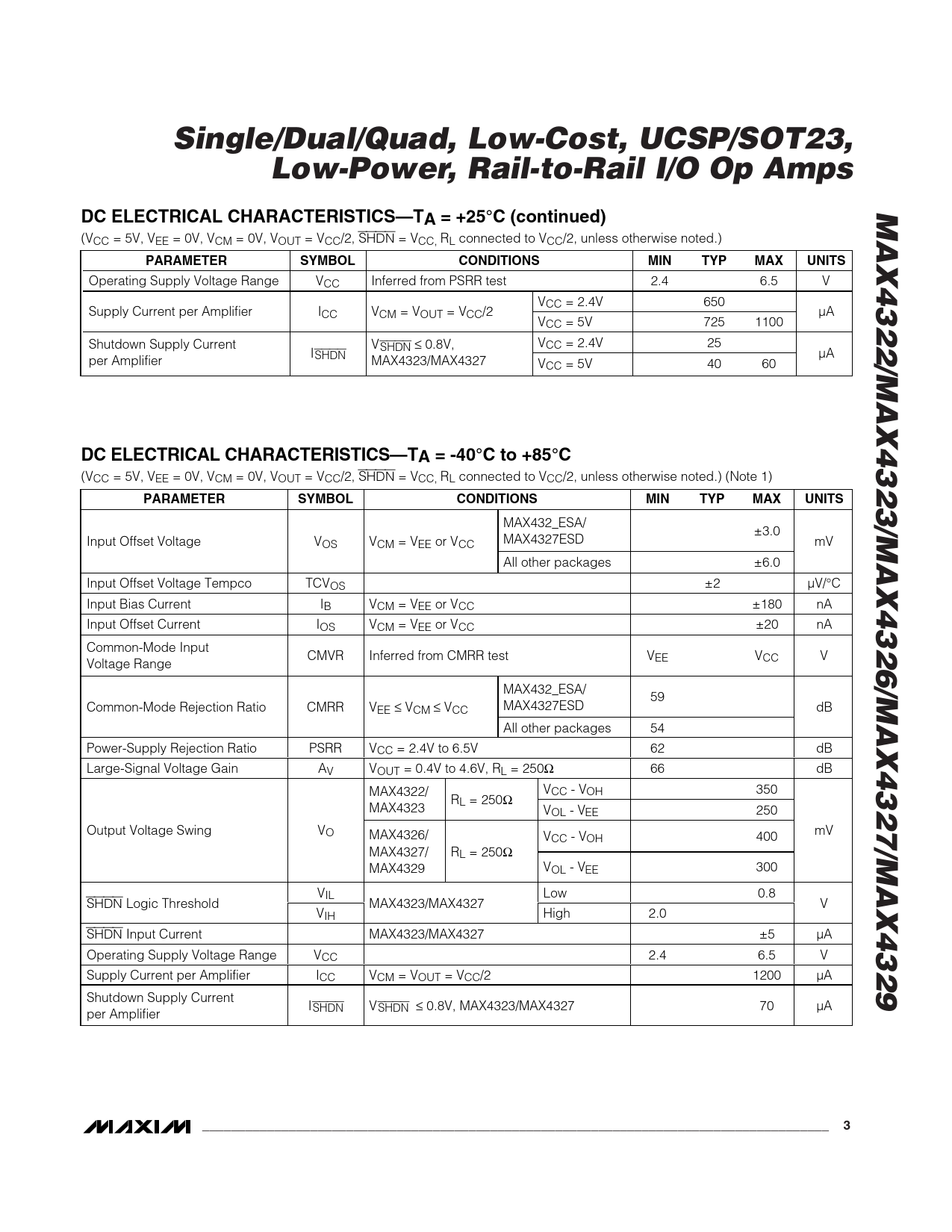

Single/Dual/Quad, Low-Cost, UCSP/SOT23,. Low-Power, Rail-to-Rail I/O Op Amps. MAX4322/MAX4323/MAX4326/MAX4327/MAX4329
Single/Dual/Quad, Low-Cost, UCSP/SOT23, Low-Power, Rail-to-Rail I/O Op Amps MAX4322/MAX4323/MAX4326/MAX4327/MAX4329
Single/Dual/Quad, Low-Cost, UCSP/SOT23, Low-Power, Rail-to-Rail I/O Op Amps MAX4322/MAX4323/MAX4326/MAX4327/MAX4329 DC ELECTRICAL CHARACTERISTICS—TA = +25°C (continued)
(VCC = 5V, VEE = 0V, VCM = 0V, VOUT = VCC/2, SHDN = VCC, RL connected to VCC/2, unless otherwise noted.)
PARAMETER SYMBOL CONDITIONS MIN TYP MAX UNITS
Operating Supply Voltage Range VCC Inferred from PSRR test 2.4 6.5 V VCC = 2.4V 650 Supply Current per Amplifier ICC VCM = VOUT = VCC/2 µA VCC = 5V 725 1100 Shutdown Supply Current V V SHDN ≤ 0.8V, CC = 2.4V 25 I µA per Amplifier SHDN MAX4323/MAX4327 VCC = 5V 40 60
DC ELECTRICAL CHARACTERISTICS—TA = -40°C to +85°C
(VCC = 5V, VEE = 0V, VCM = 0V, VOUT = VCC/2, SHDN = VCC, RL connected to VCC/2, unless otherwise noted.) (Note 1)
MAX432_ESA/ ±3.0 MAX4327ESD Input Offset Voltage VOS VCM = VEE or VCC mV All other packages ±6.0 Input Offset Voltage Tempco TCVOS ±2 µV/°C Input Bias Current IB VCM = VEE or VCC ±180 nA Input Offset Current IOS VCM = VEE or VCC ±20 nA Common-Mode Input CMVR Inferred from CMRR test VEE VCC V Voltage Range MAX432_ESA/ 59 Common-Mode Rejection Ratio CMRR V MAX4327ESD EE ≤ VCM ≤ VCC dB All other packages 54 Power-Supply Rejection Ratio PSRR VCC = 2.4V to 6.5V 62 dB Large-Signal Voltage Gain AV VOUT = 0.4V to 4.6V, RL = 250Ω 66 dB MAX4322/ VCC - VOH 350 RL = 250Ω MAX4323 VOL - VEE 250 Output Voltage Swing VO MAX4326/ V mV CC - VOH 400 MAX4327/ RL = 250Ω MAX4329 VOL - VEE 300 VIL Low 0.8 SHDN Logic Threshold MAX4323/MAX4327 V VIH High 2.0 SHDN Input Current MAX4323/MAX4327 ±5 µA Operating Supply Voltage Range VCC 2.4 6.5 V Supply Current per Amplifier ICC VCM = VOUT = VCC/2 1200 µA Shutdown Supply Current I SHDN V SHDN ≤ 0.8V, MAX4323/MAX4327 70 µA per Amplifier
