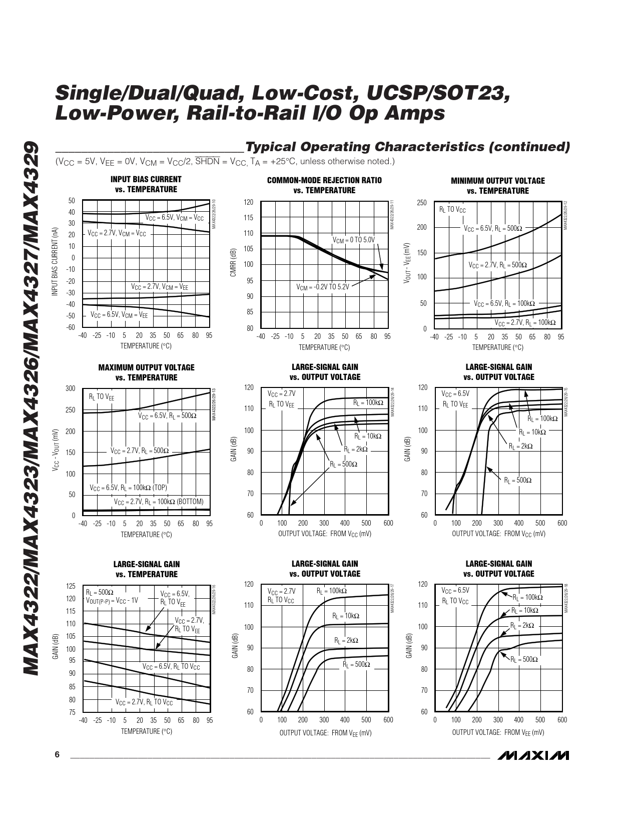

Single/Dual/Quad, Low-Cost, UCSP/SOT23, Low-Power, Rail-to-Rail I/O Op Amps _____________________________Typical Operating Characteristics (continued)
(VCC = 5V, VEE = 0V, VCM = VCC/2, SHDN = VCC, TA = +25°C, unless otherwise noted.)
INPUT BIAS CURRENT COMMON-MODE REJECTION RATIO MINIMUM OUTPUT VOLTAGE vs. TEMPERATURE vs. TEMPERATURE vs. TEMPERATURE
50 120 250 RL TO VCC 40 VCC = 6.5V, VCM = VCC 115 30 MAX4322/26/29-10 MAX4322/26/29-11 200 V MAX4322/26/29-12 CC = 6.5V, RL = 500Ω VCC = 2.7V, VCM = VCC 110 20 VCM = 0 TO 5.0V 10 105 (mV) 150 0 EE 100 - V VCC = 2.7V, RL = 500Ω -10 CMRR (dB) 100 -20 95 V OUT VCC = 2.7V, VCM = VEE VCM = -0.2V TO 5.2V INPUT BIAS CURRENT (nA) -30 90 -40 50 VCC = 6.5V, RL = 100kΩ 85 -50 VCC = 6.5V, VCM = VEE VCC = 2.7V, RL = 100kΩ -60 80 0 -40 -25 -10 5 20 35 50 65 80 95 -40 -25 -10 5 20 35 50 65 80 95 -40 -25 -10 5 20 35 50 65 80 95 TEMPERATURE (°C) TEMPERATURE (°C) TEMPERATURE (°C)
MAXIMUM OUTPUT VOLTAGE LARGE-SIGNAL GAIN LARGE-SIGNAL GAIN vs. TEMPERATURE vs. OUTPUT VOLTAGE vs. OUTPUT VOLTAGE
300 120 120 R VCC = 2.7V VCC = 6.5V L TO VEE R R L TO VEE L = 100kΩ RL TO VEE 250 110 110 VCC = 6.5V, RL = 500Ω MAX4322/26/29-14 MAX4322/26/29-15 MAX4322/26/29-13 RL = 100kΩ 200 100 100 R R L = 10kΩ (mV) L = 10kΩ R OUT R L = 2kΩ 150 VCC = 2.7V, RL = 500Ω 90 L = 2kΩ 90 - V GAIN (dB) GAIN (dB) R V CC L = 500Ω 100 80 80 RL = 500Ω VCC = 6.5V, RL = 100kΩ (TOP) 50 70 70 VCC = 2.7V, RL = 100kΩ (BOTTOM) 0 60 60 -40 -25 -10 5 20 35 50 65 80 95 0 100 200 300 400 500 600 0 100 200 300 400 500 600 TEMPERATURE (°C) OUTPUT VOLTAGE: FROM VCC (mV) OUTPUT VOLTAGE: FROM VCC (mV)
LARGE-SIGNAL GAIN LARGE-SIGNAL GAIN LARGE-SIGNAL GAIN vs. TEMPERATURE vs. OUTPUT VOLTAGE vs. OUTPUT VOLTAGE
125 120 120 R V L = 500Ω V V R CC = 6.5V CC = 6.5V, CC = 2.7V L = 100kΩ 120 V RL = 100kΩ OUT(P-P) = VCC - 1V R R L TO V L TO VCC R EE L TO VCC 110 110 115 R MAX4322/26/29-16 MAX4322/26/29-17 MAX4322/26/29-18 L = 10kΩ R V L = 10kΩ 110 CC = 2.7V, R 100 100 RL = 2kΩ L TO VEE 105 RL = 2kΩ 100 90 90 GAIN (dB) GAIN (dB) GAIN (dB) 95 RL = 500Ω
MAX4322/MAX4323/MAX4326/MAX4327/MAX4329
V R CC = 6.5V, RL TO VCC L = 500Ω 80 80 90 85 70 70 80 VCC = 2.7V, RL TO VCC 75 60 60 -40 -25 -10 5 20 35 50 65 80 95 0 100 200 300 400 500 600 0 100 200 300 400 500 600 TEMPERATURE (°C) OUTPUT VOLTAGE: FROM VEE (mV) OUTPUT VOLTAGE: FROM VEE (mV)
