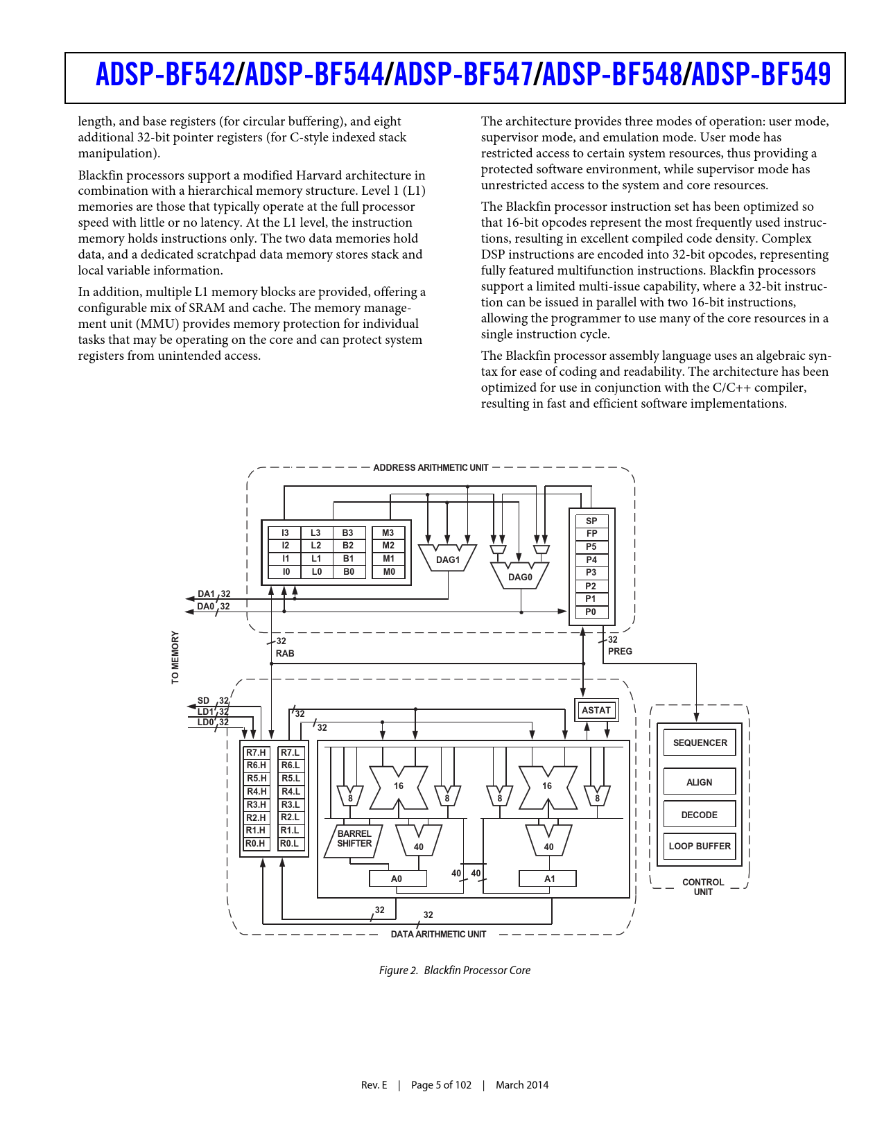

length, and base registers (for circular buffering), and eight The architecture provides three modes of operation: user mode, additional 32-bit pointer registers (for C-style indexed stack supervisor mode, and emulation mode. User mode has manipulation). restricted access to certain system resources, thus providing a Blackfin processors support a modified Harvard architecture in protected software environment, while supervisor mode has combination with a hierarchical memory structure. Level 1 (L1) unrestricted access to the system and core resources. memories are those that typically operate at the full processor The Blackfin processor instruction set has been optimized so speed with little or no latency. At the L1 level, the instruction that 16-bit opcodes represent the most frequently used instruc- memory holds instructions only. The two data memories hold tions, resulting in excellent compiled code density. Complex data, and a dedicated scratchpad data memory stores stack and DSP instructions are encoded into 32-bit opcodes, representing local variable information. fully featured multifunction instructions. Blackfin processors In addition, multiple L1 memory blocks are provided, offering a support a limited multi-issue capability, where a 32-bit instruc- configurable mix of SRAM and cache. The memory manage- tion can be issued in parallel with two 16-bit instructions, ment unit (MMU) provides memory protection for individual allowing the programmer to use many of the core resources in a tasks that may be operating on the core and can protect system single instruction cycle. registers from unintended access. The Blackfin processor assembly language uses an algebraic syn- tax for ease of coding and readability. The architecture has been optimized for use in conjunction with the C/C++ compiler, resulting in fast and efficient software implementations.
ADDRESS ARITHMETIC UNIT SP I3 L3 B3 M3 FP I2 L2 B2 M2 P5 I1 L1 B1 M1 DAG1 P4 I0 L0 B0 M0 DAG0 P3 P2 DA1 32 P1 DA0 32 P0 32 32 RAB PREG TO MEMORY SD 32 LD1 32 ASTAT 32 LD0 32 32 SEQUENCER R7.H R7.L R6.H R6.L R5.H R5.L ALIGN 16 16 R4.H R4.L 8 8 8 8 R3.H R3.L DECODE R2.H R2.L R1.H R1.L BARREL R0.H R0.L SHIFTER 40 40 LOOP BUFFER A0 40 40 A1 CONTROL UNIT 32 32 DATA ARITHMETIC UNIT
