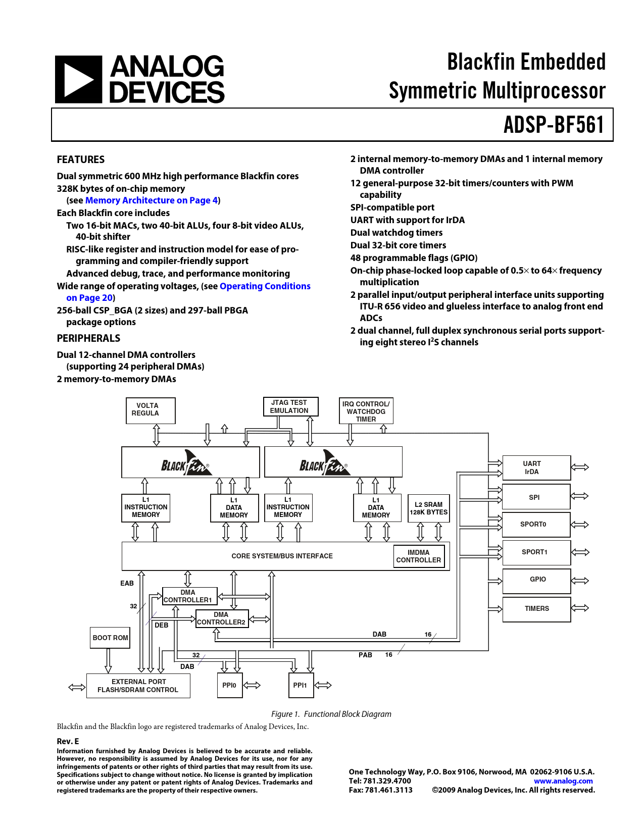

link to page 4 link to page 20 link to page 20 Blackfin Embedded Symmetric Multiprocessor ADSP-BF561
FEATURES 2 internal memory-to-memory DMAs and 1 internal memory DMA controller Dual symmetric 600 MHz high performance Blackfin cores 12 general-purpose 32-bit timers/counters with PWM 328K bytes of on-chip memory capability (see Memory Architecture on Page 4 ) SPI-compatible port Each Blackfin core includes UART with support for IrDA Two 16-bit MACs, two 40-bit ALUs, four 8-bit video ALUs, 40-bit shifter Dual watchdog timers RISC-like register and instruction model for ease of pro­ Dual 32-bit core timers gramming and compiler-friendly support 48 programmable flags (GPIO) Advanced debug, trace, and performance monitoring On-chip phase-locked loop capable of 0.5
to 64
frequency Wide range of operating voltages, (see Operating Conditions multiplication on Page 20) 2 parallel input/output peripheral interface units supporting 256-ball CSP_BGA (2 sizes) and 297-ball PBGA ITU-R 656 video and glueless interface to analog front end package options ADCs 2 dual channel, full duplex synchronous serial ports support­ PERIPHERALS ing eight stereo I2S channels Dual 12-channel DMA controllers (supporting 24 peripheral DMAs) 2 memory-to-memory DMAs JTAG TEST VOLTA IRQ CONTROL/ REGULA EMULATION WATCHDOG TIMER
B B
UART IrDA SPI L1 L1 L1 L1 INSTRUCTION L2 SRAM DATA INSTRUCTION DATA MEMORY 128K BYTES MEMORY MEMORY MEMORY SPORT0 IMDMA SPORT1 CORE SYSTEM/BUS INTERFACE CONTROLLER GPIO EAB DMA CONTROLLER1 32 TIMERS DMA DEB CONTROLLER2 DAB 16 BOOT ROM 32 PAB 16 DAB EXTERNAL PORT PPI0 PPI1 FLASH/SDRAM CONTROL
Figure 1. Functional Block Diagram Blackfin and the Blackfin logo are registered trademarks of Analog Devices, Inc.
