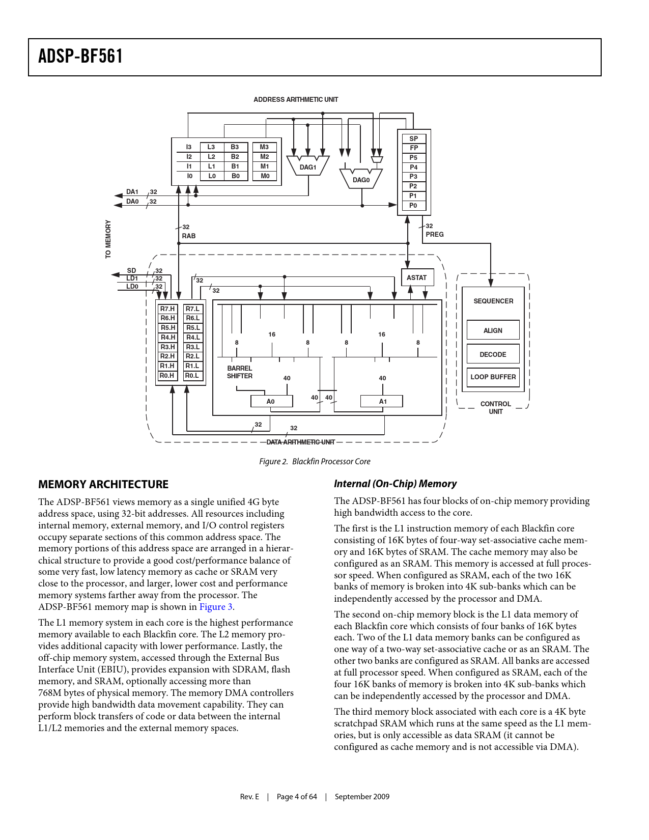

ADDRESS ARITHMETIC UNIT SP I3 L3 B3 M3 FP I2 L2 B2 M2 P5 I1 L1 B1 M1 DAG1 P4 I0 L0 B0 M0 P3 DAG0 P2 DA1 32 P1 DA0 32 P0 Y 32 32 PREG RAB O MEMOR T SD 32 LD1 32 ASTAT 32 LD0 32 32 SEQUENCER R7.H R7.L R6.H R6.L R5.H R5.L ALIGN 16 16 R4.H R4.L 8 8 8 8 R3.H R3.L DECODE R2.H R2.L R1.H R1.L BARREL R0.H R0.L SHIFTER 40 40 LOOP BUFFER 40 40 A0 A1 CONTROL UNIT 32 32 DATA ARITHMETIC UNIT
Figure 2. Blackfin Processor Core
