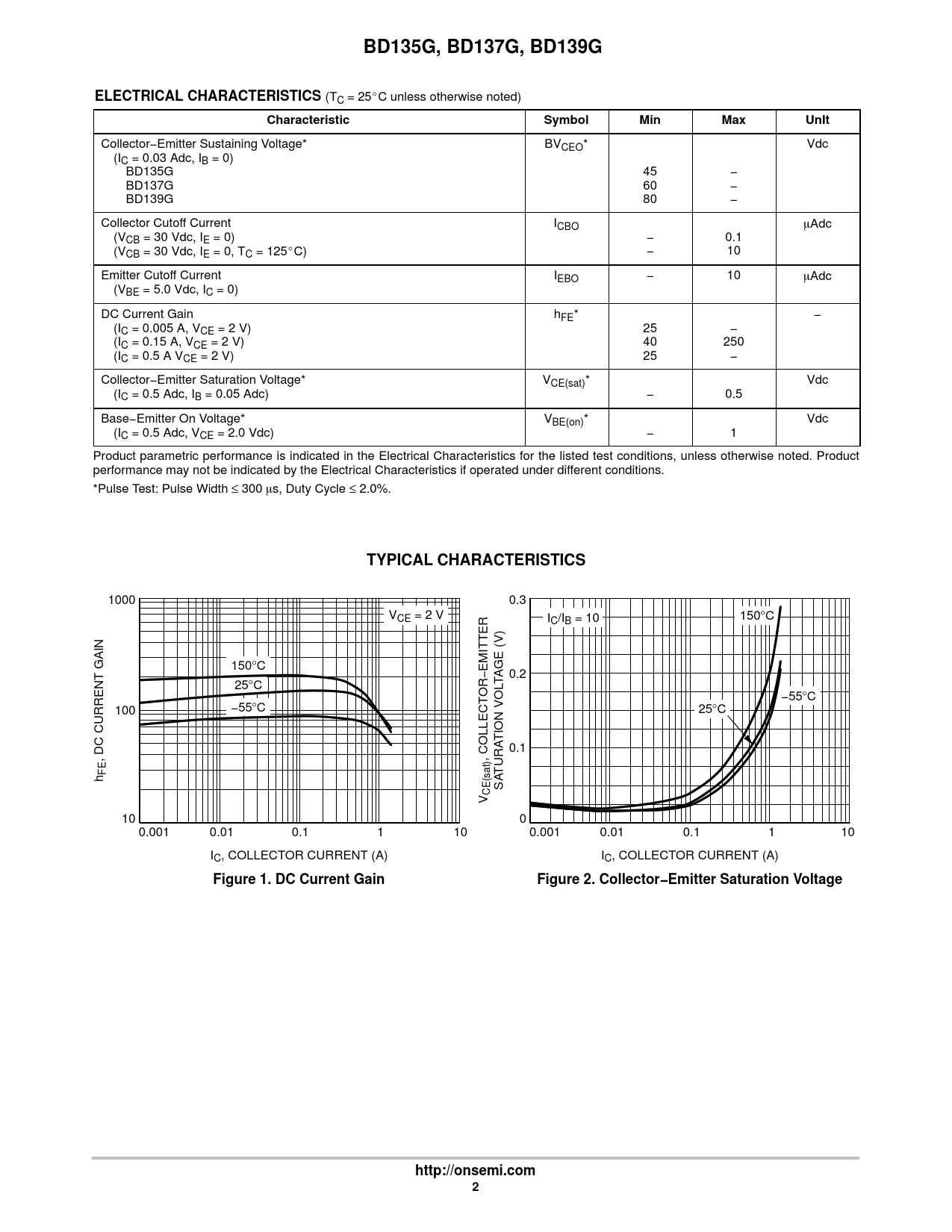

BD135G, BD137G, BD139G. ELECTRICAL CHARACTERISTICS. Characteristic. Symbol. Min. Max. UnIt. TYPICAL CHARACTERISTICS
BD135G, BD137G, BD139G ELECTRICAL CHARACTERISTICS Characteristic Symbol Min Max UnIt TYPICAL CHARACTERISTICS
(TC = 25_C unless otherwise noted)
Collector−Emitter Sustaining Voltage* BVCEO* Vdc (IC = 0.03 Adc, IB = 0) BD135G 45 − BD137G 60 − BD139G 80 − Collector Cutoff Current ICBO mAdc (VCB = 30 Vdc, IE = 0) − 0.1 (VCB = 30 Vdc, IE = 0, TC = 125_C) − 10 Emitter Cutoff Current IEBO − 10 mAdc (VBE = 5.0 Vdc, IC = 0) DC Current Gain hFE* − (IC = 0.005 A, VCE = 2 V) 25 − (IC = 0.15 A, VCE = 2 V) 40 250 (IC = 0.5 A VCE = 2 V) 25 − Collector−Emitter Saturation Voltage* VCE(sat)* Vdc (IC = 0.5 Adc, IB = 0.05 Adc) − 0.5 Base−Emitter On Voltage* VBE(on)* Vdc (IC = 0.5 Adc, VCE = 2.0 Vdc) − 1 Product parametric performance is indicated in the Electrical Characteristics for the listed test conditions, unless otherwise noted. Product performance may not be indicated by the Electrical Characteristics if operated under different conditions. *Pulse Test: Pulse Width ≤ 300 ms, Duty Cycle ≤ 2.0%.
1000 0.3 VCE = 2 V IC/IB = 10 150°C 150°C AGE (V) 0.2 T 25°C OR−EMITTER −55°C 100 −55°C 25°C TION VOL 0.1 , DC CURRENT GAIN , COLLECT FE TURA h SA CE(sat)V 10 0 0.001 0.01 0.1 1 10 0.001 0.01 0.1 1 10 IC, COLLECTOR CURRENT (A) IC, COLLECTOR CURRENT (A)
Figure 1. DC Current Gain Figure 2. Collector−Emitter Saturation Voltage http://onsemi.com 2
