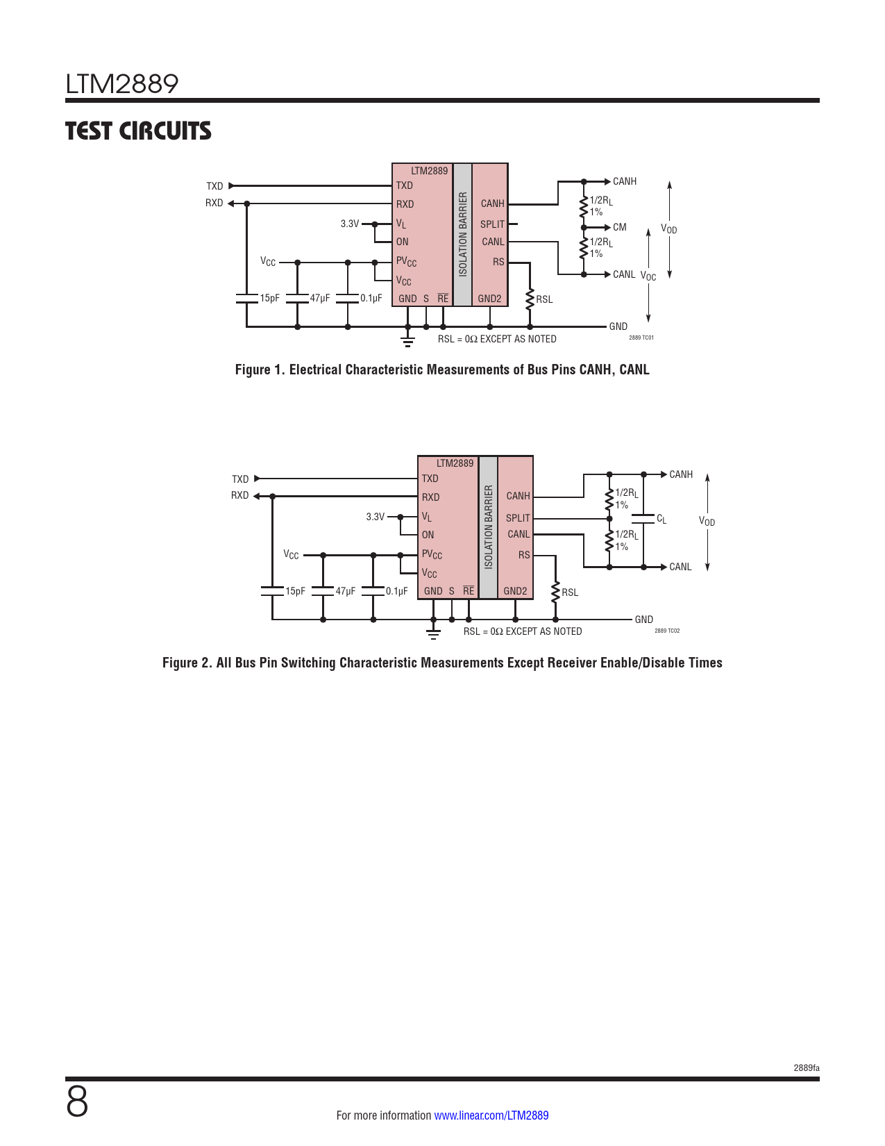

Pages / Page30 / 8 — TEST CIRCUITS. Figure 1. Electrical Characteristic Measurements of Bus …
TEST CIRCUITS. Figure 1. Electrical Characteristic Measurements of Bus Pins CANH, CANL
TEST CIRCUITS Figure 1 Electrical Characteristic Measurements of Bus Pins CANH, CANL
LTM2889
TEST CIRCUITS
LTM2889 TXD TXD CANH RXD RXD CANH 1/2RL 1% 3.3V VL SPLIT CM VOD ON CANL 1/2RL TION BARRIER 1% VCC PVCC RS V ISOLA CANL V CC OC 15pF 47µF 0.1µF GND S RE GND2 RSL GND 2889 TC01 RSL = 0Ω EXCEPT AS NOTED
LTM2889 TXD TXD CANH RXD RXD CANH 1/2RL 1% 3.3V VL SPLIT CL VOD ON CANL 1/2RL TION BARRIER 1% VCC PVCC RS V ISOLA CANL CC 15pF 47µF 0.1µF GND S RE GND2 RSL GND 2889 TC02 RSL = 0Ω EXCEPT AS NOTED
Figure 2. All Bus Pin Switching Characteristic Measurements Except Receiver Enable/Disable Times
