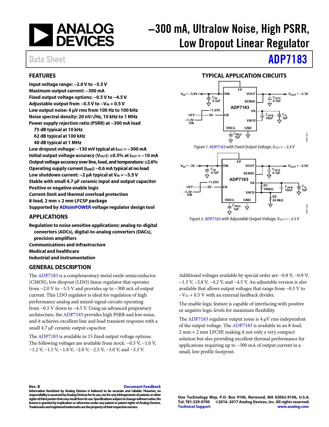

−300 mA, Ultralow Noise, High PSRR,. Low Dropout Linear Regulator. Data Sheet. ADP7183. FEATURES. TYPICAL APPLICATION CIRCUITS
Datasheet ADP7183 Analog Devices, Revision: B
−300 mA, Ultralow Noise, High PSRR, Low Dropout Linear Regulator Data Sheet ADP7183 FEATURES TYPICAL APPLICATION CIRCUITS Input voltage range: −2.0 V to −5.5 V Maximum output current: −300 mA EP V VIN VOUT V IN = –3.8V OUT = –3.3V Fixed output voltage options: −0.5 V to −4.5 V CIN COUT 4.7µF SENSE 4.7µF Adjustable output from −0.5 V to −VIN + 0.5 V ADP7183 Low output noise: 4 μV rms from 100 Hz to 100 kHz +1.25V VA OFF 0V EN C C Noise spectral density: 20 nV/√Hz, 10 kHz to 1 MHz AFB A 10nF 1µF –1.3V VAFB Power supply rejection ratio (PSRR) at −300 mA load ON 75 dB typical at 10 kHz VREG GND C
1
62 dB typical at 100 kHz REG 1µF
00 7-
40 dB typical at 1 MHz
1289
Low dropout voltage: −130 mV typical at I
Figure 1. ADP7183 with Fixed Output Voltage, VOUT = −3.3 V
OUT = −300 mA Initial output voltage accuracy (VOUT): ±0.5% at IOUT = −10 mA Output voltage accuracy over line, load, and temperature: ±2.6% EP V VIN VOUT V Operating supply current (I IN = –3V OUT = –2.5V GND): −0.6 mA typical at no load CIN COUT 4.7µF SENSE 4.7µF Low shutdown current: −2 μA typical at VIN = −5.5 V ADP7183 Stable with small 4.7 μF ceramic input and output capacitor +1.25V VA R1 Positive or negative enable logic OFF 0V EN C C AFB A 100kΩ 10nF 1µF –1.3V VAFB Current-limit and thermal overload protection ON R2 8-lead, 2 mm × 2 mm LFCSP package VREG GND 24.9kΩ C Supported by ADIsimPOWER v oltage regulator design tool REG 1µF
002 7- 1289
APPLICATIONS
Figure 2. ADP7183 with Adjustable Output Voltage, VOUT = −2.5 V
Regulation to noise sensitive applications: analog-to-digital converters (ADCs), digital-to-analog converters (DACs), precision amplifiers Communications and infrastructure Medical and healthcare Industrial and instrumentation GENERAL DESCRIPTION
The ADP7183 is a complementary metal oxide semiconductor Additional voltages available by special order are −0.8 V, −0.9 V, (CMOS), low dropout (LDO) linear regulator that operates −1.3 V, −2.8 V, −4.2 V, and −4.5 V. An adjustable version is also from −2.0 V to −5.5 V and provides up to −300 mA of output available that allows output voltages that range from −0.5 V to current. This LDO regulator is ideal for regulation of high −VIN + 0.5 V with an external feedback divider. performance analog and mixed-signal circuits operating The enable logic feature is capable of interfacing with positive from −0.5 V down to −4.5 V. Using an advanced proprietary or negative logic levels for maximum flexibility. architecture, the ADP7183 provides high PSRR and low noise, and it achieves excellent line and load transient response with a The ADP7183 regulator output noise is 4 μV rms independent small 4.7 μF ceramic output capacitor. of the output voltage. The ADP7183 is available in an 8-lead, 2 mm × 2 mm LFCSP, making it not only a very compact The ADP7183 is available in 15 fixed output voltage options. solution but also providing excellent thermal performance for The following voltages are available from stock: −0.5 V, −1.0 V, applications requiring up to −300 mA of output current in a −1.2 V, −1.5 V, −1.8 V, −2.0 V, −2.5 V, −3.0 V, and −3.3 V. small, low profile footprint.
