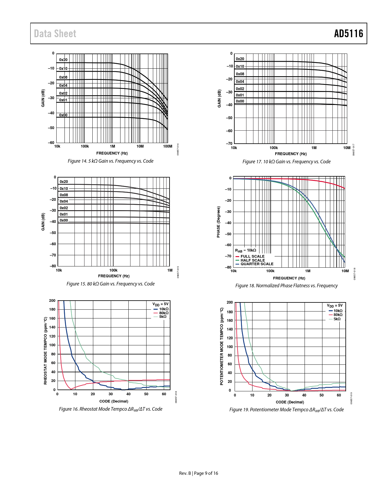

09657- Figure 14. 5 kΩ Gain vs. Frequency vs. Code Figure 17. 10 kΩ Gain vs. Frequency vs. Code

09657- Figure 15. 80 kΩ Gain vs. Frequency vs. Code Figure 18. Normalized Phase Flatness vs. Frequency

09657- Figure 16. Rheostat Mode Tempco ΔRWB/ΔT vs. Code Figure 19. Potentiometer Mode Tempco ΔRWB/ΔT vs. Code Rev. B | Page 9 of 16 Document Outline Features Applications Functional Block Diagram General Description Revision History Specifications Electrical Characteristics Interface Timing Specifications Timing Diagrams Absolute Maximum Ratings Thermal Resistance ESD Caution Pin Configuration and Function Descriptions Typical Performance Characteristics Test Circuits Theory of Operation RDAC Register Manual Increment Auto Scan Increment Low Wiper Resistance Feature EEPROM Automatic Save Enable Auto Save Manual Store End Scale Resistance Indicator RDAC Architecture Top Scale/Bottom Scale Architecture Programming the Variable Resistor Rheostat Operation—±8% Resistor Tolerance Programming the Potentiometer Divider Voltage Output Operation Terminal Voltage Operating Range Power-Up Sequence Layout and Power Supply Biasing Outline Dimensions Ordering Guide
