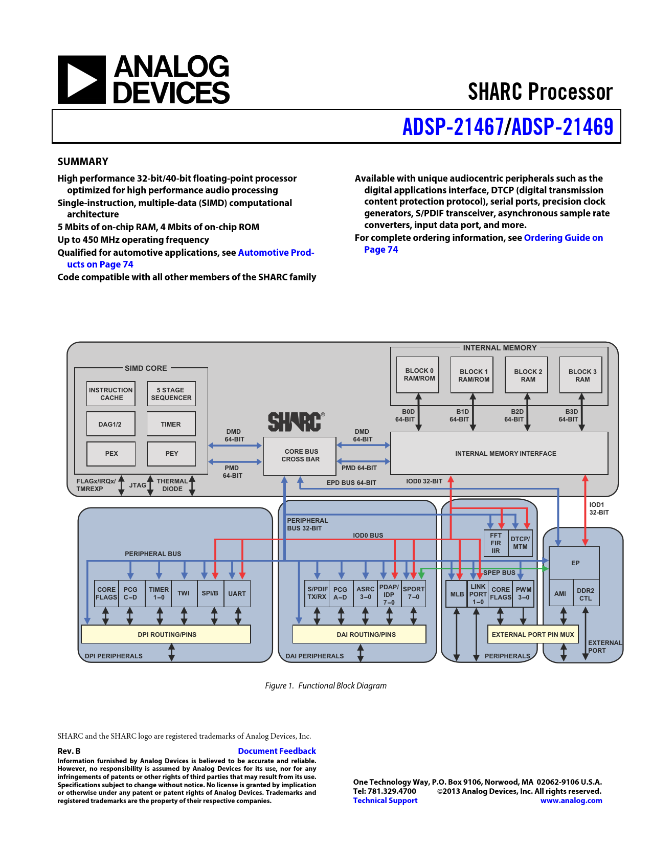

SHARC Processor. ADSP-21467. /ADSP-21469. SUMMARY. High performance 32-bit/40-bit floating-point processor
link to page 74 link to page 74 link to page 74 link to page 74
SHARC Processor ADSP-21467 /ADSP-21469 SUMMARY High performance 32-bit/40-bit floating-point processor Available with unique audiocentric peripherals such as the optimized for high performance audio processing digital applications interface, DTCP (digital transmission Single-instruction, multiple-data (SIMD) computational content protection protocol), serial ports, precision clock architecture generators, S/PDIF transceiver, asynchronous sample rate 5 Mbits of on-chip RAM, 4 Mbits of on-chip ROM converters, input data port, and more. Up to 450 MHz operating frequency For complete ordering information, see Ordering Guide on Qualified for automotive applications, see Automotive Prod- Page 74 ucts on Page 74 Code compatible with all other members of the SHARC family INTERNAL MEMORY SIMD CORE BLOCK 0 BLOCK 1 BLOCK 2 BLOCK 3 RAM/ROM RAM/ROM RAM RAM INSTRUCTION 5 STAGE CACHE SEQUENCER B0D B1D B2D B3D 64-BIT 64-BIT 64-BIT 64-BIT
S
DAG1/2 TIMER DMD DMD 64-BIT 64-BIT PEX PEY CORE BUS INTERNAL MEMORY INTERFACE CROSS BAR PMD PMD 64-BIT 64-BIT FLAGx/IRQx/ THERMAL IOD0 32-BIT EPD BUS 64-BIT JTAG TMREXP DIODE IOD1 32-BIT PERIPHERAL BUS 32-BIT IOD0 BUS FFT DTCP/ FIR MTM PERIPHERAL BUS IIR EP SPEP BUS LINK CORE PCG TIMER S/PDIF PCG ASRC PDAP/ SPORT CORE PWM TWI SPI/B DDR2 UART IDP MLB PORT AMI FLAGS C-D 1-0 TX/RX A-D 3-0 7-0 FLAGS 3-0 CTL 7-0 1-0 DPI ROUTING/PINS DAI ROUTING/PINS EXTERNAL PORT PIN MUX EXTERNAL PORT DPI PERIPHERALS DAI PERIPHERALS PERIPHERALS
Figure 1. Functional Block Diagram SHARC and the SHARC logo are registered trademarks of Analog Devices, Inc.
