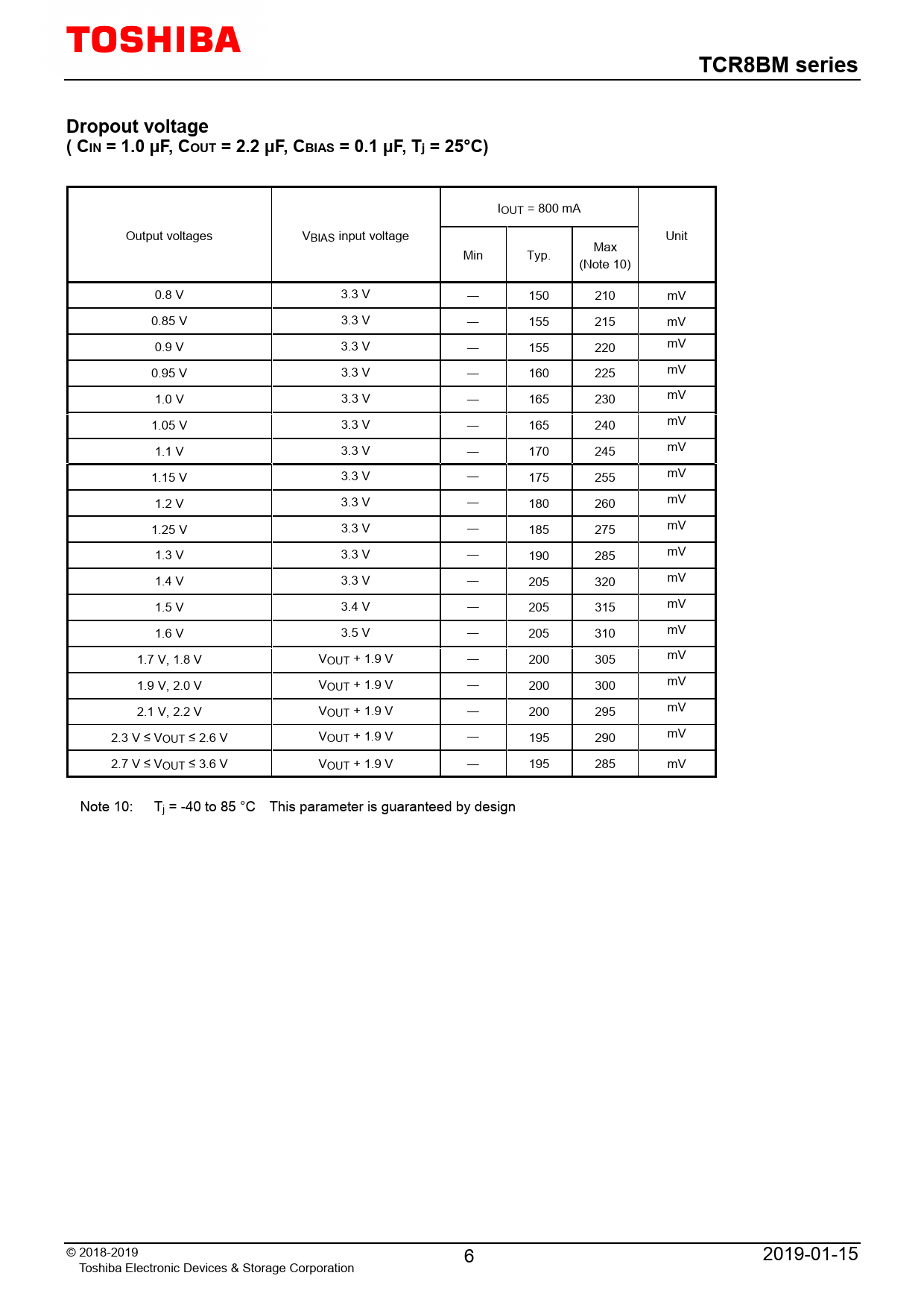

TCR8BM series. Dropout voltage. ( CIN = 1.0 μF, COUT = 2.2 μF, CBIAS = 0.1 μF, Tj = 25°C)
TCR8BM series Dropout voltage ( CIN = 1.0 μF, COUT = 2.2 μF, CBIAS = 0.1 μF, Tj = 25°C)
IOUT = 800 mA Output voltages VBIAS input voltage Unit Min Typ. Max (Note 10) 0.8 V 3.3 V ― 150 210 mV 0.85 V 3.3 V ― 155 215 mV 0.9 V 3.3 V ― 155 220 mV 0.95 V 3.3 V ― 160 225 mV 1.0 V 3.3 V ― 165 230 mV 1.05 V 3.3 V ― 165 240 mV 1.1 V 3.3 V ― 170 245 mV 1.15 V 3.3 V ― 175 255 mV 1.2 V 3.3 V ― 180 260 mV 1.25 V 3.3 V ― 185 275 mV 1.3 V 3.3 V ― 190 285 mV 1.4 V 3.3 V ― 205 320 mV 1.5 V 3.4 V ― 205 315 mV 1.6 V 3.5 V ― 205 310 mV 1.7 V, 1.8 V VOUT + 1.9 V ― 200 305 mV 1.9 V, 2.0 V VOUT + 1.9 V ― 200 300 mV 2.1 V, 2.2 V VOUT + 1.9 V ― 200 295 mV 2.3 V ≤ VOUT ≤ 2.6 V VOUT + 1.9 V ― 195 290 mV 2.7 V ≤ VOUT ≤ 3.6 V VOUT + 1.9 V ― 195 285 mV Note 10: Tj = -40 to 85 °C This parameter is guaranteed by design © 2018-2019 6 2019-01-15 Toshiba Electronic Devices & Storage Corporation
