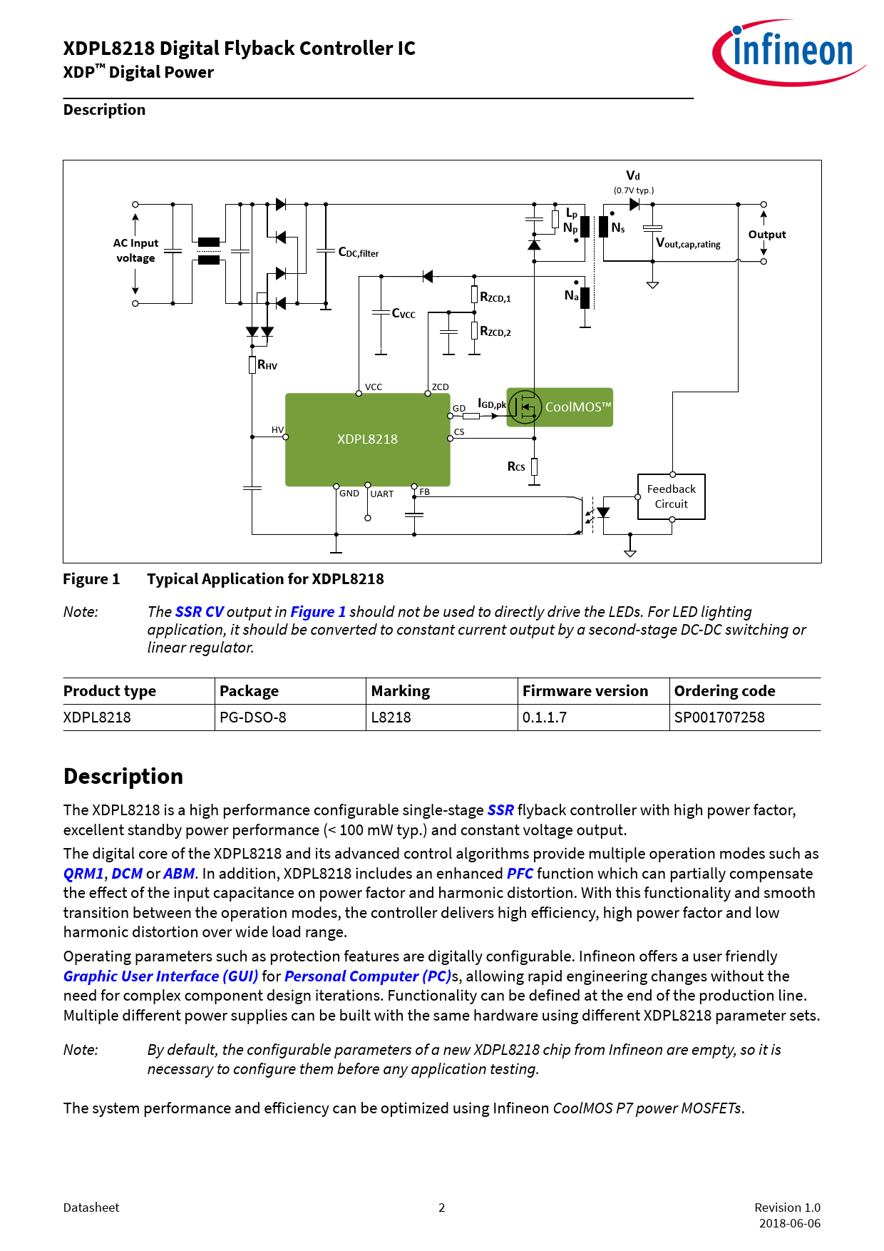

DescriptionHigh power factor constant voltage flyback IC with secondary side regulation for cost-effective LED driver
Pages / Page45 / 2 — XDPL8218 Digital Flyback Controller IC. XDP™ Digital Power. Description. …
Revision01_00
File Format / SizePDF / 651 Kb

Figure 1 Typical Application for XDPL8218
Note: The
SSR CV
output in
Figure 1
should not be used to directly drive the LEDs. For LED lighting application, it should be converted to constant current output by a second-stage DC-DC switching or linear regulator.
Product type Package Marking Firmware version Ordering code
XDPL8218 PG-DSO-8 L8218 0.1.1.7 SP001707258
The XDPL8218 is a high performance configurable single-stage
SSR
flyback controller with high power factor, excellent standby power performance (< 100 mW typ.) and constant voltage output. The digital core of the XDPL8218 and its advanced control algorithms provide multiple operation modes such as
QRM1
DCM
or
ABM
. In addition, XDPL8218 includes an enhanced
PFC
function which can partially compensate the effect of the input capacitance on power factor and harmonic distortion. With this functionality and smooth transition between the operation modes, the controller delivers high efficiency, high power factor and low harmonic distortion over wide load range. Operating parameters such as protection features are digitally configurable. Infineon offers a user friendly
Graphic User Interface (GUI)
for
Personal Computer (PC)
s, allowing rapid engineering changes without the need for complex component design iterations. Functionality can be defined at the end of the production line. Multiple different power supplies can be built with the same hardware using different XDPL8218 parameter sets. Note: By default, the configurable parameters of a new XDPL8218 chip from Infineon are empty, so it is necessary to configure them before any application testing. The system performance and efficiency can be optimized using Infineon CoolMOS P7 power MOSFETs. Datasheet 2 Revision 1.0 2018-06-06 Document Outline Features Product validation Potential applications Description Table of contents 1 Pin configuration 2 Functional block diagram 3 Functional description 3.1 Regulated mode 3.2 Configurable gate voltage rising slope at GD pin 3.3 Startup 3.4 Line synchronization 3.5 Input voltage and output voltage estimation 3.5.1 Output voltage estimation 3.5.2 Input voltage estimation 3.6 Power factor correction 3.7 Protection features 3.7.1 Primary MOSFET overcurrent protection 3.7.2 Output undervoltage protection 3.7.3 Output overvoltage protection 3.7.4 Transformer demagnetization time shortage protection 3.7.5 Minimum input voltage startup check and input undervoltage protection 3.7.6 Maximum input voltage startup check and input overvoltage protection 3.7.7 VCC undervoltage lockout 3.7.8 VCC undervoltage protection 3.7.9 VCC overvoltage protection 3.7.10 IC overtemperature protection 3.7.11 Other protections 3.7.12 Protection reactions 3.8 Debug mode 4 List of Parameters 5 Electrical Characteristics and Parameters 5.1 Package Characteristics 5.2 Absolute Maximum Ratings 5.3 Operating Conditions 5.4 DC Electrical Characteristics 6 Package Dimensions 7 References Revision History Glossary ABM CCM CRC CV DCM ECG EMI GUI IC LED OCP1 PC PF PFC QRM1 SSR THD UART USB UVLO Disclaimer
