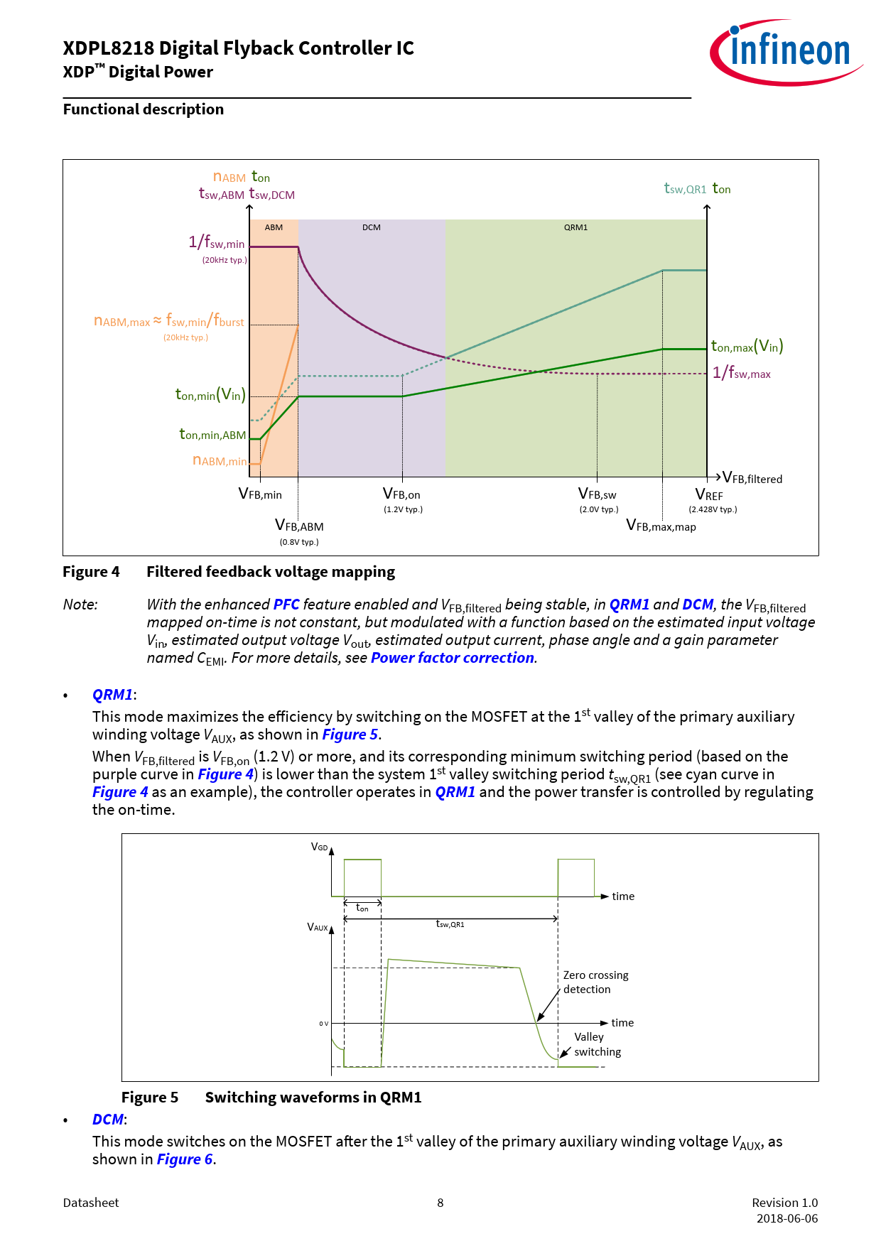

XDPL8218 Digital Flyback Controller IC. XDP™ Digital Power. Functional description. Figure 4. Filtered feedback voltage mapping
XDPL8218 Digital Flyback Controller IC XDP™ Digital Power Functional description Figure 4 Filtered feedback voltage mapping
link to page 43 link to page 43 link to page 42 link to page 17 link to page 43 link to page 8 link to page 8 link to page 8 link to page 43 link to page 42 link to page 9
nABM ton t t sw,ABM tsw,DCM sw,QR1 ton ABM DCM QRM1 1/fsw,min (20kHz typ.) nABM,max ≈ fsw,min/fburst (20kHz typ.) ton,max(Vin) 1/fsw,max ton,min(Vin) ton,min,ABM nABM,min VFB,filtered VFB,min VFB,on VFB,sw VREF (1.2V typ.) (2.0V typ.) (2.428V typ.) VFB,ABM VFB,max,map (0.8V typ.)
Note: With the enhanced
PFC
feature enabled and VFB,filtered being stable, in
QRM1
and
DCM
, the VFB,filtered mapped on-time is not constant, but modulated with a function based on the estimated input voltage Vin, estimated output voltage Vout, estimated output current, phase angle and a gain parameter named CEMI. For more details, see
Power factor correction
QRM1
: This mode maximizes the efficiency by switching on the MOSFET at the 1st valley of the primary auxiliary winding voltage VAUX, as shown in
Figure 5
. When VFB,filtered is VFB,on (1.2 V) or more, and its corresponding minimum switching period (based on the purple curve in
Figure 4
) is lower than the system 1st valley switching period tsw,QR1 (see cyan curve in
Figure 4
as an example), the controller operates in
QRM1
and the power transfer is controlled by regulating the on-time. VGD time ton V t AUX sw,QR1 Zero crossing detection 0 V time Valley switching
Figure 5 Switching waveforms in QRM1
