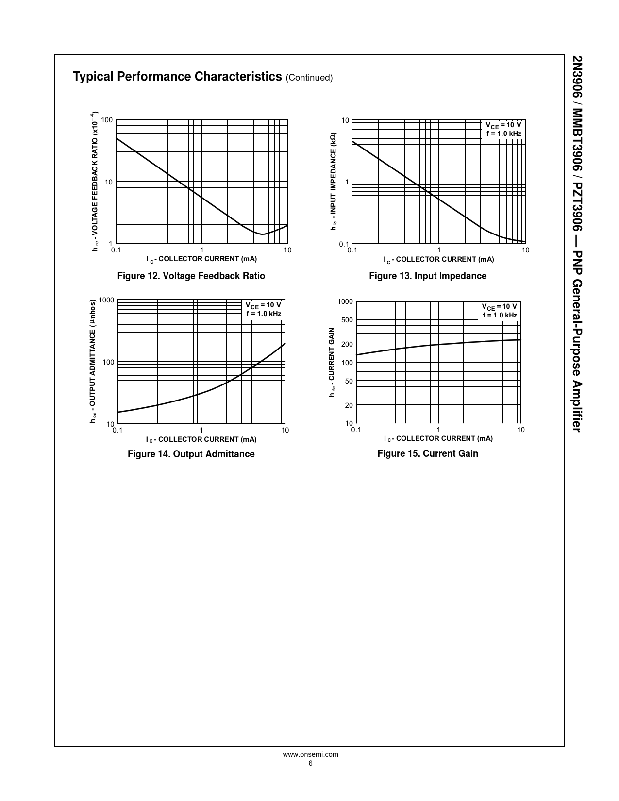

2 N 3906 / MMBT3906 / PZT. Typical Performance Characteristics. 4 ). V = 10 V. f = 1.0 kHz. IO T. R K C. ANC. A B. PED. T I. 3906 —. - ie. - V re
2 N 3906 / MMBT3906 / PZT Typical Performance Characteristics
(Continued)
4 ) _
100
0
10
V = 10 V x1 CE ( ) f = 1.0 kHz
Ω
IO T (k A E R K C ANC A B
10
D PED
1
E M E T I F 3906 — E PU G N A I LT - ie O h - V re
1 0.1
h P
0.1 1 10 0.1 1 10
N I - COLLECTOR CURRENT (mA) C I - COLLECTOR CURRENT (mA) C P Gen Figure 12. Voltage Feedback Ratio Figure 13. Input Impedance )
1000
era
1000
os V = 10 V CE V = 10 V h CE f = 1.0 kHz m f = 1.0 kHz l-Purpose
μ 500
( E IN C A N A
200
T T G IT N E M
100
R
100
D R A U Amplifier T
50
- C fe TPU U h
20
- O oe h
10 10 0.1 1 10 0.1 1 10
I - C COLLECTOR CURRENT (mA) I - C COLLECTOR CURRENT (mA) Figure 14. Output Admittance Figure 15. Current Gain
