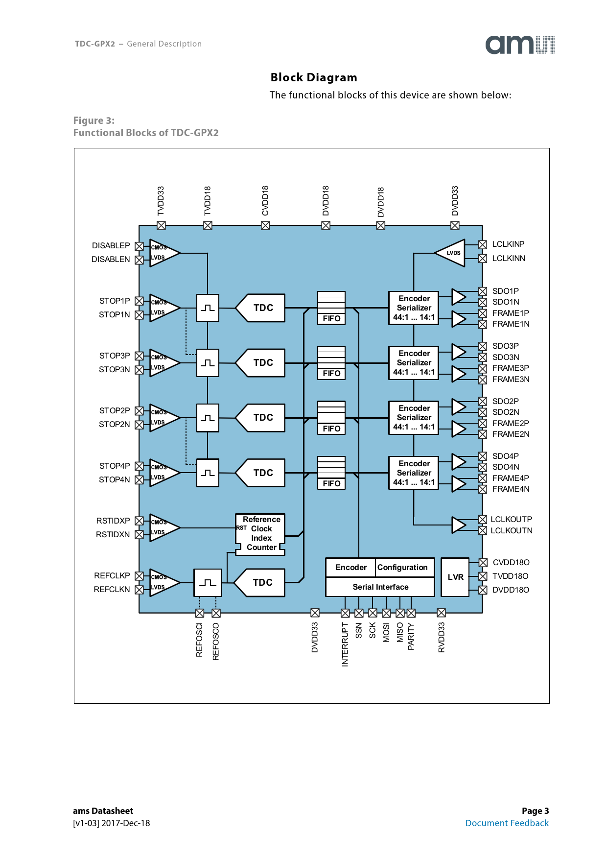

TDC-GPX2 −. Block Diagram. Figure 3: Functional Blocks of TDC-GPX2. Encoder. TDC. Serializer. 44:1 ... 14:1. FIFO. Reference. Clock. Index
TDC-GPX2 − Block Diagram Figure 3: Functional Blocks of TDC-GPX2 Encoder TDC Serializer 44:1 .. 14:1 FIFO Reference Clock Index
TDC-GPX2 −
General Description
Block Diagram
The functional blocks of this device are shown below:
3 8 8 8 3 8 3 1 1 1 3 1 D D D D DD DD DD DD TV TV CV DV DV DV DISABLEP LCLKINP DISABLEN LCLKINN SDO1P STOP1P
Encoder
SDO1N
TDC Serializer
STOP1N FRAME1P
44:1 ... 14:1 FIFO
FRAME1N SDO3P
Encoder
STOP3P SDO3N
TDC Serializer
STOP3N FRAME3P
44:1 ... 14:1 FIFO
FRAME3N SDO2P
Encoder
STOP2P SDO2N
TDC Serializer
STOP2N FRAME2P
44:1 ... 14:1 FIFO
FRAME2N SDO4P
Encoder
STOP4P SDO4N
TDC Serializer
STOP4N FRAME4P
44:1 ... 14:1 FIFO
FRAME4N
Reference
RSTIDXP LCLKOUTP
Clock
LCLKOUTN RSTIDXN
Index Counter
CVDD18O
Encoder Configuration
REFCLKP
LVR
TVDD18O
TDC Serial Interface
REFCLKN DVDD18O I 3 T O K I O Y C 3 C 3 P S S 3 S IT S SSN SC O DD MO MI DD F O F RRU PAR DV E RV RE T RE IN
