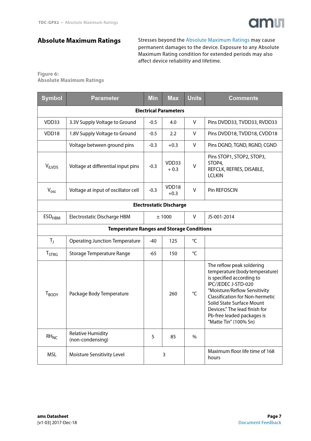

Absolute Maximum Ratings Stresses beyond the Absolute Maximum Ratings may cause
permanent damages to the device. Exposure to any Absolute Maximum Rating condition for extended periods may also affect device reliability and lifetime.
Figure 6: Absolute Maximum Ratings Symbol Parameter Min Max Units Comments Electrical Parameters
VDD33 3.3V Supply Voltage to Ground -0.5 4.0 V Pins DVDD33, TVDD33, RVDD33 VDD18 1.8V Supply Voltage to Ground -0.5 2.2 V Pins DVDD18, TVDD18, CVDD18 Voltage between ground pins -0.3 +0.3 V Pins DGND, TGND, RGND, CGND Pins STOP1, STOP2, STOP3, VDD33 STOP4, ViLVDS Voltage at differential input pins -0.3 V + 0.3 REFCLK, REFRES, DISABLE, LCLKIN VDD18 Vosc Voltage at input of oscillator cell -0.3 V Pin REFOSCIN +0.3
Electrostatic Discharge
ESDHBM Electrostatic Discharge HBM ± 1000 V JS-001-2014
Temperature Ranges and Storage Conditions
TJ Operating Junction Temperature -40 125 °C TSTRG Storage Temperature Range -65 150 °C The reflow peak soldering temperature (body temperature) is specified according to IPC/JEDEC J-STD-020 “Moisture/Reflow Sensitivity TBODY Package Body Temperature 260 °C Classification for Non-hermetic Solid State Surface Mount Devices.” The lead finish for Pb-free leaded packages is “Matte Tin” (100% Sn) Relative Humidity RHNC 5 85 % (non-condensing) Maximum floor life time of 168 MSL Moisture Sensitivity Level 3 hours
