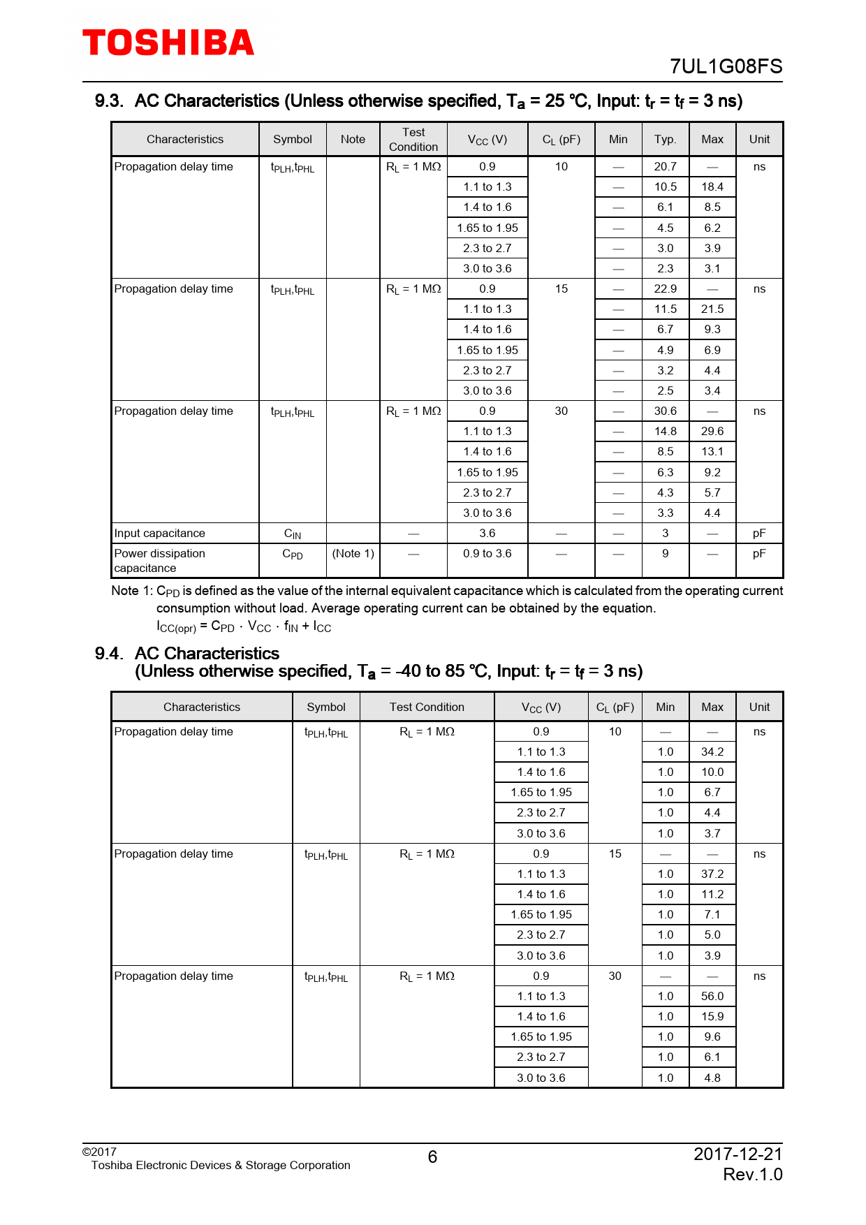

| Description | Single 2-Input AND Gate. L-MOS LVP series |

7UL1G08FS. 9.3. AC. Characteristics. (Unless. otherwise. specified,. Ta. =. 25. ,. Input:. tr. =. tf. =. 3. ns). Test. Characteristics. Symbol. Note. VCC. (V). CL. (pF)
7UL1G08FS 9.3. AC Characteristics (Unless otherwise specified, Ta = 25 , Input: tr = tf = 3 ns) Test Characteristics Symbol Note VCC (V) CL (pF) Min Typ. Max Unit Condition Propagation delay time tPLH,tPHL RL = 1 MΩ 0.9 10 20.7 ns 1.1 to 1.3 10.5 18.4 1.4 to 1.6 6.1 8.5 1.65 to 1.95 4.5 6.2 2.3 to 2.7 3.0 3.9 3.0 to 3.6 2.3 3.1 Propagation delay time tPLH,tPHL RL = 1 MΩ 0.9 15 22.9 ns 1.1 to 1.3 11.5 21.5 1.4 to 1.6 6.7 9.3 1.65 to 1.95 4.9 6.9 2.3 to 2.7 3.2 4.4 3.0 to 3.6 2.5 3.4 Propagation delay time tPLH,tPHL RL = 1 MΩ 0.9 30 30.6 ns 1.1 to 1.3 14.8 29.6 1.4 to 1.6 8.5 13.1 1.65 to 1.95 6.3 9.2 2.3 to 2.7 4.3 5.7 3.0 to 3.6 3.3 4.4 Input capacitance CIN 3.6 3 pF Power dissipation CPD (Note 1) 0.9 to 3.6 9 pF capacitance Note 1: CPD is defined as the value of the internal equivalent capacitance which is calculated from the operating current consumption without load. Average operating current can be obtained by the equation. ICC(opr) = CPDVCCfIN + ICC 9.4. AC Characteristics (Unless otherwise specified, Ta = -40 to 85 , Input: tr = tf = 3 ns) Characteristics Symbol Test Condition VCC (V) CL (pF) Min Max Unit Propagation delay time tPLH,tPHL RL = 1 MΩ 0.9 10 ns 1.1 to 1.3 1.0 34.2 1.4 to 1.6 1.0 10.0 1.65 to 1.95 1.0 6.7 2.3 to 2.7 1.0 4.4 3.0 to 3.6 1.0 3.7 Propagation delay time tPLH,tPHL RL = 1 MΩ 0.9 15 ns 1.1 to 1.3 1.0 37.2 1.4 to 1.6 1.0 11.2 1.65 to 1.95 1.0 7.1 2.3 to 2.7 1.0 5.0 3.0 to 3.6 1.0 3.9 Propagation delay time tPLH,tPHL RL = 1 MΩ 0.9 30 ns 1.1 to 1.3 1.0 56.0 1.4 to 1.6 1.0 15.9 1.65 to 1.95 1.0 9.6 2.3 to 2.7 1.0 6.1 3.0 to 3.6 1.0 4.8 ©2017 6 2017-12-21 Toshiba Electronic Devices & Storage Corporation Rev.1.0
