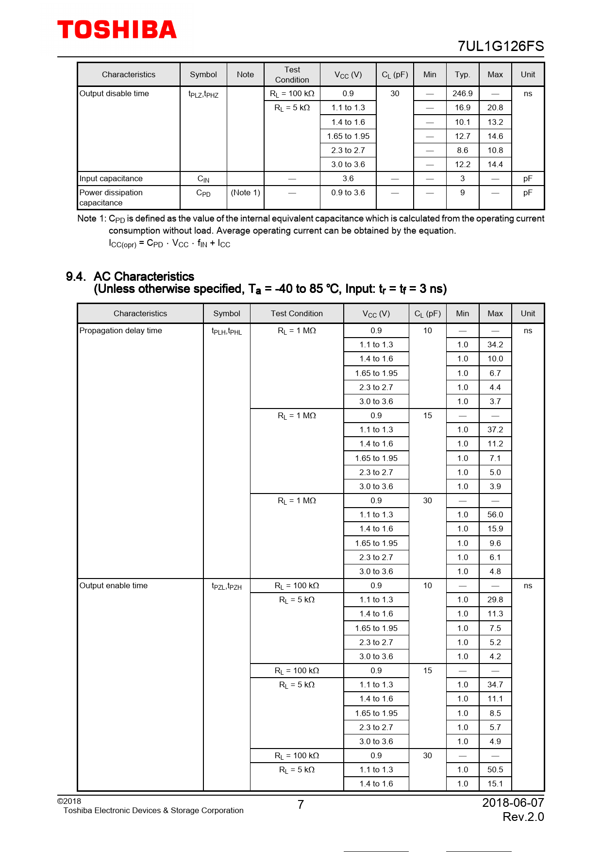

| Manufacturer | Toshiba |
| Description | Single Bus Buffer (3-State). L-MOS LVP series |
| Pages / Page | 11 / 7 — 7UL1G126FS. Test. Characteristics. Symbol. Note. VCC. (V). CL. (pF). Min. … |
| File Format / Size | PDF / 194 Kb |
7UL1G126FS. Test. Characteristics. Symbol. Note. VCC. (V). CL. (pF). Min. Typ. Max. Unit. Condition. Output. disable. time. tPLZ,tPHZ. RL. =. 100. kΩ. 0.9. 30. . 246.9.
7UL1G126FS Test Characteristics Symbol Note VCC (V) CL (pF) Min Typ. Max Unit Condition Output disable time tPLZ,tPHZ RL = 100 kΩ 0.9 30 246.9 ns RL = 5 kΩ 1.1 to 1.3 16.9 20.8 1.4 to 1.6 10.1 13.2 1.65 to 1.95 12.7 14.6 2.3 to 2.7 8.6 10.8 3.0 to 3.6 12.2 14.4 Input capacitance CIN 3.6 3 pF Power dissipation CPD (Note 1) 0.9 to 3.6 9 pF capacitance Note 1: CPD is defined as the value of the internal equivalent capacitance which is calculated from the operating current consumption without load. Average operating current can be obtained by the equation. ICC(opr) = CPDVCCfIN + ICC 9.4. AC Characteristics (Unless otherwise specified, Ta = -40 to 85 , Input: tr = tf = 3 ns) Characteristics Symbol Test Condition VCC (V) CL (pF) Min Max Unit Propagation delay time tPLH,tPHL RL = 1 MΩ 0.9 10 ns 1.1 to 1.3 1.0 34.2 1.4 to 1.6 1.0 10.0 1.65 to 1.95 1.0 6.7 2.3 to 2.7 1.0 4.4 3.0 to 3.6 1.0 3.7 RL = 1 MΩ 0.9 15 1.1 to 1.3 1.0 37.2 1.4 to 1.6 1.0 11.2 1.65 to 1.95 1.0 7.1 2.3 to 2.7 1.0 5.0 3.0 to 3.6 1.0 3.9 RL = 1 MΩ 0.9 30 1.1 to 1.3 1.0 56.0 1.4 to 1.6 1.0 15.9 1.65 to 1.95 1.0 9.6 2.3 to 2.7 1.0 6.1 3.0 to 3.6 1.0 4.8 Output enable time tPZL,tPZH RL = 100 kΩ 0.9 10 ns RL = 5 kΩ 1.1 to 1.3 1.0 29.8 1.4 to 1.6 1.0 11.3 1.65 to 1.95 1.0 7.5 2.3 to 2.7 1.0 5.2 3.0 to 3.6 1.0 4.2 RL = 100 kΩ 0.9 15 RL = 5 kΩ 1.1 to 1.3 1.0 34.7 1.4 to 1.6 1.0 11.1 1.65 to 1.95 1.0 8.5 2.3 to 2.7 1.0 5.7 3.0 to 3.6 1.0 4.9 RL = 100 kΩ 0.9 30 RL = 5 kΩ 1.1 to 1.3 1.0 50.5 1.4 to 1.6 1.0 15.1 ©2018 7 2018-06-07 Toshiba Electronic Devices & Storage Corporation Rev.2.0
