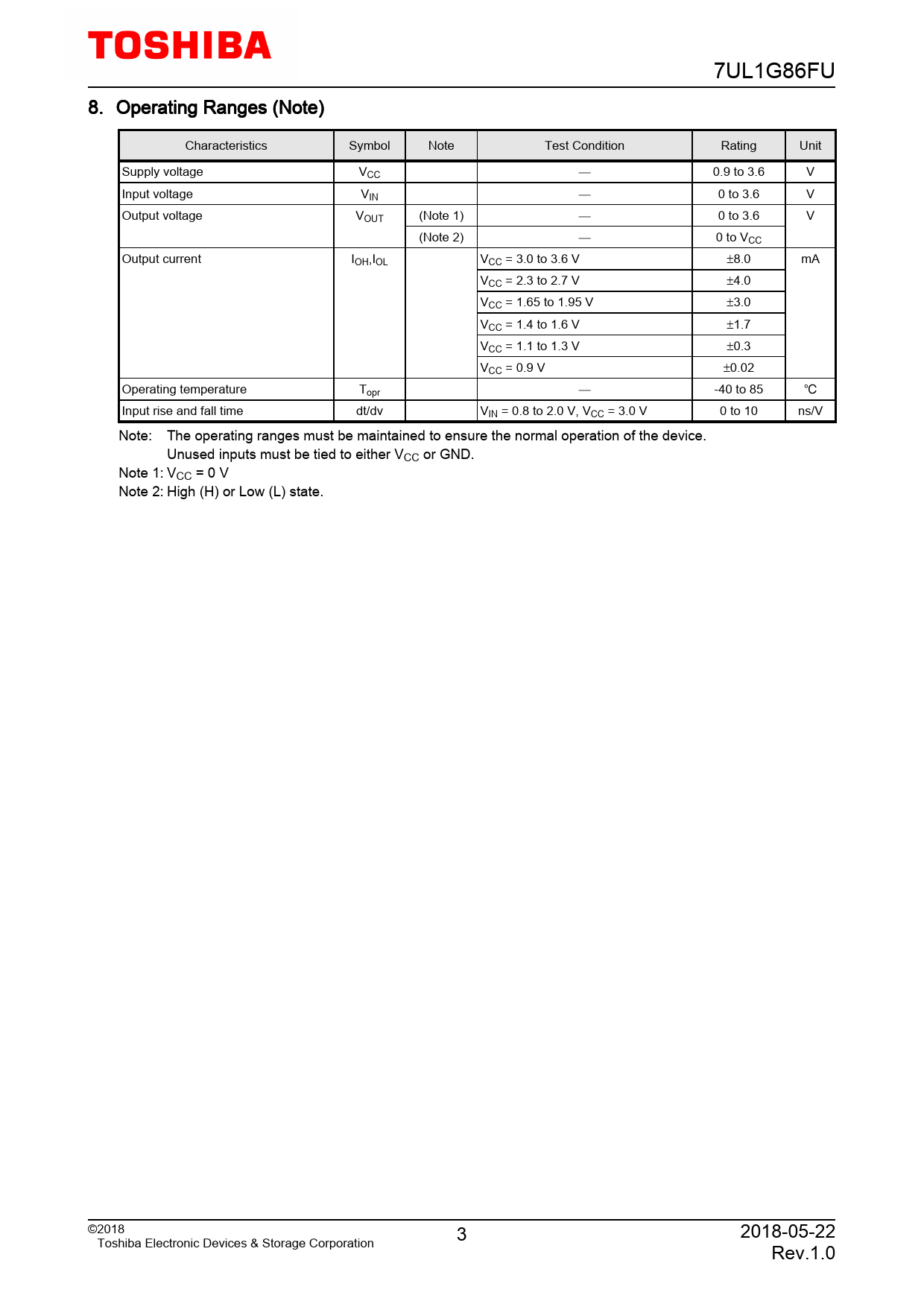

Pages / Page8 / 3 — 7UL1G86FU. 8. Operating. Ranges. (Note). Characteristics. Symbol. Note. …
File Format / SizePDF / 154 Kb
7UL1G86FU. 8. Operating. Ranges. (Note). Characteristics. Symbol. Note. Test. Condition. Rating. Unit. Supply. voltage. VCC. . 0.9. to. 3.6. V. Input. voltage
7UL1G86FU 8 Operating Ranges (Note) Characteristics Symbol Note Test Condition Rating Unit Supply voltage VCC  0.9 to 3.6 V Input voltage
7UL1G
7UL1G86FU 8. Operating Ranges (Note) Characteristics Symbol Note Test Condition Rating Unit Supply voltage VCC  0.9 to 3.6 V Input voltage VIN  0 to 3.6 V Output voltage VOUT (Note 1)  0 to 3.6 V (Note 2)  0 to VCC Output current IOH,IOL VCC = 3.0 to 3.6 V ±8.0 mA VCC = 2.3 to 2.7 V ±4.0 VCC = 1.65 to 1.95 V ±3.0 VCC = 1.4 to 1.6 V ±1.7 VCC = 1.1 to 1.3 V ±0.3 VCC = 0.9 V ±0.02 Operating temperature Topr  -40 to 85 Input rise and fall time dt/dv VIN = 0.8 to 2.0 V, VCC = 3.0 V 0 to 10 ns/V Note: The operating ranges must be maintained to ensure the normal operation of the device. Unused inputs must be tied to either VCC or GND. Note 1: VCC = 0 V Note 2: High (H) or Low (L) state. ©2018 3 2018-05-22 Toshiba Electronic Devices & Storage Corporation Rev.1.0
