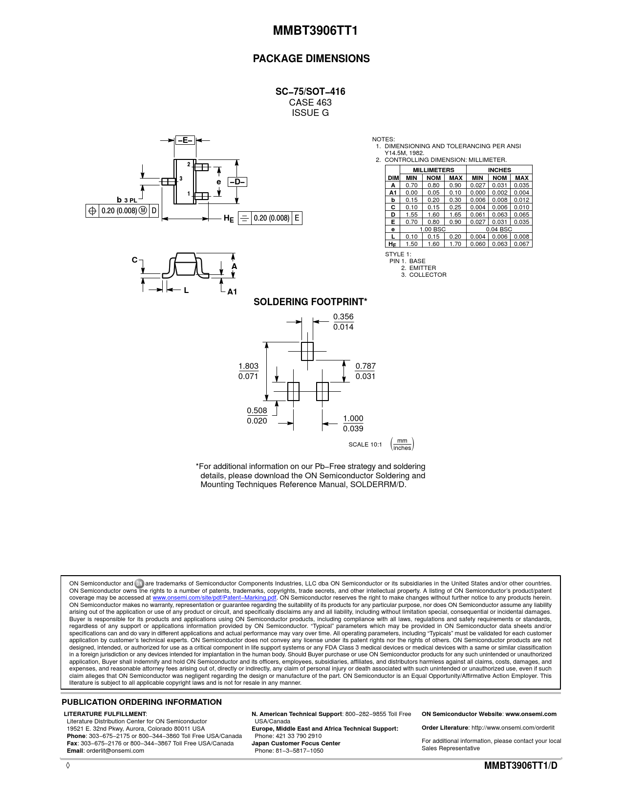

MMBT3906TT1. PACKAGE DIMENSIONS. SC−75/SOT−416. −E−. MILLIMETERS. INCHES. DIM. MIN. NOM. MAX. −D−. b 3 PL. SOLDERING FOOTPRINT*
MMBT3906TT1 PACKAGE DIMENSIONS SC−75/SOT−416 −E− MILLIMETERS INCHES DIM MIN NOM MAX −D− b 3 PL SOLDERING FOOTPRINT*
CASE 463 ISSUE G NOTES:
−E−
1. DIMENSIONING AND TOLERANCING PER ANSI Y14.5M, 1982. 2. CONTROLLING DIMENSION: MILLIMETER.
2 MILLIMETERS INCHES 3 DIM MIN NOM MAX MIN NOM MAX e −D− A
0.70 0.80 0.90 0.027 0.031 0.035
1 A1
0.00 0.05 0.10 0.000 0.002 0.004
b 3 PL b
0.15 0.20 0.30 0.006 0.008 0.012 0.20 (0.008)
C
0.10 0.15 0.25 0.004 0.006 0.010 M D
H
0.20 (0.008) E
D
1.55 1.60 1.65 0.061 0.063 0.065
E E
e
1.00 BSC 0.04 BSC
L
0.10 0.15 0.20 0.004 0.006 0.008
HE
1.50 1.60 1.70 0.060 0.063 0.067 STYLE 1:
C
PIN 1. BASE
A
2. EMITTER 3. COLLECTOR
L A1 SOLDERING FOOTPRINT*
0.356 0.014 1.803 0.787 0.071 0.031 0.508 0.020 1.000 0.039 SCALE 10:1 ǒ mm Ǔ inches *For additional information on our Pb−Free strategy and soldering details, please download the ON Semiconductor Soldering and Mounting Techniques Reference Manual, SOLDERRM/D. ON Semiconductor and are trademarks of Semiconductor Components Industries, LLC dba ON Semiconductor or its subsidiaries in the United States and/or other countries. ON Semiconductor owns the rights to a number of patents, trademarks, copyrights, trade secrets, and other intellectual property. A listing of ON Semiconductor’s product/patent coverage may be accessed at www.onsemi.com/site/pdf/Patent−Marking.pdf. ON Semiconductor reserves the right to make changes without further notice to any products herein. ON Semiconductor makes no warranty, representation or guarantee regarding the suitability of its products for any particular purpose, nor does ON Semiconductor assume any liability arising out of the application or use of any product or circuit, and specifically disclaims any and all liability, including without limitation special, consequential or incidental damages. Buyer is responsible for its products and applications using ON Semiconductor products, including compliance with all laws, regulations and safety requirements or standards, regardless of any support or applications information provided by ON Semiconductor. “Typical” parameters which may be provided in ON Semiconductor data sheets and/or specifications can and do vary in different applications and actual performance may vary over time. All operating parameters, including “Typicals” must be validated for each customer application by customer’s technical experts. ON Semiconductor does not convey any license under its patent rights nor the rights of others. ON Semiconductor products are not designed, intended, or authorized for use as a critical component in life support systems or any FDA Class 3 medical devices or medical devices with a same or similar classification in a foreign jurisdiction or any devices intended for implantation in the human body. Should Buyer purchase or use ON Semiconductor products for any such unintended or unauthorized application, Buyer shall indemnify and hold ON Semiconductor and its officers, employees, subsidiaries, affiliates, and distributors harmless against all claims, costs, damages, and expenses, and reasonable attorney fees arising out of, directly or indirectly, any claim of personal injury or death associated with such unintended or unauthorized use, even if such claim alleges that ON Semiconductor was negligent regarding the design or manufacture of the part. ON Semiconductor is an Equal Opportunity/Affirmative Action Employer. This literature is subject to all applicable copyright laws and is not for resale in any manner.
