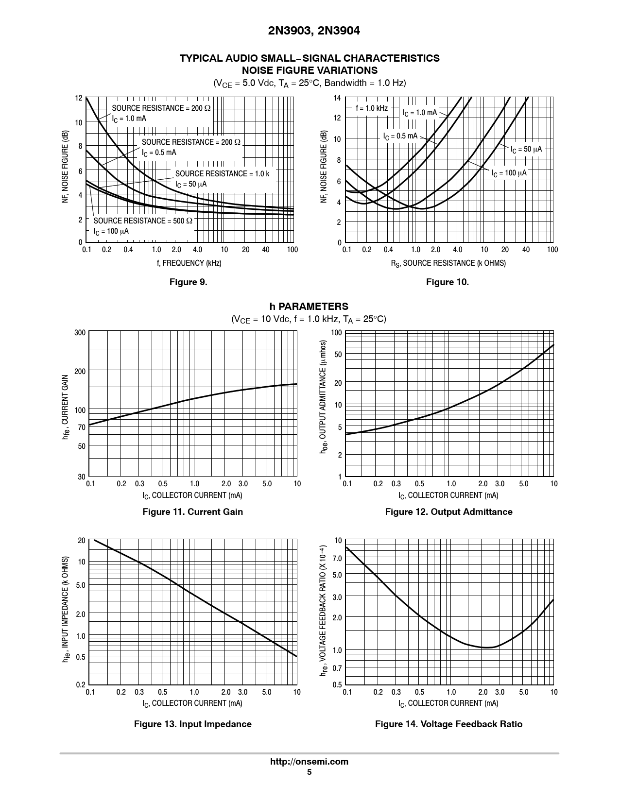

2N3903, 2N3904. TYPICAL AUDIO SMALL−SIGNAL CHARACTERISTICS. NOISE FIGURE VARIATIONS. Figure 9. Figure 10. h PARAMETERS
2N3903, 2N3904 TYPICAL AUDIO SMALL−SIGNAL CHARACTERISTICS NOISE FIGURE VARIATIONS Figure 9 Figure 10 h PARAMETERS
(VCE = 5.0 Vdc, TA = 25°C, Bandwidth = 1.0 Hz) 12 14 SOURCE RESISTANCE = 200 W f = 1.0 kHz I I 12 C = 1.0 mA 10 C = 1.0 mA 10 IC = 0.5 mA 8 SOURCE RESISTANCE = 200 W IC = 50 mA IC = 0.5 mA 8 6 SOURCE RESISTANCE = 1.0 k IC = 100 mA 6 IC = 50 mA , NOISE FIGURE (dB) 4 , NOISE FIGURE (dB) NF NF 4 2 SOURCE RESISTANCE = 500 W 2 IC = 100 mA 0 0 0.1 0.2 0.4 1.0 2.0 4.0 10 20 40 100 0.1 0.2 0.4 1.0 2.0 4.0 10 20 40 100 f, FREQUENCY (kHz) RS, SOURCE RESISTANCE (k OHMS)
(VCE = 10 Vdc, f = 1.0 kHz, TA = 25°C) 300 100 50 m 200 ANCE ( mhos) 20 GAIN 10 100 ADMITT 70 5 feh , CURRENT 50 h , OUTPUT oe 2 30 1 0.1 0.2 0.3 0.5 1.0 2.0 3.0 5.0 10 0.1 0.2 0.3 0.5 1.0 2.0 3.0 5.0 10 IC, COLLECTOR CURRENT (mA) IC, COLLECTOR CURRENT (mA)
Figure 11. Current Gain Figure 12. Output Admittance
20 10 -4 7.0 10 5.0 TIO (X 10 ) 5.0 3.0 2.0 2.0 IMPEDANCE (k OHMS) 1.0 TAGE FEEDBACK RA 1.0 ie 0.5 h , INPUT re 0.7 h , VOL 0.2 0.5 0.1 0.2 0.3 0.5 1.0 2.0 3.0 5.0 10 0.1 0.2 0.3 0.5 1.0 2.0 3.0 5.0 10 IC, COLLECTOR CURRENT (mA) IC, COLLECTOR CURRENT (mA)
Figure 13. Input Impedance Figure 14. Voltage Feedback Ratio http://onsemi.com 5
