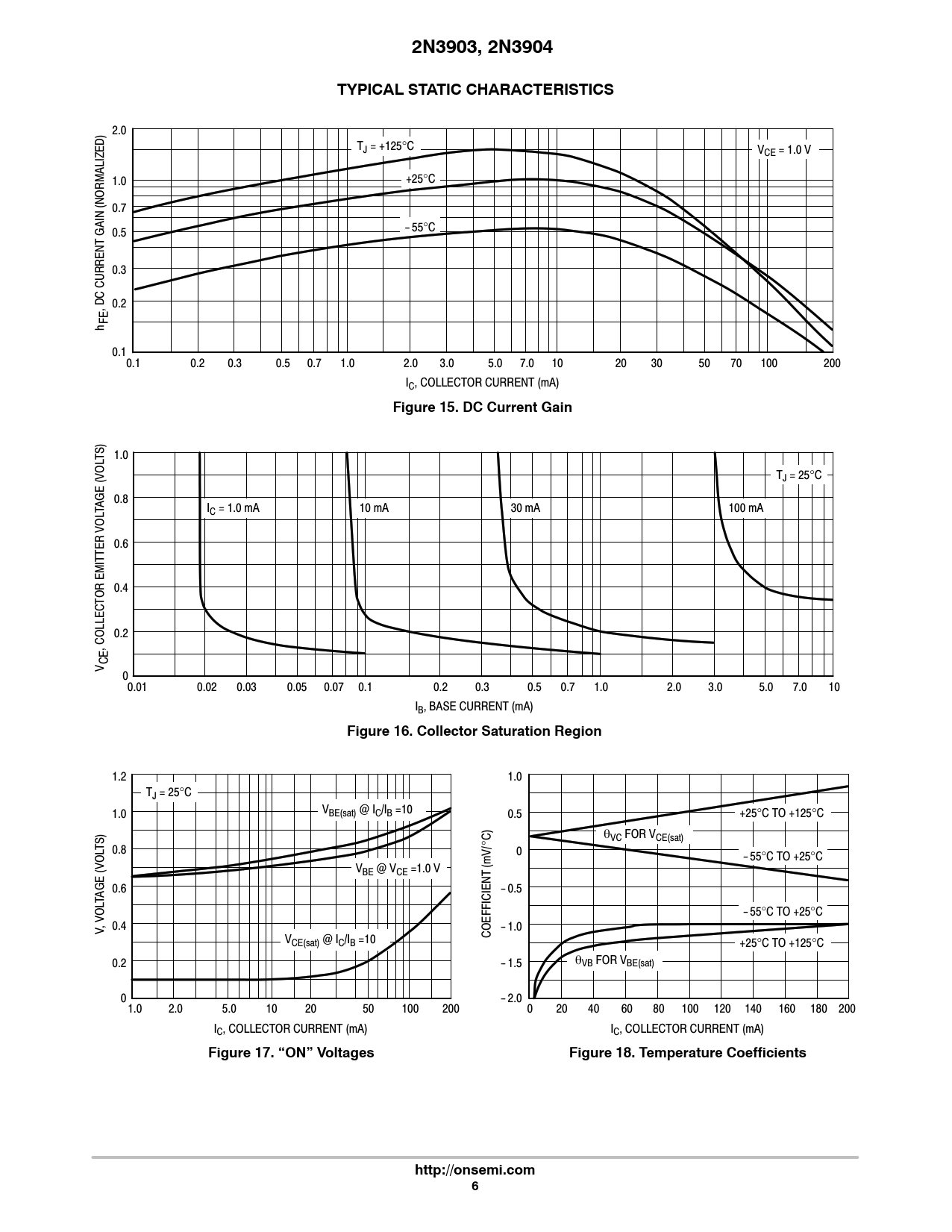

2N3903, 2N3904. TYPICAL STATIC CHARACTERISTICS. Figure 15. DC Current Gain. Figure 16. Collector Saturation Region
2N3903, 2N3904 TYPICAL STATIC CHARACTERISTICS Figure 15 DC Current Gain Figure 16 Collector Saturation Region
2.0 TJ = +125°C VCE = 1.0 V 1.0 +25°C 0.7 -55°C GAIN (NORMALIZED) 0.5 0.3 0.2 FEh , DC CURRENT 0.10.1 0.2 0.3 0.5 0.7 1.0 2.0 3.0 5.0 7.0 10 20 30 50 70 100 200 IC, COLLECTOR CURRENT (mA)
TS) 1.0 TJ = 25°C 0.8 TAGE (VOL IC = 1.0 mA 10 mA 30 mA 100 mA 0.6 0.4 OR EMITTER VOL 0.2 CEV , COLLECT 00.01 0.02 0.03 0.05 0.07 0.1 0.2 0.3 0.5 0.7 1.0 2.0 3.0 5.0 7.0 10 IB, BASE CURRENT (mA)
1.2 1.0 TJ = 25°C 1.0 VBE(sat) @ IC/IB =10 0.5 +25°C TO +125°C qVC FOR VCE(sat) TS) ° 0.8 0 -55°C TO +25°C V (mV/ C) BE @ VCE =1.0 V 0.6 -0.5 TAGE (VOL -55°C TO +25°C , VOL 0.4 V -1.0 COEFFICIENT VCE(sat) @ IC/IB =10 +25°C TO +125°C 0.2 -1.5 qVB FOR VBE(sat) 0 -2.0 1.0 2.0 5.0 10 20 50 100 200 0 20 40 60 80 100 120 140 160 180 200 IC, COLLECTOR CURRENT (mA) IC, COLLECTOR CURRENT (mA)
Figure 17. “ON” Voltages Figure 18. Temperature Coefficients http://onsemi.com 6
