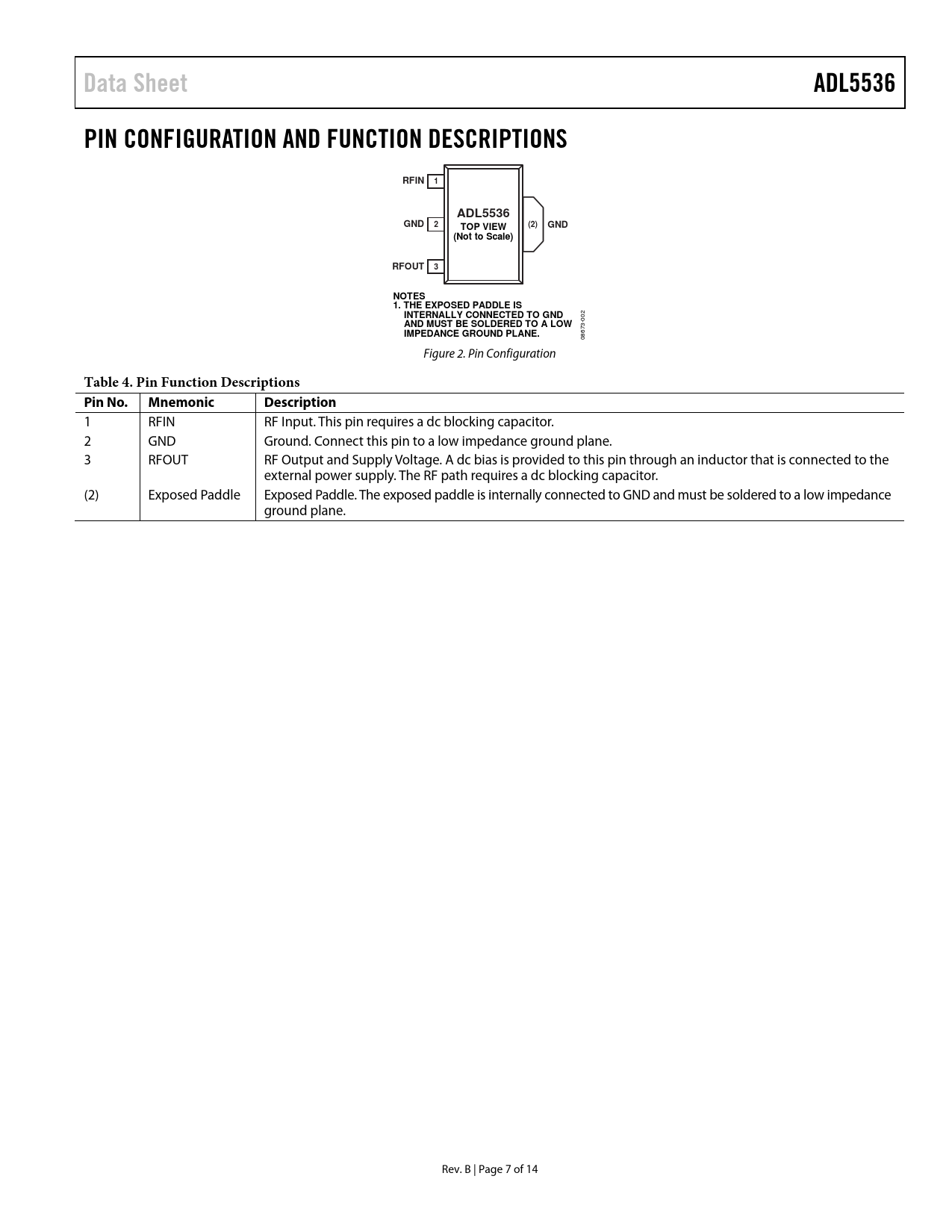

Data Sheet. ADL5536. PIN CONFIGURATION AND FUNCTION DESCRIPTIONS. RFIN. GND. (2). TOP VIEW. (Not to Scale). RFOUT
Data Sheet ADL5536 PIN CONFIGURATION AND FUNCTION DESCRIPTIONS RFIN GND (2) TOP VIEW (Not to Scale) RFOUT
Data Sheet ADL5536 PIN CONFIGURATION AND FUNCTION DESCRIPTIONS RFIN 1 ADL5536 GND 2 (2) GND TOP VIEW (Not to Scale) RFOUT 3 NOTES 1. THE EXPOSED PADDLE IS INTERNALLY CONNECTED TO GND
002
AND MUST BE SOLDERED TO A LOW IMPEDANCE GROUND PLANE.
08673- Figure 2. Pin Configuration
Table 4. Pin Function Descriptions Pin No. Mnemonic Description
1 RFIN RF Input. This pin requires a dc blocking capacitor. 2 GND Ground. Connect this pin to a low impedance ground plane. 3 RFOUT RF Output and Supply Voltage. A dc bias is provided to this pin through an inductor that is connected to the external power supply. The RF path requires a dc blocking capacitor. (2) Exposed Paddle Exposed Paddle. The exposed paddle is internally connected to GND and must be soldered to a low impedance ground plane. Rev. B | Page 7 of 14 Document Outline FEATURES FUNCTIONAL BLOCK DIAGRAM GENERAL DESCRIPTION TABLE OF CONTENTS REVISION HISTORY SPECIFICATIONS TYPICAL SCATTERING PARAMETERS (S-PARAMETERS) ABSOLUTE MAXIMUM RATINGS ESD CAUTION PIN CONFIGURATION AND FUNCTION DESCRIPTIONS TYPICAL PERFORMANCE CHARACTERISTICS BASIC CONNECTIONS SOLDERING INFORMATION AND RECOMMENDED PCB LAND PATTERN ACPR PERFORMANCE ERROR VECTOR MAGNITUDE (EVM) PERFORMANCE EVALUATION BOARD OUTLINE DIMENSIONS ORDERING GUIDE
