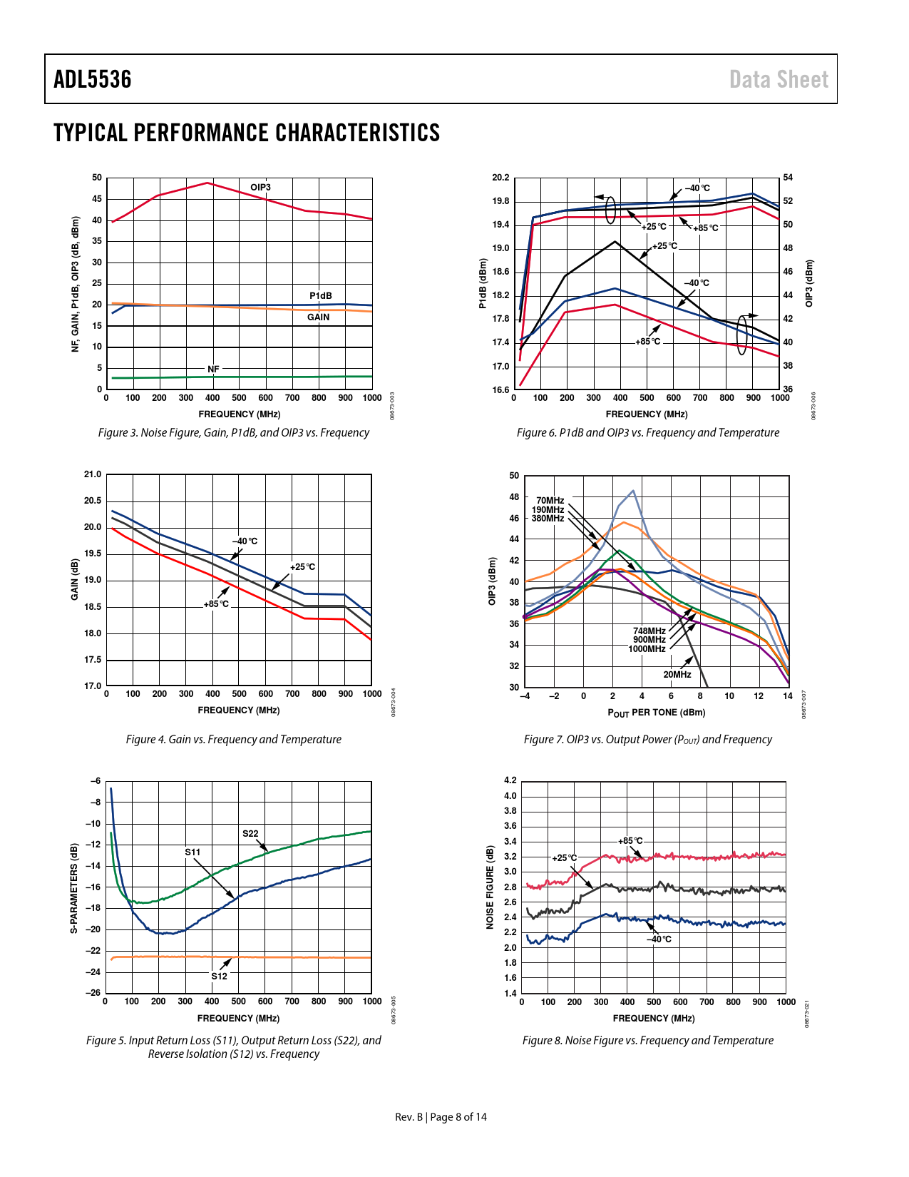

ADL5536. Data Sheet. TYPICAL PERFORMANCE CHARACTERISTICS. 20.2. OIP3. –40°C. 19.8. 19.4. +25°C. +85°C. , dB. 19.0. dB ( 3. Bm) 18.6. Bm). , OIP. B (. 3 (
ADL5536 Data Sheet TYPICAL PERFORMANCE CHARACTERISTICS 20.2 OIP3 –40°C 19.8 19.4 +25°C +85°C , dB 19.0 dB ( 3 Bm) 18.6 Bm) , OIP B ( 3 (
ADL5536 Data Sheet TYPICAL PERFORMANCE CHARACTERISTICS 50 20.2 54 OIP3 –40°C 45 19.8 52 ) 40 m 19.4 50 +25°C +85°C , dB 35 +25°C 19.0 48 dB ( 3 30 Bm) 18.6 46 Bm) d d , OIP 25 –40°C B ( 3 ( dB 18.2 44 1 P1dB IP 1d 20 P O , P IN GAIN 17.8 42 15 , GA F 17.4 +85°C 40 10 N 5 NF 17.0 38 0 16.6 36 0 100 200 300 400 500 600 700 800 900 1000
003
006
FREQUENCY (MHz) FREQUENCY (MHz)
08673- 08673- Figure 3. Noise Figure, Gain, P1dB, and OIP3 vs. Frequency Figure 6. P1dB and OIP3 vs. Frequency and Temperature
21.0 50 20.5 48 70MHz 190MHz 46 380MHz 20.0 –40°C 44 19.5 B) 42 d +25°C Bm) d N ( 19.0 40 AI 3 ( G IP +85°C 18.5 O 38 36 18.0 748MHz 900MHz 34 1000MHz 17.5 32 20MHz 17.0 30 0 100 200 300 400 500 600 700 800 900 1000
004
–4 –2 0 2 4 6 8 10 12 14
007
FREQUENCY (MHz)
08673-
POUT PER TONE (dBm)
08673- Figure 4. Gain vs. Frequency and Temperature Figure 7. OIP3 vs. Output Power (POUT) and Frequency
–6 4.2 4.0 –8 3.8 –10 3.6 S22 –12 3.4 ) +85°C B) d S11 ( dB 3.2 +25°C –14 ( E RS 3.0 E R T –16 E 2.8 FIGU 2.6 –18 E ARAM 2.4 P OIS N S- –20 2.2 –40°C –22 2.0 1.8 –24 S12 1.6 –26 1.4 0 100 200 300 400 500 600 700 800 900 1000
005
021
08673- 08673- Figure 5. Input Return Loss (S11), Output Return Loss (S22), and Figure 8. Noise Figure vs. Frequency and Temperature Reverse Isolation (S12) vs. Frequency Rev. B | Page 8 of 14 Document Outline FEATURES FUNCTIONAL BLOCK DIAGRAM GENERAL DESCRIPTION TABLE OF CONTENTS REVISION HISTORY SPECIFICATIONS TYPICAL SCATTERING PARAMETERS (S-PARAMETERS) ABSOLUTE MAXIMUM RATINGS ESD CAUTION PIN CONFIGURATION AND FUNCTION DESCRIPTIONS TYPICAL PERFORMANCE CHARACTERISTICS BASIC CONNECTIONS SOLDERING INFORMATION AND RECOMMENDED PCB LAND PATTERN ACPR PERFORMANCE ERROR VECTOR MAGNITUDE (EVM) PERFORMANCE EVALUATION BOARD OUTLINE DIMENSIONS ORDERING GUIDE
