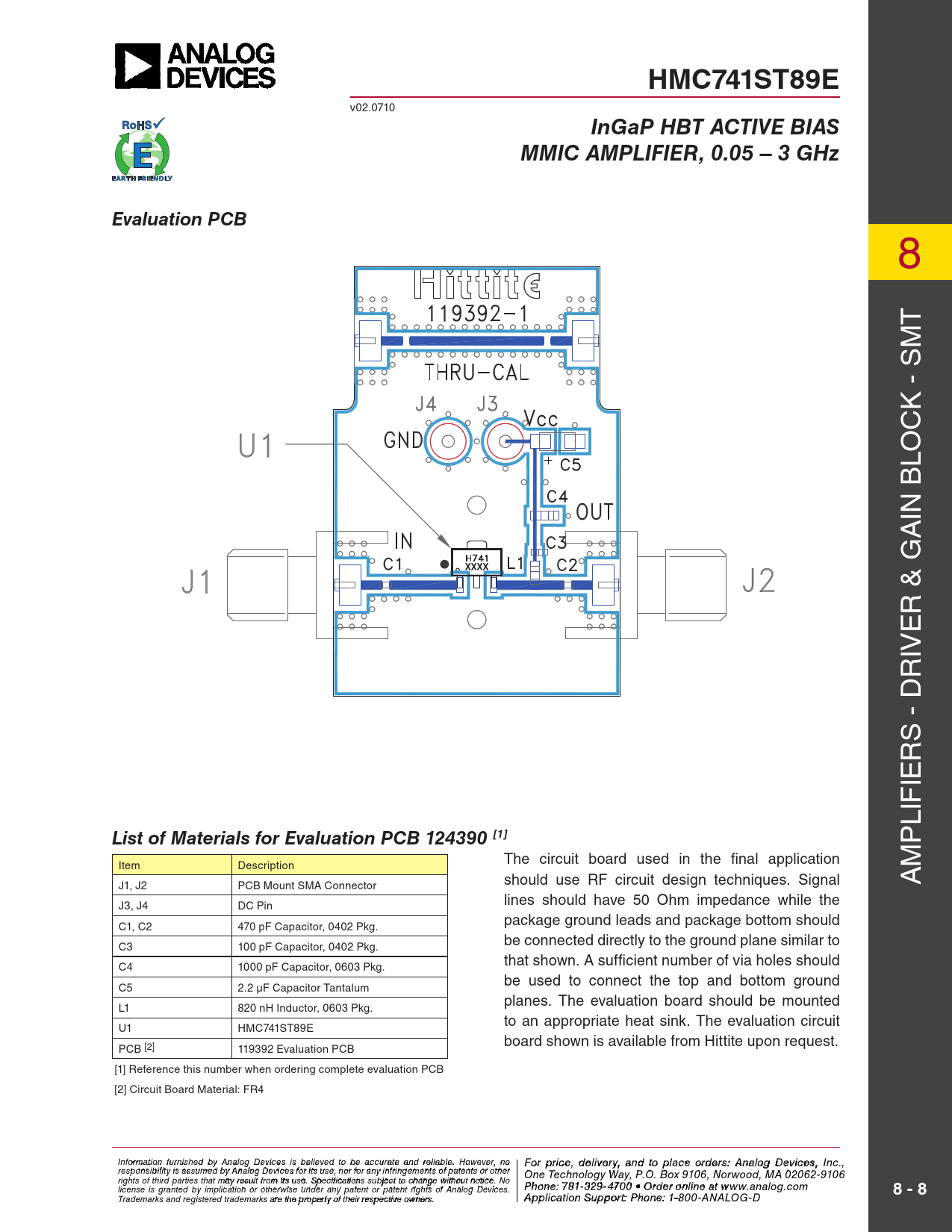

HMC741ST89E. InGaP HBT ACTIVE BIAS. MMIC AMPLIFIER, 0.05 – 3 GHz. Evaluation PCB
HMC741ST89E InGaP HBT ACTIVE BIAS MMIC AMPLIFIER, 0.05 – 3 GHz Evaluation PCB
HMC741ST89E
v02.0710
8 T m s k - c lo in B A r & G e iv r s - D r ie lif
List of Materials for Evaluation PCB 124390 [1]
p The circuit board used in the final application item Description m should use rf circuit design techniques. signal J1, J2 pcB mount smA connector A lines should have 50 ohm impedance while the J3, J4 Dc pin package ground leads and package bottom should c1, c2 470 pf capacitor, 0402 pkg. be connected directly to the ground plane similar to c3 100 pf capacitor, 0402 pkg. that shown. A sufficient number of via holes should c4 1000 pf capacitor, 0603 pkg. be used to connect the top and bottom ground c5 2.2 µf capacitor Tantalum planes. The evaluation board should be mounted l1 820 nH inductor, 0603 pkg. to an appropriate heat sink. The evaluation circuit U1 Hmc741sT89e board shown is available from Hittite upon request. pcB [2] 119392 evaluation pcB [1] reference this number when ordering complete evaluation pcB [2] circuit Board material: fr4 Inf F or o m rat ip o r n ifc ur e n ,is hd e e d lbiv y e Anry alo a g n D d evi cto es ips la beclie ev eo d rtd o e b r e sa: ccH ur iattte itaen M d reliic a r bl o e w . H a o v weev eC r, o n r o For price, delivery, and to place orders: Analog Devices, Inc., responsibility is assumed by Analog Devices for its use, nor for any infringements of patents or other poration, 20 Alpha Road, Chelmsford, MA 01824 One Technology Way, P.O. Box 9106, Norwood, MA 02062-9106 Phone: 978-250-3343 Fax: 978-250-3373 rights of third parties that may result from its use. Specifications subject to change without notice. No Or P d hoe n r e O : 7 n- 81-li 3 n 2 e 9- a 4 t 7 0 www 0 • O . rdh e itt r o it n e li . n co e a m license is granted by implication or otherwise under any patent or patent rights of Analog Devices. t www.analog.com
