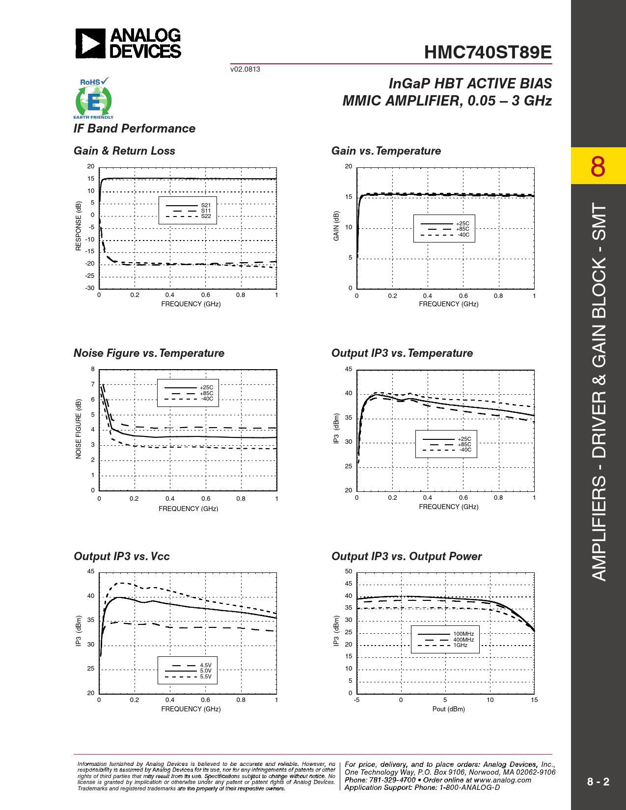

HMC740ST89E. InGaP HBT ACTIVE BIAS. MMIC AMPLIFIER, 0.05 – 3 GHz. IF Band Performance. Gain & Return Loss
HMC740ST89E InGaP HBT ACTIVE BIAS MMIC AMPLIFIER, 0.05 – 3 GHz IF Band Performance Gain & Return Loss
HMC740ST89E
v02.0813
InGaP HBT ACTIVE BIAS MMIC AMPLIFIER, 0.05 – 3 GHz IF Band Performance Gain & Return Loss Gain vs. Temperature
20 20 15 8 10 15 5 S21 (dB) S11 0 T S22 (dB) -5 10 +25C +85C M -40C -10 GAIN RESPONSE -15 5 -20 K - S -25 C -30 0 0 0.2 0.4 0.6 0.8 1 0 0.2 0.4 0.6 0.8 1 FREQUENCY (GHz) FREQUENCY (GHz) LO IN B
Noise Figure vs. Temperature Output IP3 vs. Temperature
A 8 45 7 +25C +85C 40 ) 6 -40C R & G (dB E 5 ) 35 E R U 4 IG (dBm IV F E IP3 30 +25C 3 +85C IS R -40C O N 2 25 1 S - D 0 20 0 0.2 0.4 0.6 0.8 1 0 0.2 0.4 0.6 0.8 1 R FREQUENCY (GHz) FREQUENCY (GHz) IE LIF P
Output IP3 vs. Vcc Output IP3 vs. Output Power
45 50 M 45 A 40 40 35 ) 35 30 (dBm (dBm 25 100MHz 400MHz IP3 30 IP3 20 1GHz 15 25 4.5V 5.0V 10 5.5V 5 20 0 0 0.2 0.4 0.6 0.8 1 -5 0 5 10 15 FREQUENCY (GHz) Pout (dBm) Inf F or o m r p atio r n ifc ur e n , d ishe e d lbiv y e Anry a alog n D d t evic o p es is la be clie o eved rd to e b r e sa: H ccur iattte itae M nd reliic a r bl o e w . H a o v wee C ver, o n rp o For price, delivery, and to place orders: Analog Devices, Inc., responsibility is assumed by Analog Devices for its use, nor for any infringements of patents or other oration, 20 Alpha Road, Chelmsford, MA 01824 One Technology Way, P.O. Box 9106, Norwood, MA 02062-9106 Phone: 978-250-3343 Fax: 978-250-3373 O rights of third parties that may result from its use. Specifications subject to change without notice. No rd Phoe n r O e: 7 n- 81-li 3 n 2 e a 9-4 t w 70 ww 0 • O . rdh e itt r o it nle i . n co e a m license is granted by implication or otherwise under any patent or patent rights of Analog Devices. t www.analog.com
