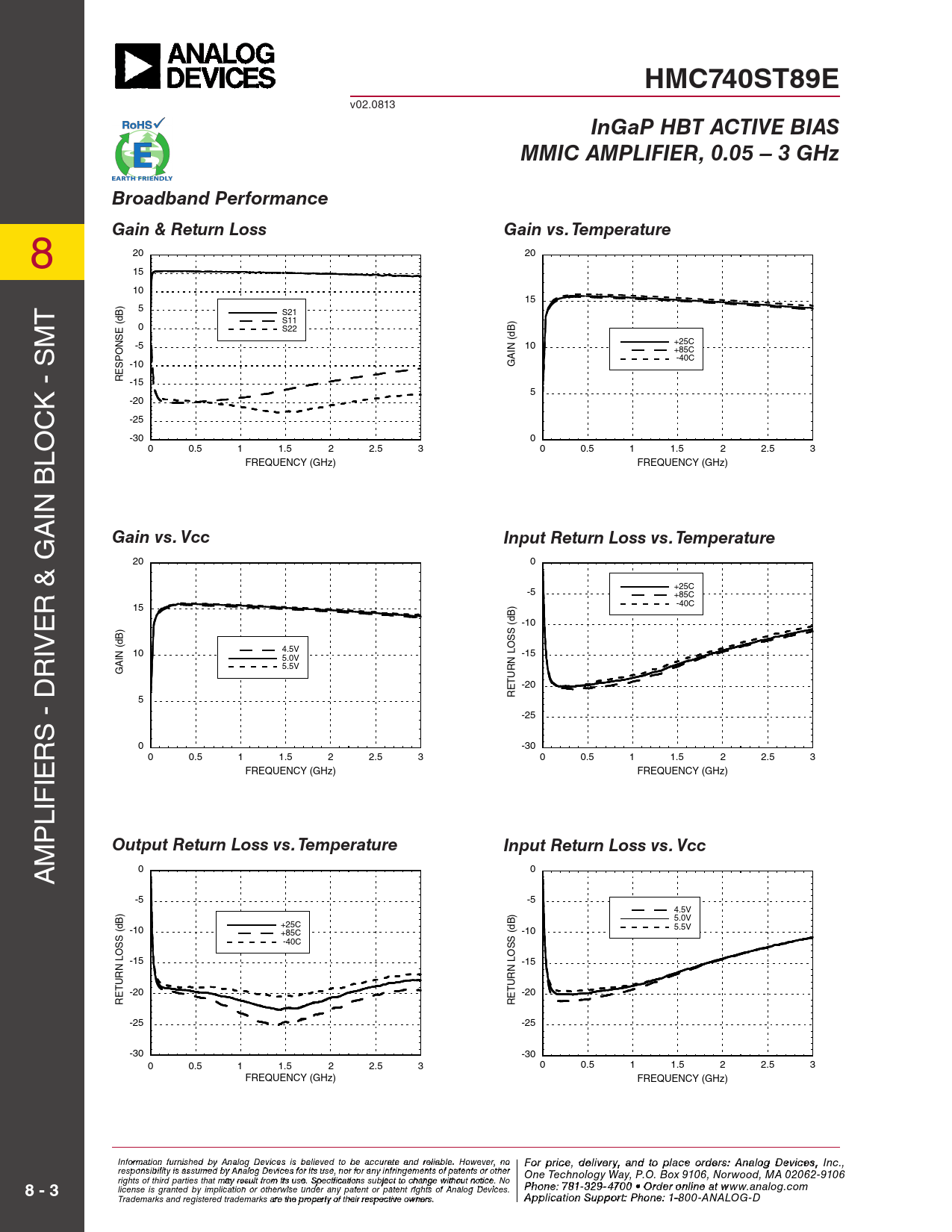

HMC740ST89E. InGaP HBT ACTIVE BIAS. MMIC AMPLIFIER, 0.05 – 3 GHz. Broadband Performance. Gain & Return Loss
HMC740ST89E InGaP HBT ACTIVE BIAS MMIC AMPLIFIER, 0.05 – 3 GHz Broadband Performance Gain & Return Loss
HMC740ST89E
v02.0813
8
Gain & Return Loss Gain vs. Temperature
20 20 15 10 T 15 5 S21 (dB) S11 M 0 S22 (dB) -5 10 +25C +85C -10 -40C GAIN RESPONSE -15 K - S 5 -20 C -25 -30 0 LO 0 0.5 1 1.5 2 2.5 3 0 0.5 1 1.5 2 2.5 3 FREQUENCY (GHz) FREQUENCY (GHz) IN B A
Gain vs. Vcc Input Return Loss vs. Temperature
20 0 +25C R & G -5 +85C -40C E 15 (dB) -10 IV (dB) 4.5V LOSS R 10 5.0V -15 5.5V GAIN -20 5 RETURN -25 S - D R 0 -30 0 0.5 1 1.5 2 2.5 3 0 0.5 1 1.5 2 2.5 3 IE FREQUENCY (GHz) FREQUENCY (GHz) LIF P M
Output Return Loss vs. Temperature Input Return Loss vs. Vcc
A 0 0 -5 -5 4.5V 5.0V (dB) -10 +25C (dB) +85C -10 5.5V -40C LOSS LOSS -15 -15 -20 -20 RETURN RETURN -25 -25 -30 -30 0 0.5 1 1.5 2 2.5 3 0 0.5 1 1.5 2 2.5 3 FREQUENCY (GHz) FREQUENCY (GHz) Inf F or o m r p atio r n ifc ur e n , d ishe e d lbiv y e Anry a alog n D d t evic o p es is la be clie o eved rd to e b r e sa: H ccur iattte itae M nd reliic a r bl o e w . H a o v wee C ver, o n rp o For price, delivery, and to place orders: Analog Devices, Inc., responsibility is assumed by Analog Devices for its use, nor for any infringements of patents or other oration, 20 Alpha Road, Chelmsford, MA 01824 One Technology Way, P.O. Box 9106, Norwood, MA 02062-9106 Phone: 978-250-3343 Fax: 978-250-3373 O rights of third parties that may result from its use. Specifications subject to change without notice. No rd Phoe n r O e: 7 n- 81-li 3 n 2 e a 9-4 t w 70 ww 0 • O . rdh e itt r o it nle i . n co e a m
