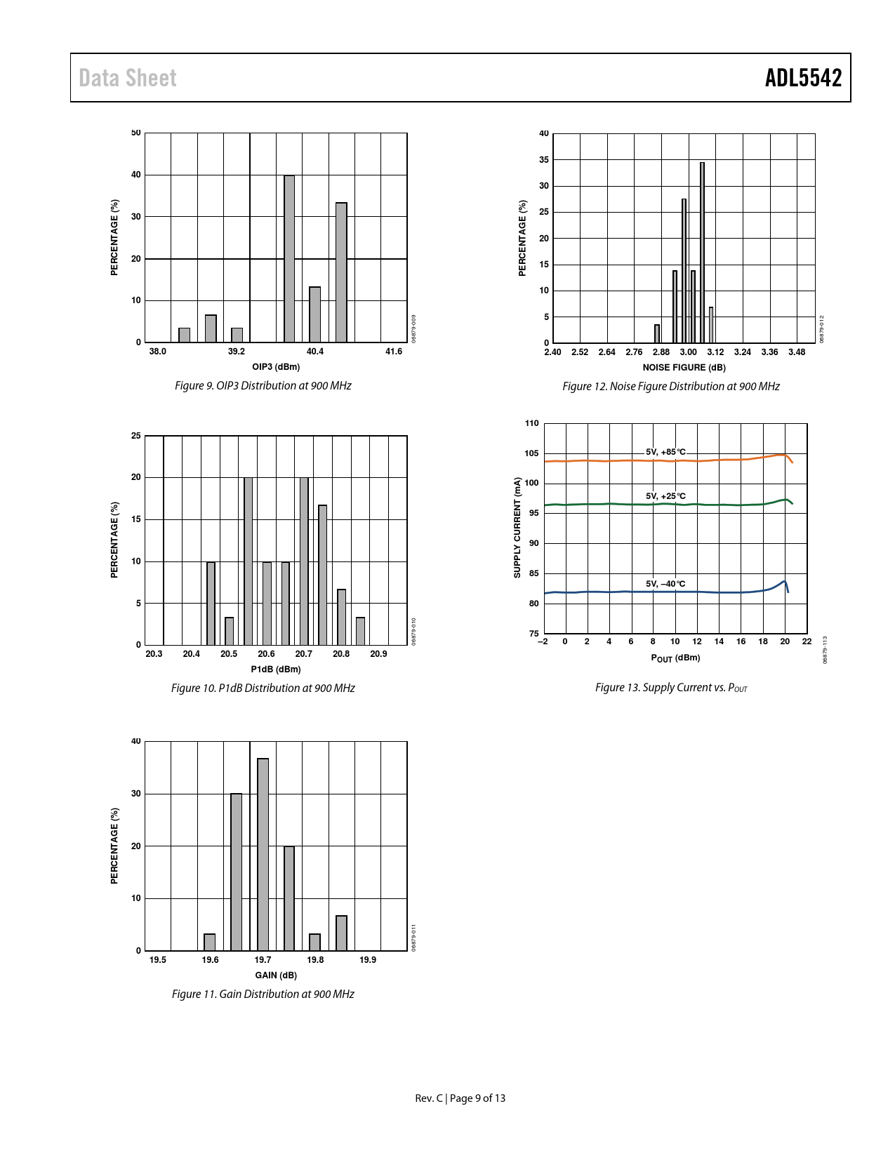

Data Sheet. ADL5542. RCE. 38.0. 39.2. 40.4. 41.6. 2.40. 2.52. 2.64. 2.76. 2.88. 3.00. 3.12. 3.24. 3.36. 3.48. OIP3 (dBm). NOISE FIGURE (dB). 110. 105. 5V, +85°C
Data Sheet ADL5542 RCE 38.0 39.2 40.4 41.6 2.40 2.52 2.64 2.76 2.88 3.00 3.12 3.24 3.36 3.48 OIP3 (dBm) NOISE FIGURE (dB) 110 105 5V, +85°C
Data Sheet ADL5542 50 40 35 40 30 %) %) ( ( 25 E 30 E AG AG 20 NT NT RCE 20 RCE E E 15 P P 10 10 5
Figure 9. OIP3 Distribution at 900 MHz Figure 12. Noise Figure Distribution at 900 MHz
110 25 105 5V, +85°C 20 100 mA) ( 5V, +25°C %) NT ( 95 E 15 AG CURRE NT 90 Y L RCE 10 PP E P 85 SU 5V, –40°C 5 80

–2 0 2 4 6 8 10 12 14 16 18 20 22

20.3 20.4 20.5 20.6 20.7 20.8 20.9 POUT (dBm)

P1dB (dBm)
Figure 10. P1dB Distribution at 900 MHz Figure 13. Supply Current vs. POUT
40 30 %) ( E AG 20 NT RCE E P 10

19.5 19.6 19.7 19.8 19.9 GAIN (dB)
Figure 11. Gain Distribution at 900 MHz Rev. C | Page 9 of 13 Document Outline FEATURES FUNCTIONAL BLOCK DIAGRAM GENERAL DESCRIPTION TABLE OF CONTENTS REVISION HISTORY SPECIFICATIONS TYPICAL SCATTERING PARAMETERS ABSOLUTE MAXIMUM RATINGS ESD CAUTION PIN CONFIGURATION AND FUNCTION DESCRIPTIONS TYPICAL PERFORMANCE CHARACTERISTICS OPERATING TO 20 MHz BASIC CONNECTIONS SOLDERING INFORMATION AND RECOMMENDED PCB LAND PATTERN EVALUATION BOARD OUTLINE DIMENSIONS ORDERING GUIDE
