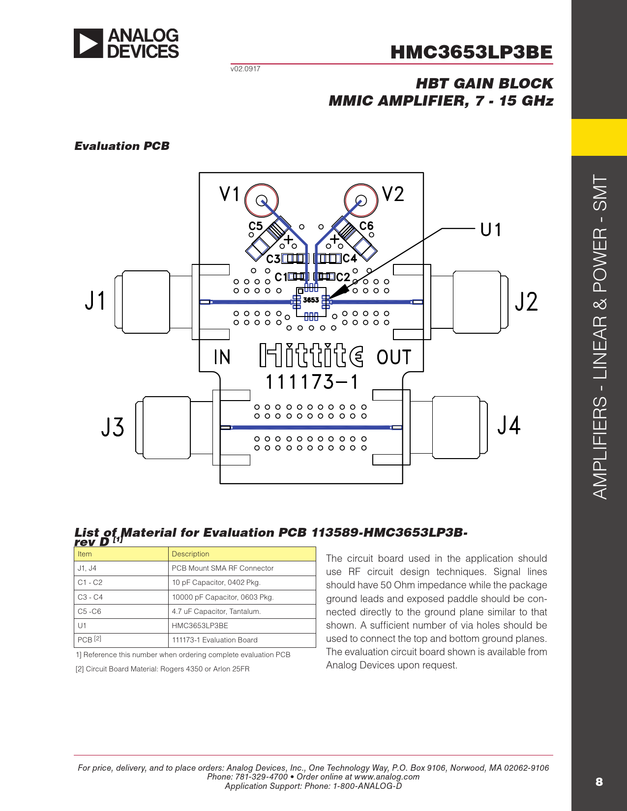

HBT GAIN BLOCK MMIC AMPLIFIER, 7 - 15 GHz Evaluation PCB
T m s er - w po r & A e lin s - plifier m A
List of Material for Evaluation PCB 113589-HMC3653LP3B- rev D [1]
item Description The circuit board used in the application should J1, J4 pCB mount smA rf Connector use rf circuit design techniques. signal lines C1 - C2 10 pf Capacitor, 0402 pkg. should have 50 ohm impedance while the package C3 - C4 10000 pf Capacitor, 0603 pkg. ground leads and exposed paddle should be con- C5 -C6 4.7 uf Capacitor, Tantalum. nected directly to the ground plane similar to that U1 HmC3653lp3Be shown. A sufficient number of via holes should be pCB [2] 111173-1 evaluation Board used to connect the top and bottom ground planes. 1] reference this number when ordering complete evaluation pCB The evaluation circuit board shown is available from [2] Circuit Board material: rogers 4350 or Arlon 25fr Analog Devices upon request. For price, delivery, and to place orders: Analog Devices, Inc., One Technology Way, P.O. Box 9106, Norwood, MA 02062-9106 Phone: 781-329-4700 • Order online at www.analog.com Application Support: Phone: 1-800-ANALOG-D
