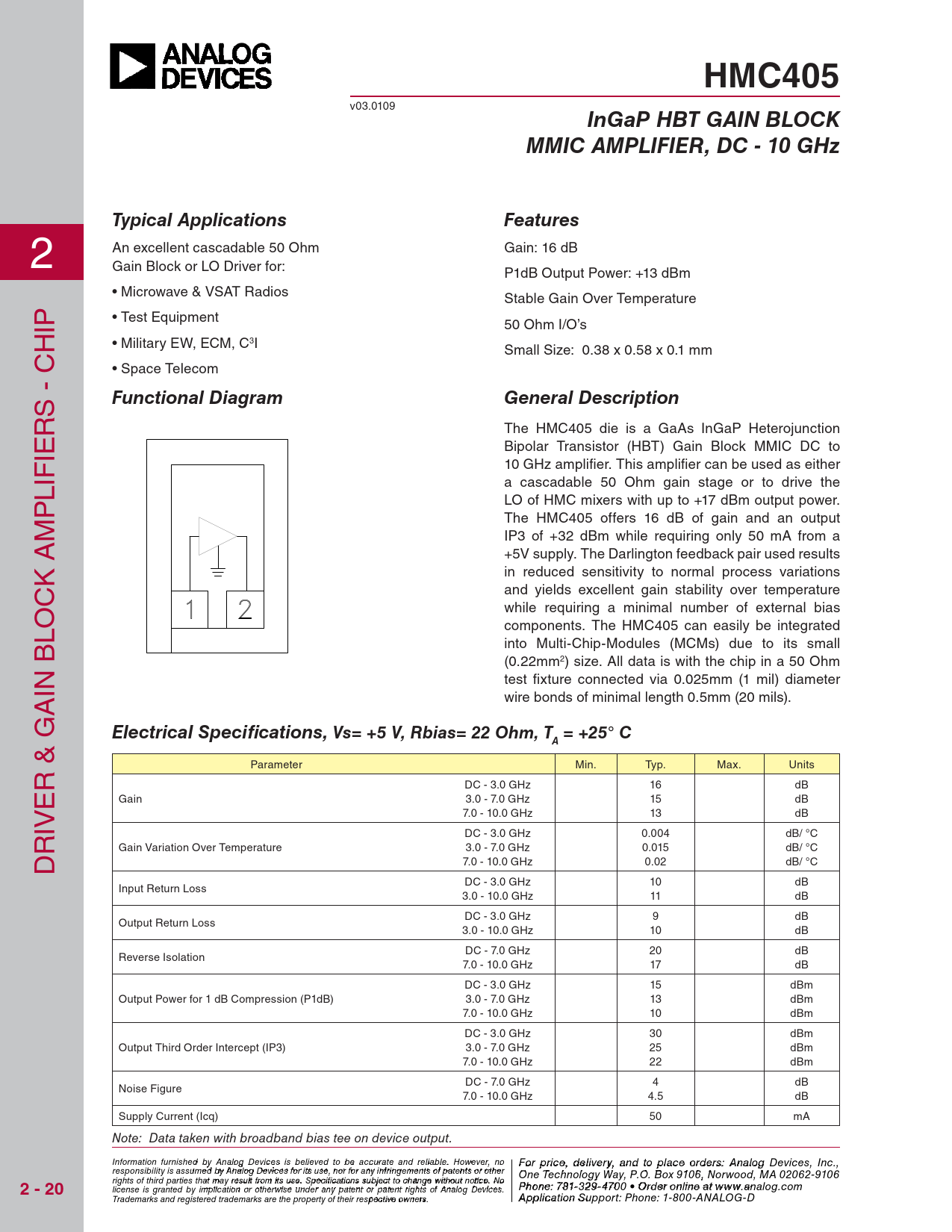

InGaP HBT GAIN BLOCK MMIC AMPLIFIER, DC - 10 GHz Typical Applications Features
2 An excellent cascadable 50 Ohm Gain: 16 dB Gain Block or LO Driver for: P1dB Output Power: +13 dBm • Microwave & VSAT Radios Stable Gain Over Temperature IP • Test Equipment 50 Ohm I/O’s H • Military EW, ECM, C3I Small Size: 0.38 x 0.58 x 0.1 mm • Space Telecom - C S
Functional Diagram General Description
R The HMC405 die is a GaAs InGaP Heterojunction IE Bipolar Transistor (HBT) Gain Block MMIC DC to 10 GHz amplifi er. This amplifi er can be used as either IF L a cascadable 50 Ohm gain stage or to drive the P LO of HMC mixers with up to +17 dBm output power. The HMC405 offers 16 dB of gain and an output M IP3 of +32 dBm while requiring only 50 mA from a +5V supply. The Darlington feedback pair used results K A in reduced sensitivity to normal process variations and yields excellent gain stability over temperature while requiring a minimal number of external bias OC components. The HMC405 can easily be integrated into Multi-Chip-Modules (MCMs) due to its small BL (0.22mm2) size. All data is with the chip in a 50 Ohm IN test fi xture connected via 0.025mm (1 mil) diameter A wire bonds of minimal length 0.5mm (20 mils).
Electrical Specifi cations, Vs= +5 V, Rbias= 22 Ohm, T = +25° C A
& G Parameter Min. Typ. Max. Units R DC - 3.0 GHz 16 dB E Gain 3.0 - 7.0 GHz 15 dB 7.0 - 10.0 GHz 13 dB IV DC - 3.0 GHz 0.004 dB/ °C R Gain Variation Over Temperature 3.0 - 7.0 GHz 0.015 dB/ °C D 7.0 - 10.0 GHz 0.02 dB/ °C DC - 3.0 GHz 10 dB Input Return Loss 3.0 - 10.0 GHz 11 dB DC - 3.0 GHz 9 dB Output Return Loss 3.0 - 10.0 GHz 10 dB DC - 7.0 GHz 20 dB Reverse Isolation 7.0 - 10.0 GHz 17 dB DC - 3.0 GHz 15 dBm Output Power for 1 dB Compression (P1dB) 3.0 - 7.0 GHz 13 dBm 7.0 - 10.0 GHz 10 dBm DC - 3.0 GHz 30 dBm Output Third Order Intercept (IP3) 3.0 - 7.0 GHz 25 dBm 7.0 - 10.0 GHz 22 dBm DC - 7.0 GHz 4 dB Noise Figure 7.0 - 10.0 GHz 4.5 dB Supply Current (Icq) 50 mA Note: Data taken with broadband bias tee on device output. Information furnish F ed obr pri y Anal ce, de og Device li s vie s r beyli, a eve nd to pla d to be accura ce o te and rder reliabl s e , pl . Ho ease co wever, no For price, delivery, and to place orders: Analog Devices, Inc., responsibility is assumed by Analog Devices for its use, nor for any infringements of patents or other ntact Hittite Microwave Corporation: One Technology Way, P.O. Box 9106, Norwood, MA 02062-9106 rights of third parties that may result from its use. Specifications subject to change without notice. No
