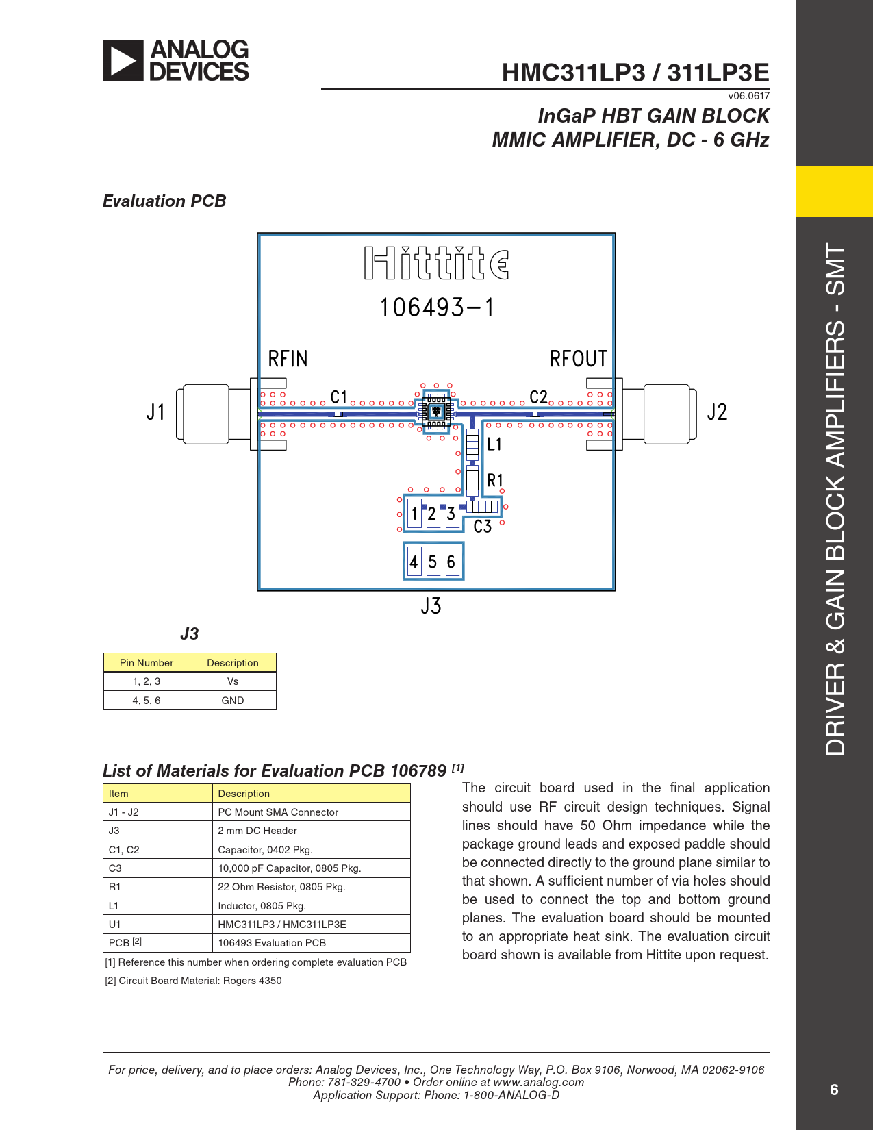

HMC311LP3 / 311LP3E. InGaP HBT GAIN BLOCK. MMIC AMPLIFIER, DC - 6 GHz. Evaluation PCB
HMC311LP3 / 311LP3E InGaP HBT GAIN BLOCK MMIC AMPLIFIER, DC - 6 GHz Evaluation PCB
HMC311LP3 / 311LP3E
v06.0617
T M S - S R IE LIF P M K A C LO IN B A
J3
Pin Number Description 1, 2, 3 Vs R & G E 4, 5, 6 GND IV R D
List of Materials for Evaluation PCB 106789 [1]
The circuit board used in the final application Item Description should use RF circuit design techniques. Signal J1 - J2 PC Mount SMA Connector lines should have 50 Ohm impedance while the J3 2 mm DC Header package ground leads and exposed paddle should C1, C2 Capacitor, 0402 Pkg. be connected directly to the ground plane similar to C3 10,000 pF Capacitor, 0805 Pkg. that shown. A sufficient number of via holes should R1 22 Ohm Resistor, 0805 Pkg. be used to connect the top and bottom ground L1 Inductor, 0805 Pkg. planes. The evaluation board should be mounted U1 HMC311LP3 / HMC311LP3E to an appropriate heat sink. The evaluation circuit PCB [2] 106493 Evaluation PCB board shown is available from Hittite upon request. [1] Reference this number when ordering complete evaluation PCB [2] Circuit Board Material: Rogers 4350 For price, delivery, and to place orders: Analog Devices, Inc., One Technology Way, P.O. Box 9106, Norwood, MA 02062-9106 Phone: 781-329-4700 • Order online at www.analog.com Application Support: Phone: 1-800-ANALOG-D
