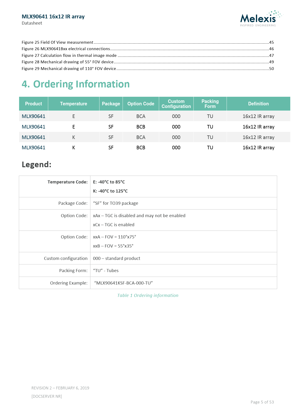

Datasheet Figure 25 Field Of View measurement ..45 Figure 26 MLX90641Bxx electrical connections...46 Figure 27 Calculation flow in thermal image mode ...47 Figure 28 Mechanical drawing of 55° FOV device ..49 Figure 29 Mechanical drawing of 110° FOV device ..50
4. Ordering Information Custom Packing Product Temperature Package Option Code Definition Configuration Form
MLX90641 E SF BCA 000 TU 16x12 IR array MLX90641 E SF BCB 000 TU 16x12 IR array MLX90641 K SF BCA 000 TU 16x12 IR array MLX90641 K SF BCB 000 TU 16x12 IR array
Legend: Temperature Code: E: -40°C to 85°C K: -40°C to 125°C
Package Code: “SF” for TO39 package Option Code: xAx – TGC is disabled and may not be enabled xCx – TGC is enabled Option Code: xxA – FOV = 110°x75° xxB – FOV = 55°x35° Custom configuration 000 – standard product Packing Form: “TU” - Tubes Ordering Example: “MLX90641KSF-BCA-000-TU” Table 1 Ordering information REVISION 2 – FEBRUARY 6, 2019 [DOCSERVER NR] Page 5 of 53
