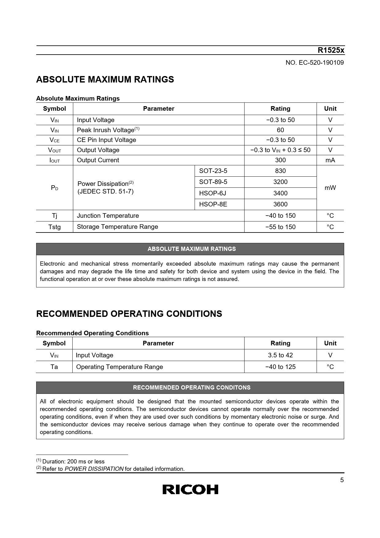

ABSOLUTE MAXIMUM RATINGS Absolute Maximum Ratings Symbol Parameter Rating Unit
VIN Input Voltage −0.3 to 50 V VIN Peak Inrush Voltage(1) 60 V VCE CE Pin Input Voltage −0.3 to 50 V VOUT Output Voltage −0.3 to VIN + 0.3 ≤ 50 V IOUT Output Current 300 mA SOT-23-5 830 Power Dissipation(2) SOT-89-5 3200 PD mW (JEDEC STD. 51-7) HSOP-6J 3400 HSOP-8E 3600 Tj Junction Temperature −40 to 150 °C Tstg Storage Temperature Range −55 to 150 °C
Electronic and mechanical stress momentarily exceeded absolute maximum ratings may cause the permanent damages and may degrade the life time and safety for both device and system using the device in the field. The functional operation at or over these absolute maximum ratings is not assured.
RECOMMENDED OPERATING CONDITIONS Recommended Operating Conditions Symbol Parameter Rating Unit
VIN Input Voltage 3.5 to 42 V Ta Operating Temperature Range −40 to 125 °C
RECOMMENDED OPERATING CONDITONS
All of electronic equipment should be designed that the mounted semiconductor devices operate within the recommended operating conditions. The semiconductor devices cannot operate normally over the recommended operating conditions, even if when they are used over such conditions by momentary electronic noise or surge. And the semiconductor devices may receive serious damage when they continue to operate over the recommended operating conditions. (1) Duration: 200 ms or less (2) Refer to POWER DISSIPATION for detailed information. 5
