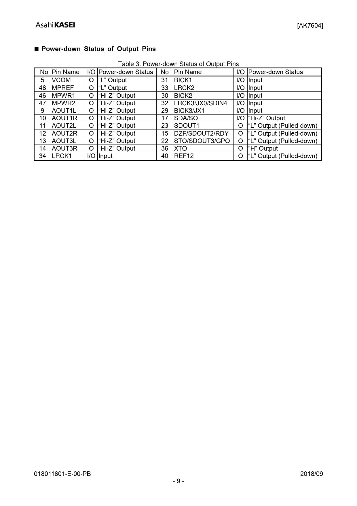

Datasheet AK7604 (Asahi Kasei Microdevices) - 9
| Manufacturer | Asahi Kasei Microdevices |
| Description | Audio DSP with 2chADC + 6chDAC + 8chSRC |
| Pages / Page | 37 / 9 — [AK7604] ■ Power-down. 34 Pin Name. VCOM. MPREF. MPWR1. MPWR2. AOUT1L. … |
| File Format / Size | PDF / 805 Kb |
[AK7604] ■ Power-down. 34 Pin Name. VCOM. MPREF. MPWR1. MPWR2. AOUT1L. AOUT1R. AOUT2L. AOUT2R. AOUT3L. AOUT3R. LRCK1 Status of Output Pins I/O
![[AK7604] ■ Power-down 34 Pin Name VCOM MPREF MPWR1 MPWR2 AOUT1L AOUT1R AOUT2L AOUT2R AOUT3L AOUT3R LRCK1 Status of Output Pins I/O](https://www.rlocman.ru/datasheet/img.php?di=165697&p=8)
No
5
48
46
47
9
10
11
12
13
14
34 Pin Name
VCOM
MPREF
MPWR1
MPWR2
AOUT1L
AOUT1R
AOUT2L
AOUT2R
AOUT3L
AOUT3R
O
O
O
O
O
O
O
O
O
O
I/O Table 3. Power-down Status of Output Pins
Power-down Status No Pin Name
I/O
“L” Output
31 BICK1
I/O
“L” Output
33 LRCK2
I/O
“Hi-Z” Output
30 BICK2
I/O
“Hi-Z” Output
32 LRCK3/JX0/SDIN4 I/O
“Hi-Z” Output
29 BICK3/JX1
I/O
“Hi-Z” Output
17 SDA/SO
I/O
“Hi-Z” Output
23 SDOUT1
O
“Hi-Z” Output
15 DZF/SDOUT2/RDY O
“Hi-Z” Output
22 STO/SDOUT3/GPO O
“Hi-Z” Output
36 XTO
O
Input
40 REF12
O 018011601-E-00-PB Power-down Status
Input
Input
Input
Input
Input
“Hi-Z” Output
“L” Output (Pulled-down)
“H” Output
“L” Output (Pulled-down) 2018/09
-9-
