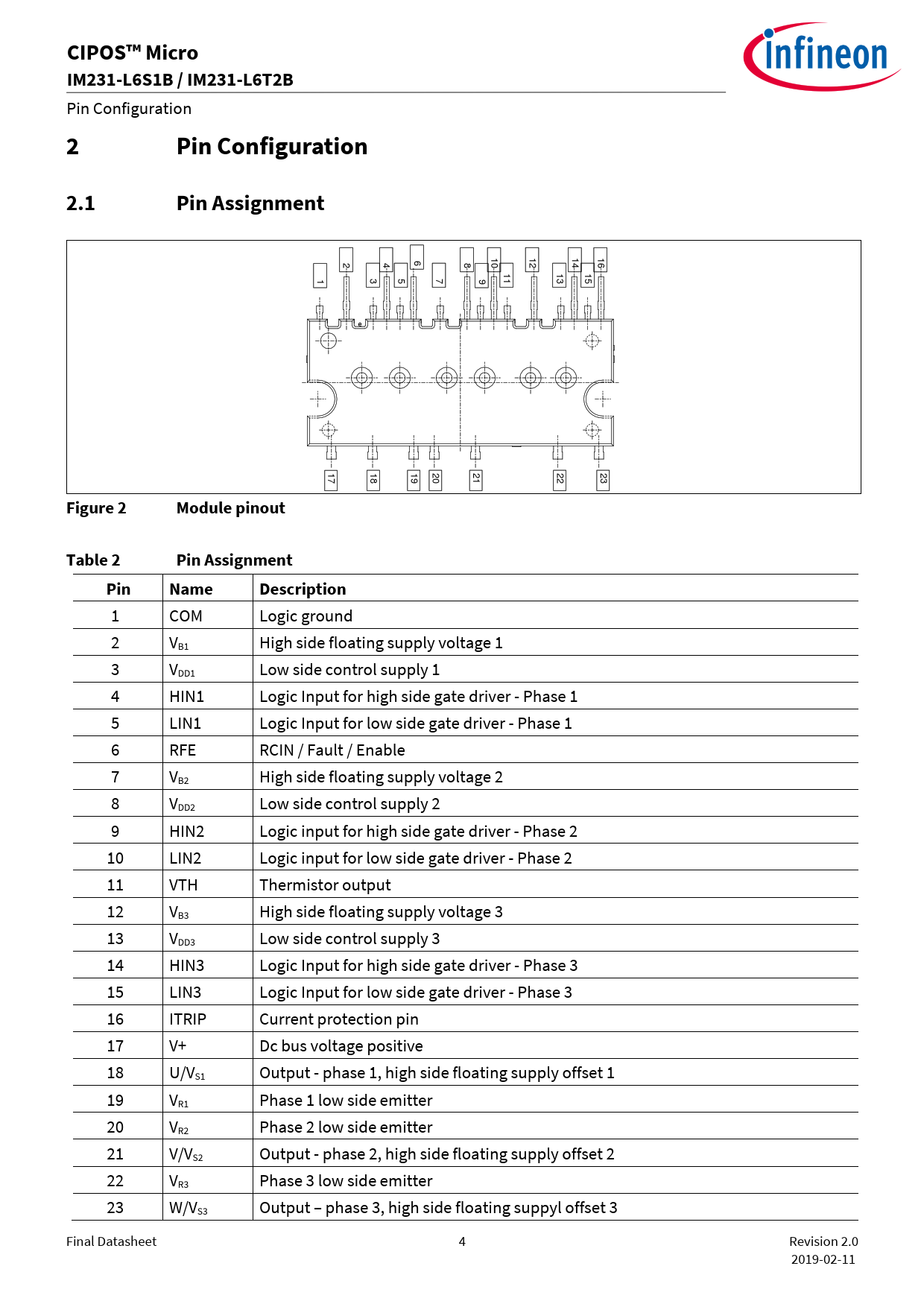

CIPOS™ Micro. IM231-L6S1B / IM231-L6T2B. Pin Configuration. 2.1. Pin Assignment. Figure 2. Module pinout. Table 2. Pin. Name. Description
CIPOS™ Micro IM231-L6S1B / IM231-L6T2B Pin Configuration 2.1 Pin Assignment Figure 2 Module pinout Table 2 Pin Name Description
Pin Configuration
2 Pin Configuration 2.1 Pin Assignment
1 1 1 1 2 4 6 8 0 2 4 6 11 1 1 1 3 5 7 9 3 5 e 17 18 19 20 21 22 23
Figure 2 Module pinout Table 2 Pin Assignment Pin Name Description
1 COM Logic ground 2 VB1 High side floating supply voltage 1 3 VDD1 Low side control supply 1 4 HIN1 Logic Input for high side gate driver - Phase 1 5 LIN1 Logic Input for low side gate driver - Phase 1 6 RFE RCIN / Fault / Enable 7 VB2 High side floating supply voltage 2 8 VDD2 Low side control supply 2 9 HIN2 Logic input for high side gate driver - Phase 2 10 LIN2 Logic input for low side gate driver - Phase 2 11 VTH Thermistor output 12 VB3 High side floating supply voltage 3 13 VDD3 Low side control supply 3 14 HIN3 Logic Input for high side gate driver - Phase 3 15 LIN3 Logic Input for low side gate driver - Phase 3 16 ITRIP Current protection pin 17 V+ Dc bus voltage positive 18 U/VS1 Output - phase 1, high side floating supply offset 1 19 VR1 Phase 1 low side emitter 20 VR2 Phase 2 low side emitter 21 V/VS2 Output - phase 2, high side floating supply offset 2 22 VR3 Phase 3 low side emitter 23 W/VS3 Output – phase 3, high side floating suppyl offset 3 Final Datasheet 4 Revision 2.0 2019-02-11 Document Outline Description Features Potential Applications Product validation Table 1 Part Ordering Table Table of contents 1 Internal Electrical Schematic 2 Pin Configuration 3 Absolute Maximum Rating 4 Thermal Characteristics 5 Recommended Operating Conditions 6 Static Parameters 7 Dynamic Parameters 8 Thermistor Characteristics 9 Mechanical Characteristics and Ratings 10 Qualification Information 11 Diagrams & Tables 12 Application Guide 13 Package Outline Revision History Disclimer
