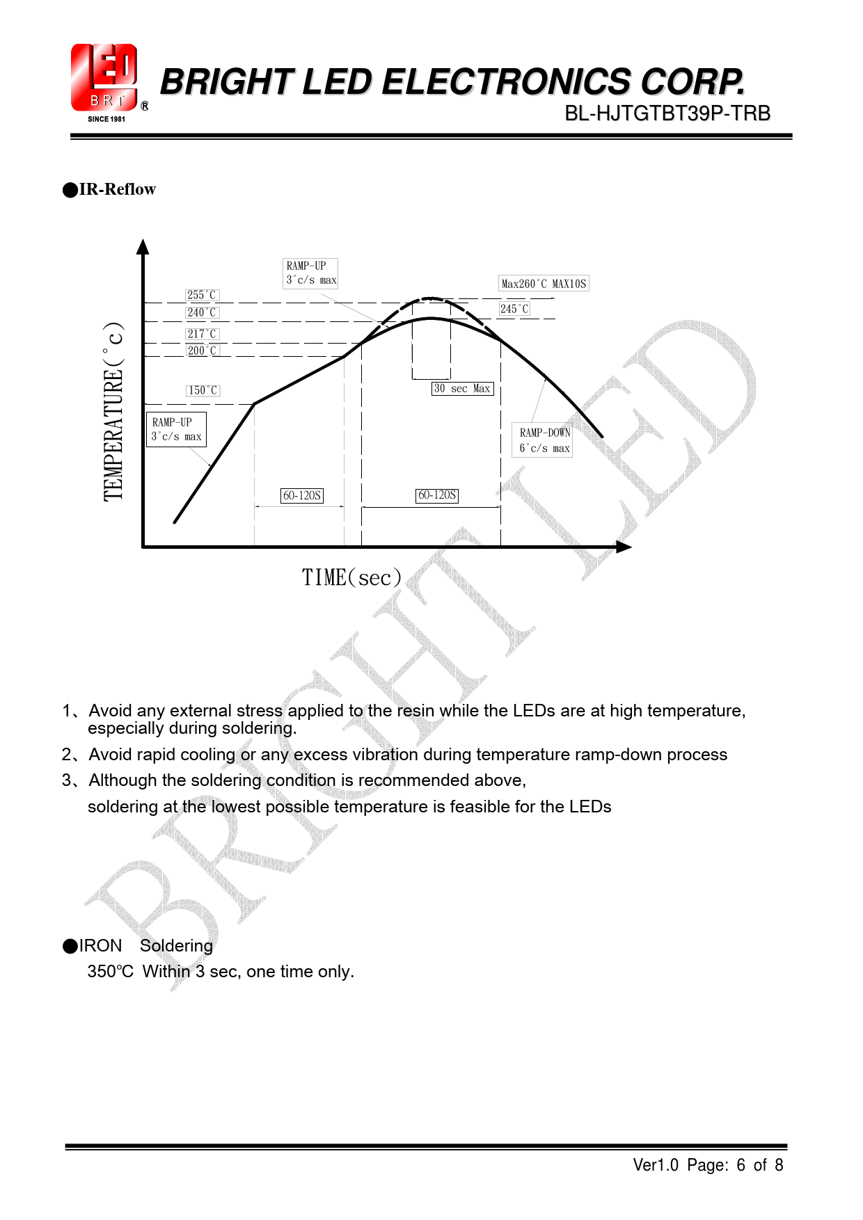

BL-HJTGTBT39P-TRB ●
IR-Reflow
RAMP-UP 3°c/s max Max260°C MAX10S
255°C 240°C 245°C
217°C
200°C
150°C 30 sec Max
RAMP-UP 3°c/s max RAMP-DOWN 6°c/s max TEMPERATURE(°c) 60-120S 60-120S TIME(sec) 1、Avoid any external stress applied to the resin while the LEDs are at high temperature, especially during soldering. 2、Avoid rapid cooling or any excess vibration during temperature ramp-down process 3、Although the soldering condition is recommended above, soldering at the lowest possible temperature is feasible for the LEDs
●IRON Soldering 350℃ Within 3 sec, one time only.
