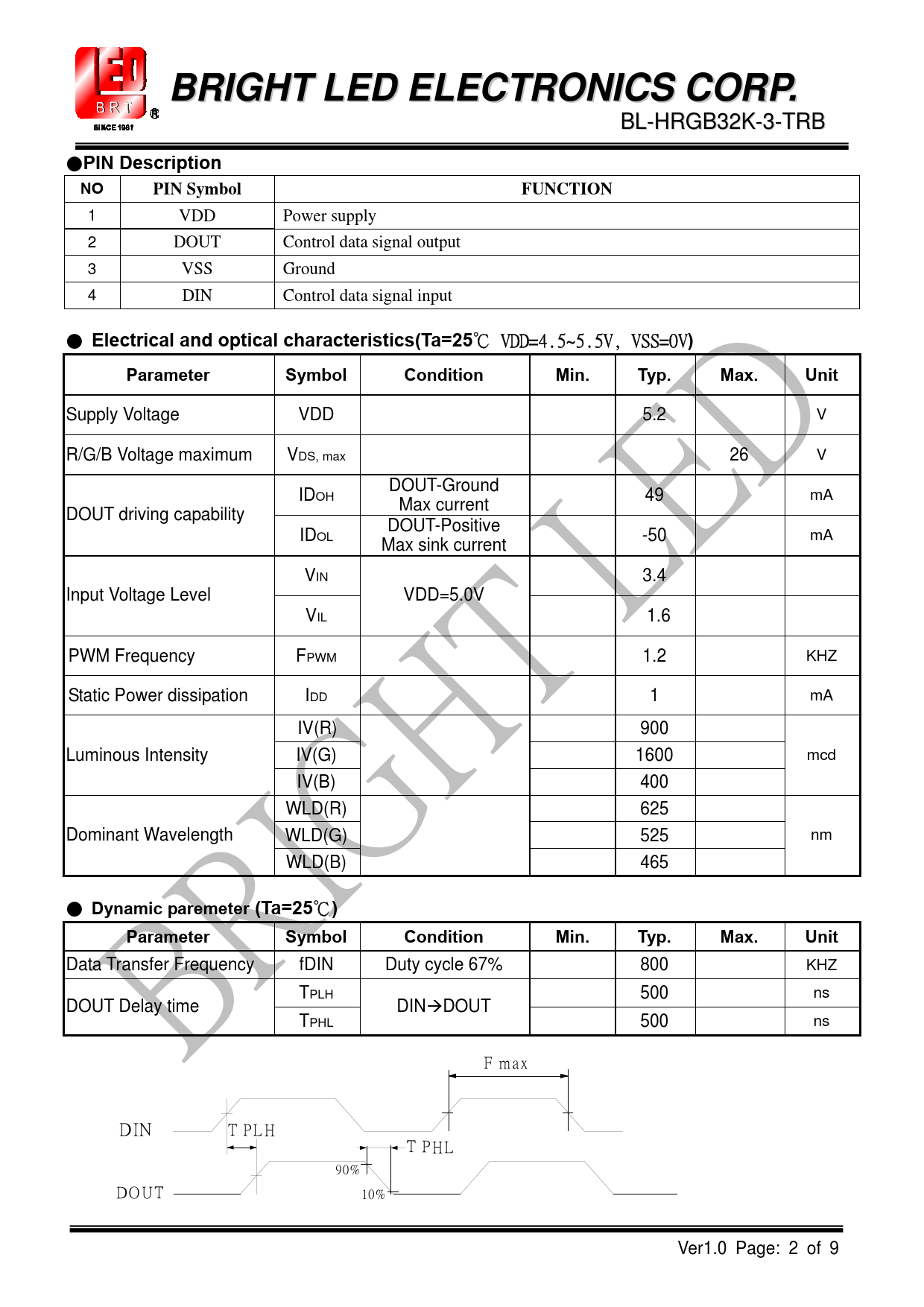

Pages / Page9 / 2 — BRIGHT LED ELECTRONICS CORP. PIN Description. PIN Symbol. FUNCTION. …
BRIGHT LED ELECTRONICS CORP. PIN Description. PIN Symbol. FUNCTION. Electrical and optical characteristics(Ta=25
BRIGHT LED ELECTRONICS CORP PIN Description PIN Symbol FUNCTION Electrical and optical characteristics(Ta=25
BL-HRGB32K-3-TRB
PIN Description NO PIN Symbol FUNCTION
1 VDD Power supply 2 DOUT Control data signal output 3 VSS Ground 4 DIN Control data signal input ●
℃ VDD=4.5~5.5V, VSS=0V
) Parameter Symbol Condition Min. Typ. Max. Unit
Supply Voltage VDD 5.2 V R/G/B Voltage maximum VDS, max 26 V DOUT-Ground IDOH 49 mA Max current DOUT driving capability DOUT-Positive IDOL -50 mA Max sink current VIN 3.4 Input Voltage Level VDD=5.0V VIL 1.6 PWM Frequency FPWM 1.2 KHZ Static Power dissipation IDD 1 mA IV(R) 900 Luminous Intensity IV(G) 1600 mcd IV(B) 400 WLD(R) 625 Dominant Wavelength WLD(G) 525 nm WLD(B) 465 ●
Dynamic paremeter (Ta=25
Data Transfer Frequency fDIN Duty cycle 67% 800 KHZ TPLH 500 ns DOUT Delay time DINÆDOUT TPHL 500 ns F m ax D IN T PLH T PH L 90% D O U T 10% Ver1.0 Page: 2 of 9
