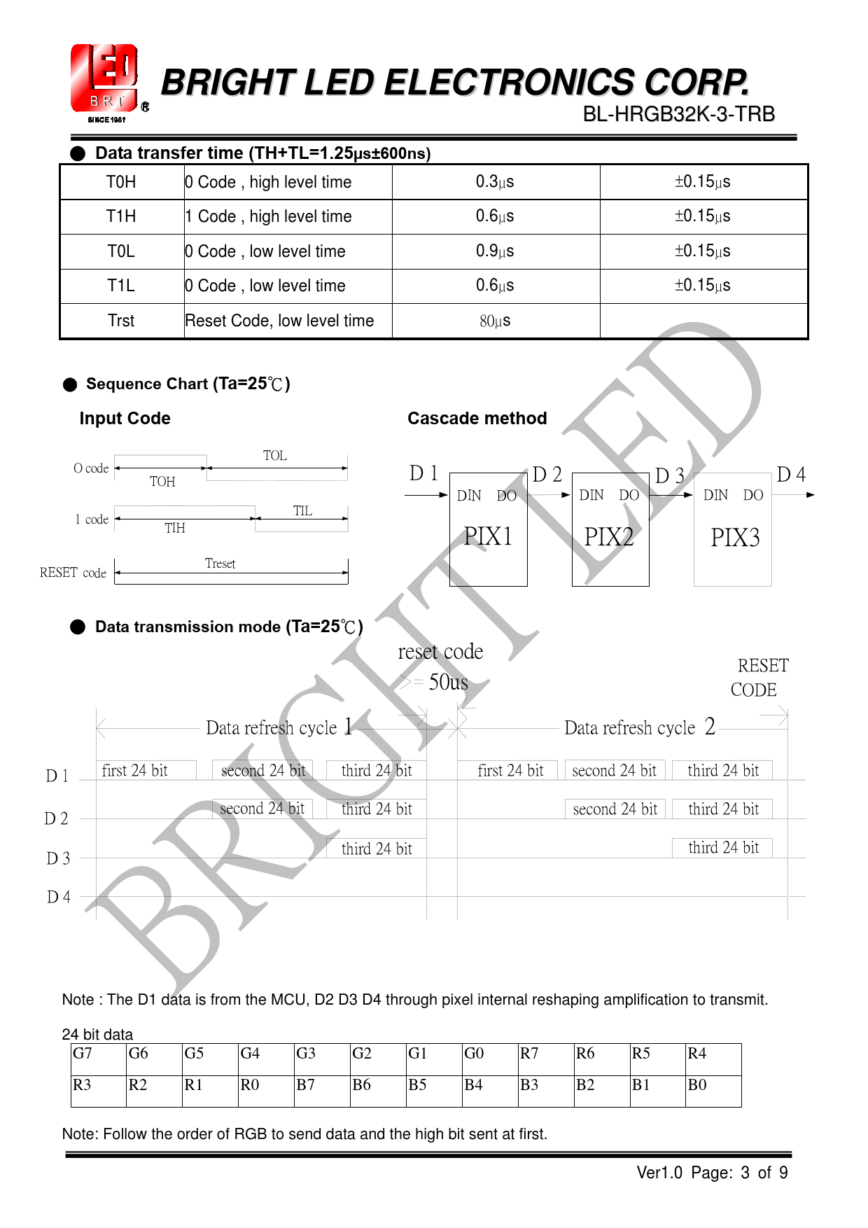

Pages / Page9 / 3 — BRIGHT LED ELECTRONICS CORP. Data transfer time (TH+TL=1.25µs±600ns). …
BRIGHT LED ELECTRONICS CORP. Data transfer time (TH+TL=1.25µs±600ns). Sequence Chart (Ta=25. Input Code Cascade method
BRIGHT LED ELECTRONICS CORP Data transfer time (TH+TL=1.25µs±600ns) Sequence Chart (Ta=25 Input Code Cascade method
BL-HRGB32K-3-TRB
T0H 0 Code , high level time 0.3µs ±0.15µs T1H 1 Code , high level time 0.6µs ±0.15µs T0L 0 Code , low level time 0.9µs ±0.15µs T1L 0 Code , low level time 0.6µs ±0.15µs Trst Reset Code, low level time 80µs
) Input Code Cascade method
TOL O code D 1 D 2 TOH D 3 D 4 DIN DO DIN DO DIN DO TIL 1 code TIH PIX1 PIX2 PIX3 Treset RESET code
Data transmission mode (Ta=25
reset code
RESET
50us CODE
Data refresh cycle 1 Data refresh cycle 2
D 1 first 24 bit second 24 bit third 24 bit first 24 bit second 24 bit third 24 bit second 24 bit third 24 bit second 24 bit third 24 bit D 2 third 24 bit third 24 bit D 3 D 4
Note : The D1 data is from the MCU, D2 D3 D4 through pixel internal reshaping amplification to transmit. 24 bit data G7 G6 G5 G4 G3 G2 G1 G0 R7 R6 R5 R4 R3 R2 R1 R0 B7 B6 B5 B4 B3 B2 B1 B0 Note: Follow the order of RGB to send data and the high bit sent at first. Ver1.0 Page: 3 of 9
