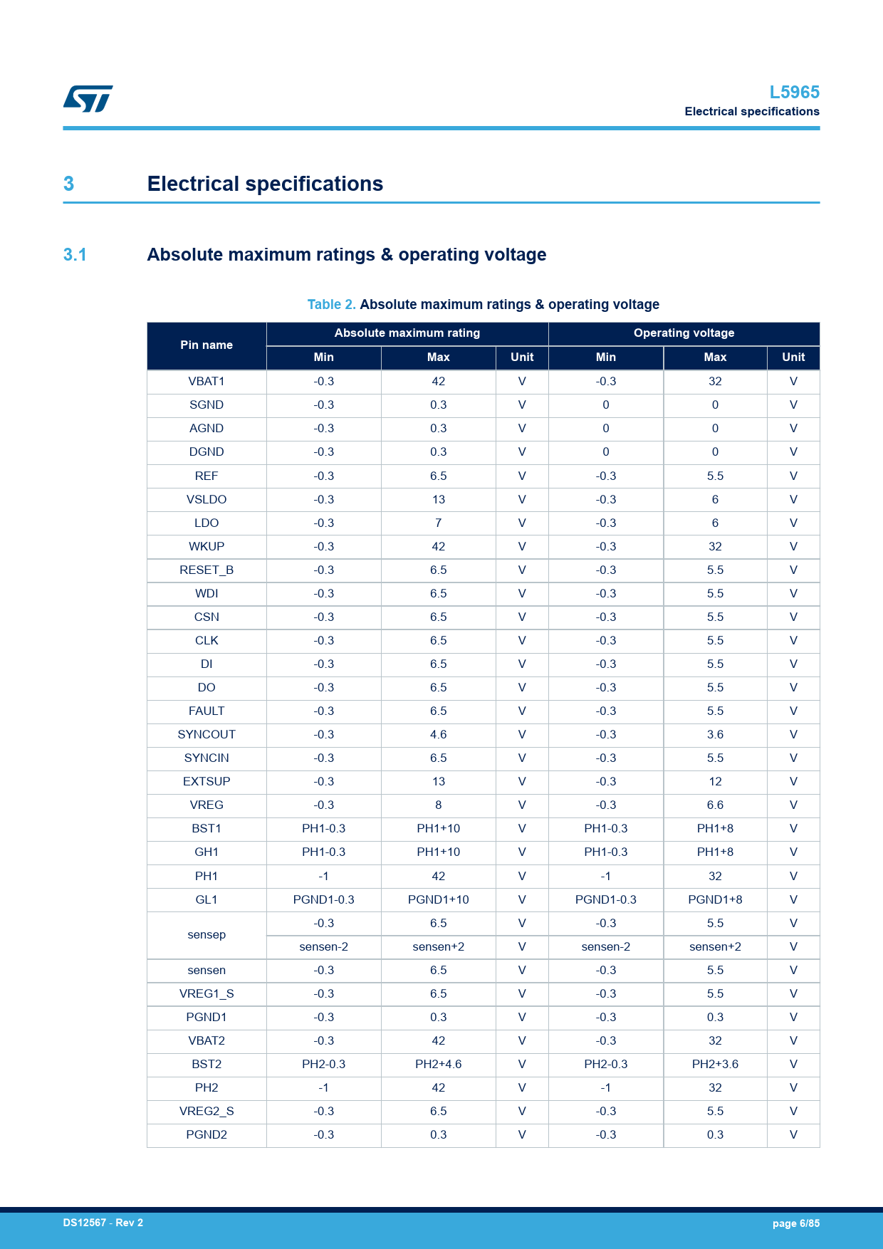

L5965. Electrical specifications. 3.1. Absolute maximum ratings & operating voltage
L5965 Electrical specifications 3 Electrical specifications 3.1 Absolute maximum ratings & operating voltage Table 2. Absolute maximum ratings & operating voltage Absolute maximum rating Operating voltage Pin name Min Max Unit Min Max Unit
VBAT1 -0.3 42 V -0.3 32 V SGND -0.3 0.3 V 0 0 V AGND -0.3 0.3 V 0 0 V DGND -0.3 0.3 V 0 0 V REF -0.3 6.5 V -0.3 5.5 V VSLDO -0.3 13 V -0.3 6 V LDO -0.3 7 V -0.3 6 V WKUP -0.3 42 V -0.3 32 V RESET_B -0.3 6.5 V -0.3 5.5 V WDI -0.3 6.5 V -0.3 5.5 V CSN -0.3 6.5 V -0.3 5.5 V CLK -0.3 6.5 V -0.3 5.5 V DI -0.3 6.5 V -0.3 5.5 V DO -0.3 6.5 V -0.3 5.5 V FAULT -0.3 6.5 V -0.3 5.5 V SYNCOUT -0.3 4.6 V -0.3 3.6 V SYNCIN -0.3 6.5 V -0.3 5.5 V EXTSUP -0.3 13 V -0.3 12 V VREG -0.3 8 V -0.3 6.6 V BST1 PH1-0.3 PH1+10 V PH1-0.3 PH1+8 V GH1 PH1-0.3 PH1+10 V PH1-0.3 PH1+8 V PH1 -1 42 V -1 32 V GL1 PGND1-0.3 PGND1+10 V PGND1-0.3 PGND1+8 V -0.3 6.5 V -0.3 5.5 V sensep sensen-2 sensen+2 V sensen-2 sensen+2 V sensen -0.3 6.5 V -0.3 5.5 V VREG1_S -0.3 6.5 V -0.3 5.5 V PGND1 -0.3 0.3 V -0.3 0.3 V VBAT2 -0.3 42 V -0.3 32 V BST2 PH2-0.3 PH2+4.6 V PH2-0.3 PH2+3.6 V PH2 -1 42 V -1 32 V VREG2_S -0.3 6.5 V -0.3 5.5 V PGND2 -0.3 0.3 V -0.3 0.3 V
