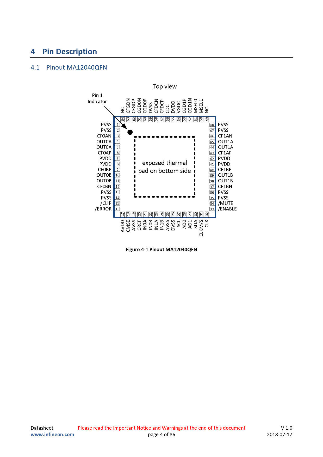

Pages / Page86 / 4 — 4 Pin Description. Figure 4-1 Pinout MA12040QFN. www.infineon.com
Revision01_00
4 Pin Description Figure 4-1 Pinout MA12040QFN www.infineon.com
4 Pin Description
4.1 Pinout MA12040QFN N P N P N P P N D D 0 0 D C 1 1 D D SS C C C D D D D C FG FG G G V FD FD D V G G G SEL0 SEL1 C N C C C C D C C C D V C C M M N 4 3 2 1 0 9 8 7 6 5 4 3 2 1 0 9 6 6 6 6 6 5 5 5 5 5 5 5 5 5 5 4 7 8 9 0 1 2 3 4 5 6 7 8 9 0 1 2 1 1 1 2 2 2 2 2 2 2 2 2 2 3 3 3 D A A L 0 1 A D SE SS EF 0 0B 1 1B SS SS D D /S LK V M V R V V SC A A SD M C A C A C IN IN IN IN A D LK C
