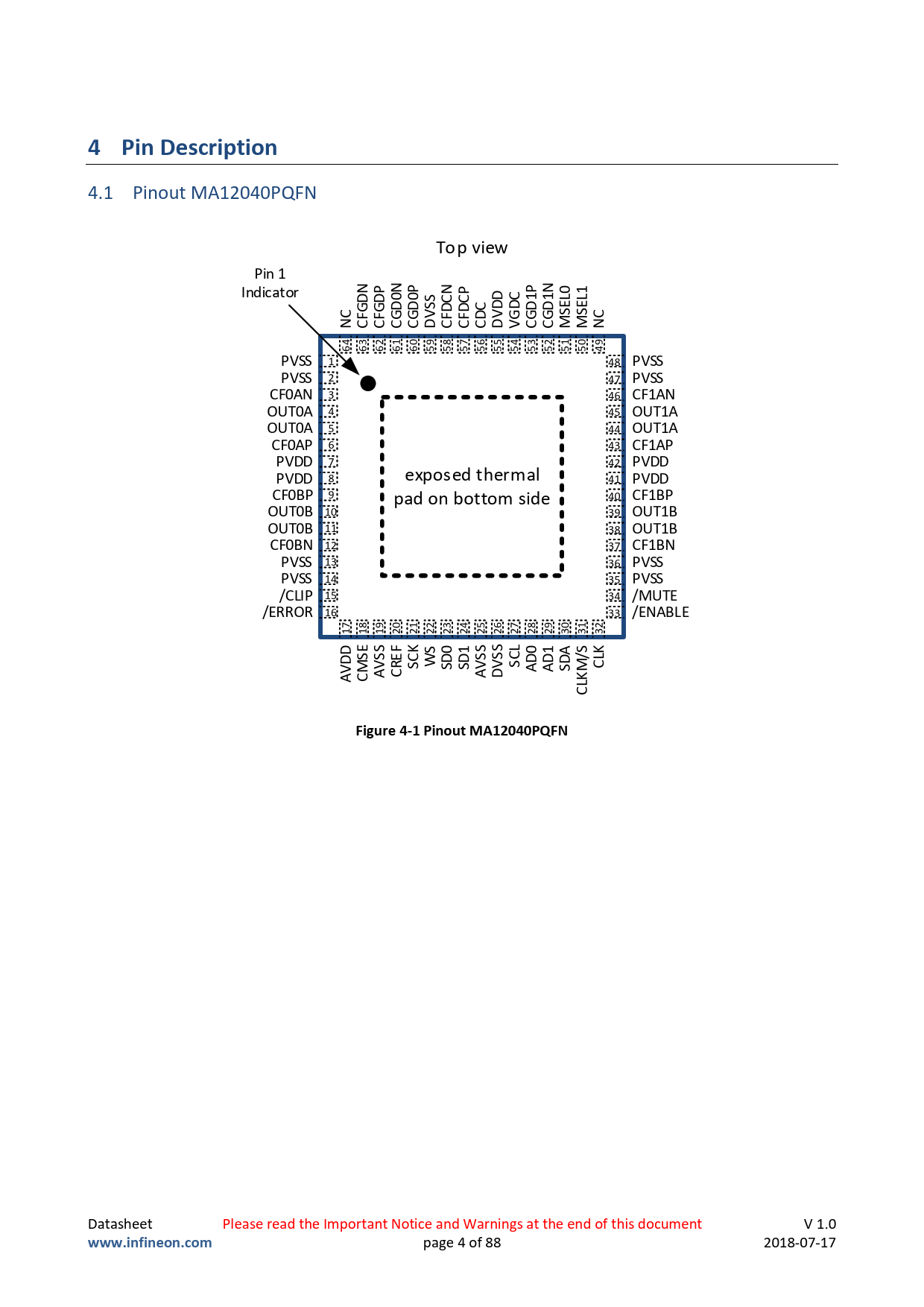

Pages / Page88 / 4 — 4 Pin Description. Figure 4-1 Pinout MA12040PQFN. www.infineon.com
Revision01_00
4 Pin Description Figure 4-1 Pinout MA12040PQFN www.infineon.com
4 Pin Description
4.1 Pinout MA12040PQFN Top view Pin 1 N P Indicator N P D D 0N 0P D C 1P 1N L0 L1 SS C C D D C D D C D D FG FG G G FD FD D G G G SE SE C N C C C C DV C C C DV V C C M M N 64 63 62 61 60 59 58 57 56 55 54 53 52 51 50 49 PVSS 1 48 PVSS PVSS 2 47 PVSS CF0AN 3 46 CF1AN OUT0A 4 45 OUT1A OUT0A 5 44 OUT1A CF0AP 6 43 CF1AP PVDD 7 42 PVDD PVDD 8 exposed thermal 41 PVDD CF0BP 9 40 CF1BP pad on bottom side OUT0B 10 39 OUT1B OUT0B 11 38 OUT1B CF0BN 12 37 CF1BN PVSS 13 36 PVSS PVSS 14 35 PVSS /CLIP 15 34 /MUTE /ERROR 16 33 /ENABLE 17 18 19 20 21 22 23 24 25 26 27 28 29 30 31 32 F K S 0 1 L 0 1 A DD SE SS SS SS D D /S LK V M V RE SC W SD SD V SC A A SD M C A C A C A DV LK C
