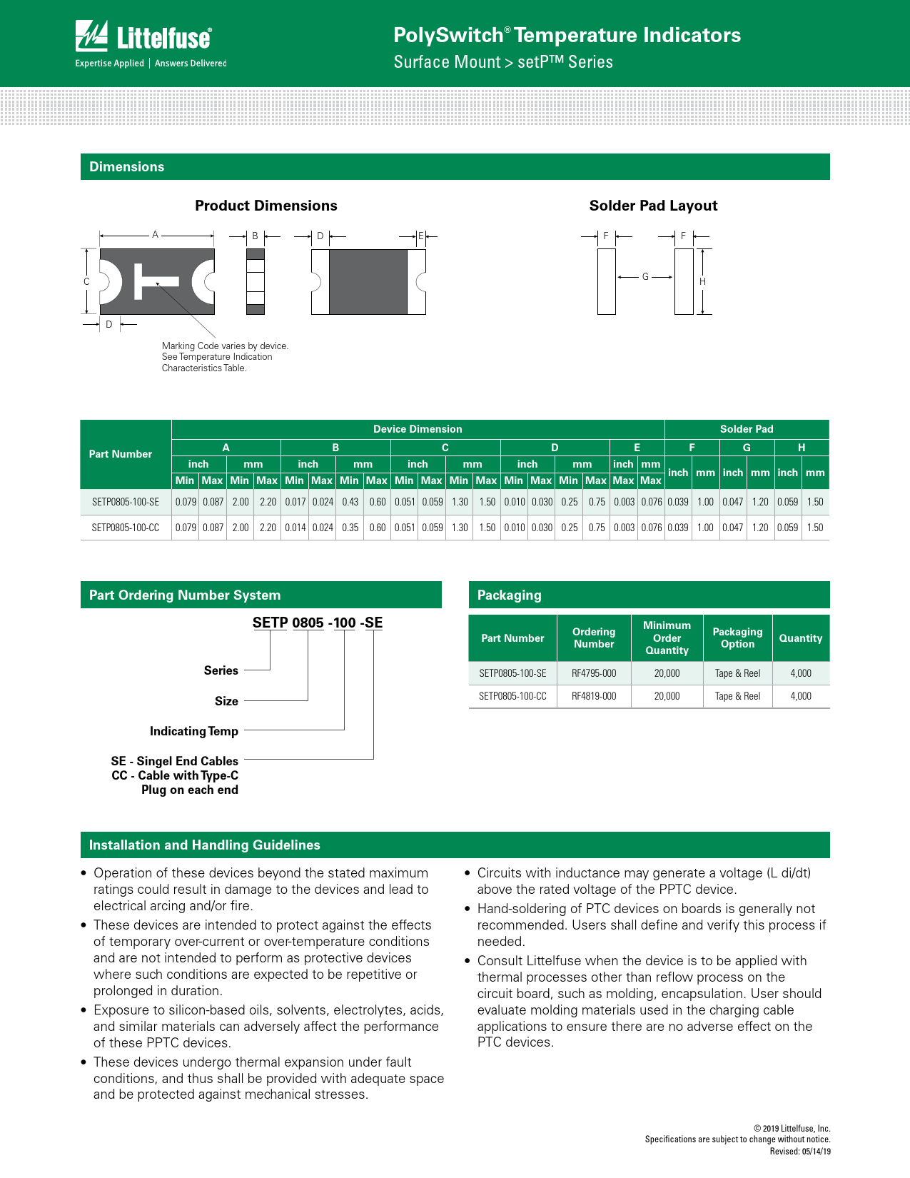

PolySwitch® Temperature Indicators. Dimensions. Product Dimensions. Solder Pad Layout. Device Dimension. Solder Pad. Part Number
PolySwitch® Temperature Indicators Dimensions Product Dimensions Solder Pad Layout Device Dimension Solder Pad Part Number
Surface Mount > setP™ Series
A A B B D D E E F F F F C G C G H H D D Marking Code varies by Marking Code v device. aries by device. See Temperat See T ure Indication emperature Indication Characteristics Table. Characteristics Table.
Device Dimension Solder Pad A B C D E F G H Part Number inch mm inch mm inch mm inch mm inch mm inch mm inch mm inch mm Min Max Min Max Min Max Min Max Min Max Min Max Min Max Min Max Max Max
SETP0805-100-SE 0.079 0.087 2.00 2.20 0.017 0.024 0.43 0.60 0.051 0.059 1.30 1.50 0.010 0.030 0.25 0.75 0.003 0.076 0.039 1.00 0.047 1.20 0.059 1.50 SETP0805-100-CC 0.079 0.087 2.00 2.20 0.014 0.024 0.35 0.60 0.051 0.059 1.30 1.50 0.010 0.030 0.25 0.75 0.003 0.076 0.039 1.00 0.047 1.20 0.059 1.50
Part Ordering Number System Packaging SETP 0805 -100 -SE Minimum Ordering Packaging Part Number Order Quantity Number Option Quantity Series
SETP0805-100-SE RF4795-000 20,000 Tape & Reel 4,000 SETP0805-100-CC RF4819-000 20,000 Tape & Reel 4,000
Size Indicating Temp SE - Singel End Cables CC - Cable with Type-C Plug on each end Installation and Handling Guidelines
• Operation of these devices beyond the stated maximum • Circuits with inductance may generate a voltage (L di/dt) ratings could result in damage to the devices and lead to above the rated voltage of the PPTC device. electrical arcing and/or fire. • Hand-soldering of PTC devices on boards is generally not • These devices are intended to protect against the effects recommended. Users shall define and verify this process if of temporary over-current or over-temperature conditions needed. and are not intended to perform as protective devices • Consult Littelfuse when the device is to be applied with where such conditions are expected to be repetitive or thermal processes other than reflow process on the prolonged in duration. circuit board, such as molding, encapsulation. User should • Exposure to silicon-based oils, solvents, electrolytes, acids, evaluate molding materials used in the charging cable and similar materials can adversely affect the performance applications to ensure there are no adverse effect on the of these PPTC devices. PTC devices. • These devices undergo thermal expansion under fault conditions, and thus shall be provided with adequate space and be protected against mechanical stresses. © 2019 Littelfuse, Inc. Specifications are subject to change without notice. Revised: 05/14/19
