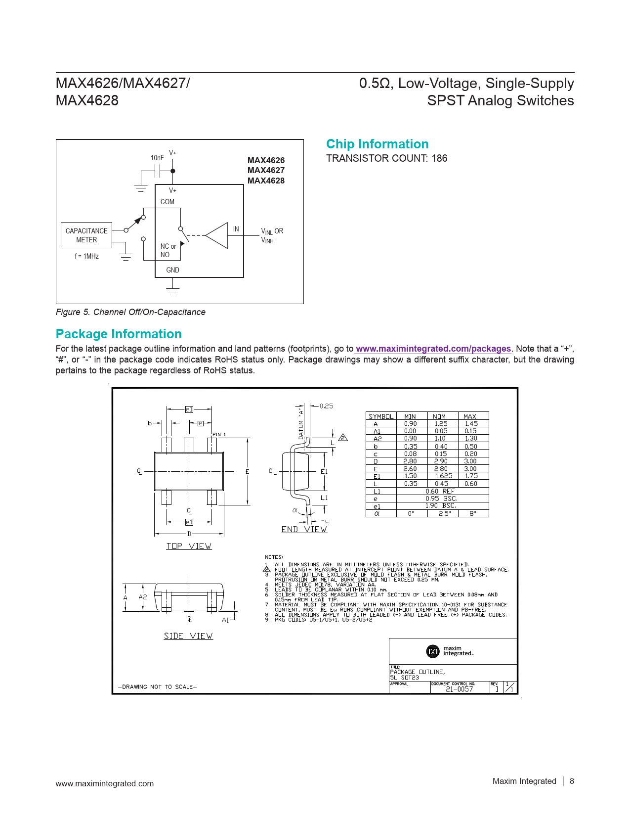

MAX4626/MAX4627/ 0.5Ω, Low-Voltage, Single-Supply MAX4628 SPST Analog Switches
Chip Information
V+ 10nF
MAX4626
TRANSISTOR COUNT: 186
MAX4627 MAX4628
V+ COM CAPACITANCE IN VINL OR METER V NC or INH f = 1MHz NO GND Figure 5. Channel Off/On-Capacitance
Package Information
For the latest package outline information and land patterns (footprints), go to
www.maximintegrated.com/packages
. Note that a “+”, “#”, or “-” in the package code indicates RoHS status only. Package drawings may show a different suffix character, but the drawing pertains to the package regardless of RoHS status. www.maximintegrated.com Maxim Integrated │
