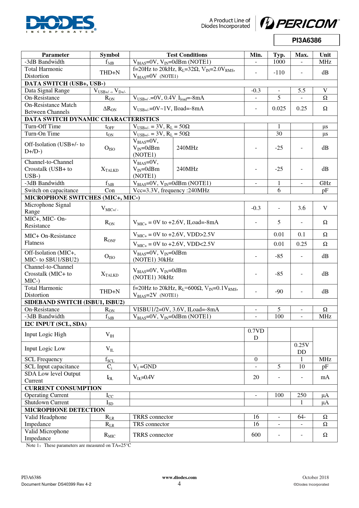

PI3A6386. Parameter. Symbol. Test Conditions. Min. Typ. Max. Unit. DATA SWITCH (USB+, USB-). DATA SWITCH DYNAMIC CHARACTERISTICS
PI3A6386 Parameter Symbol Test Conditions Min Typ Max Unit DATA SWITCH (USB+, USB-) DATA SWITCH DYNAMIC CHARACTERISTICS
PI3A6386 Parameter Symbol Test Conditions Min. Typ. Max. Unit
-3dB Bandwidth f3dB VBIAS=0V, VIN=0dBm (NOTE1) - 1000 - MHz Total Harmonic f=20Hz to 20kHz, R THD+N L=32Ω, VIN=2.0VRMS, - -110 - dB Distortion VBIAS=0V (NOTE1)
Data Signal Range
VUSB+/ -, VD+/- -0.3 - 5.5 V On-Resistance
RON VUSB+/ -=0V, 0.4V. Iload=-8mA - 5 - Ω On-Resistance Match ΔR Between Channels
ON VUSB+/-=0V~1V, Iload=-8mA - 0.025 0.25 Ω
Turn-Off Time tOFF VUSB+/- = 3V, RL = 50Ω 1 μs Turn-On Time tON VUSB+/- = 3V, RL = 50Ω 30 μs V Off-Isolation (USB+/- to BIAS=0V, O V 240MHz - -25 - dB D+/D-) ISO IN=0dBm (NOTE1) Channel-to-Channel VBIAS=0V, Crosstalk (USB+ to XTALKD VIN=0dBm 240MHz - -25 - dB USB-) (NOTE1) -3dB Bandwidth f3dB VBIAS=0V, VIN=0dBm (NOTE1) - 1 - GHz Switch on capacitance Con Vcc=3.3V, frequency :240MHz 6 pF
MICROPHONE SWITCHES (MIC+, MIC-)
Microphone Signal V Range
MIC+/ - -0.3 - 3.6 V MIC+, MIC- On- R Resistance
ON VMIC+ = 0V to +2.6V, ILoad=-8mA - 5 - Ω MIC+ On-Resistance VMIC+ = 0V to +2.6V, VDD>2.5V 0.01 0.1 Ω R Flatness
ONF VMIC+ = 0V to +2.6V, VDD<2.5V 0.01 0.25 Ω Off-Isolation (MIC+, V O BIAS=0V, VIN=0dBm - -85 - dB MIC- to SBU1/SBU2) ISO (NOTE1) 30kHz Channel-to-Channel V Crosstalk (MIC+ to X BIAS=0V, VIN=0dBm TALKD - -85 - dB (NOTE1) 30kHz MIC-) Total Harmonic f=20Hz to 20kHz, R =600Ω, V THD+N L IN=0.1VRMS, - -90 - dB Distortion VBIAS=2V (NOTE1)
SIDEBAND SWITCH (ISBU1, ISBU2)
On-Resistance
RON VISBU1/2=0V, 3.6V, ILoad=-8mA - 5 - Ω -3dB Bandwidth f3dB VBIAS=0V, VIN=0dBm (NOTE1) - 100 - MHz
I2C INPUT (SCL, SDA)
0.7VD Input Logic High VIH
D 0.25V Input Logic Low VIL DD SCL Frequency fSCL 0 1 MHz SCL Input capacitance Ci VI =GND - 5 10 pF SDA Low level Output I Current OL VOL=0.4V 20 - - mA
CURRENT CONSUMPTION
Operating Current ICC - 100 250 μA Shutdown Current ISD 1 μA
MICROPHONE DETECTION
Valid Headphone RLR TRRS connector 16 - 64- Ω Impedance
RLR TRS connector 16 - - Ω Valid Microphone R Impedance MIC TRRS connector 600 - - Ω Note 1:These parameters are measured on TA=25°C PI3A6386
