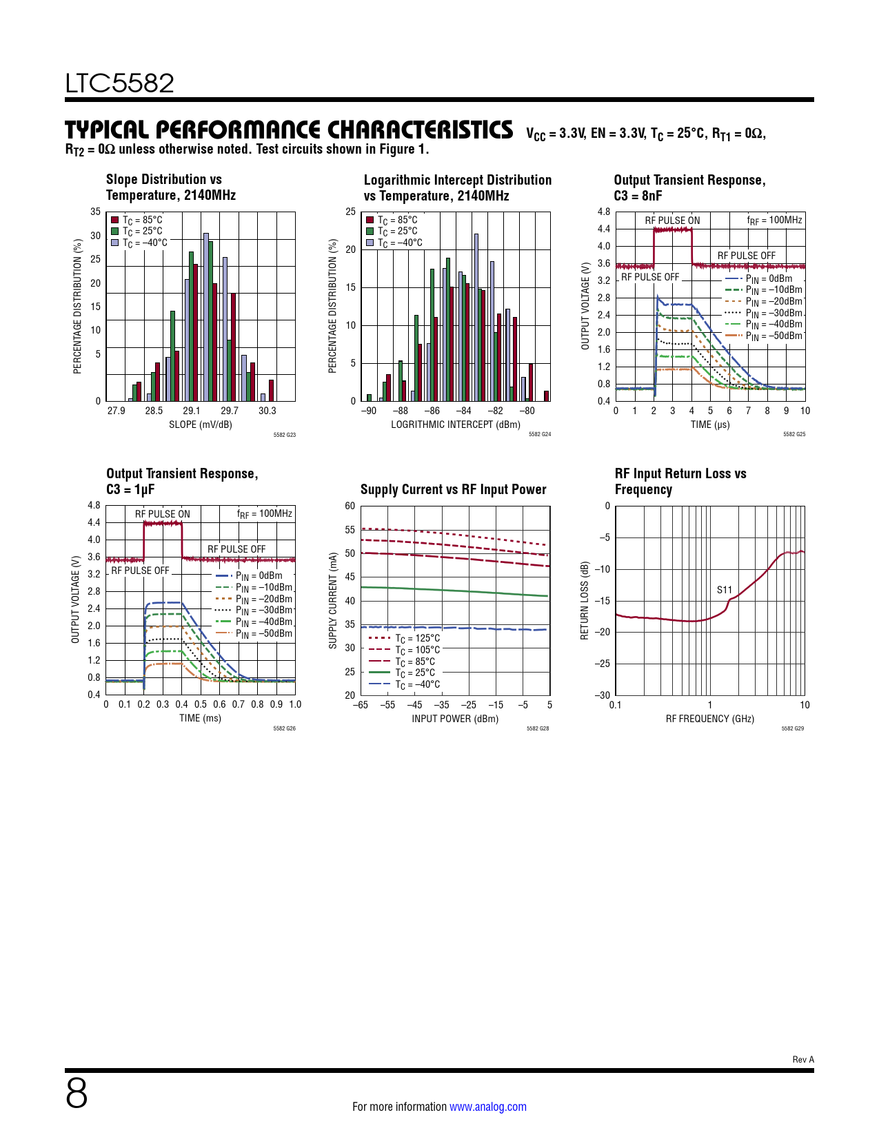

TYPICAL PERFORMANCE CHARACTERISTICS VCC = 3.3V, EN = 3.3V, TC = 25°C, RT1 = 0Ω,
link to page 10 LTC5582
TYPICAL PERFORMANCE CHARACTERISTICS VCC = 3.3V, EN = 3.3V, TC = 25°C, RT1 = 0Ω, RT2 = 0Ω unless otherwise noted. Test circuits shown in Figure 1. Slope Distribution vs Logarithmic Intercept Distribution Output Transient Response, Temperature, 2140MHz vs Temperature, 2140MHz C3 = 8nF
35 25 4.8 TC = 85°C TC = 85°C RF PULSE ON fRF = 100MHz T T 4.4 30 C = 25°C C = 25°C TC = –40°C TC = –40°C 4.0 20 RF PULSE OFF 25 3.6 20 3.2 RF PULSE OFF PIN = 0dBm 15 TAGE (V) P 2.8 IN = –10dBm PIN = –20dBm 15 2.4 PIN = –30dBm 10 P AGE DISTRIBUTION (%) 10 AGE DISTRIBUTION (%) 2.0 IN = –40dBm PIN = –50dBm OUTPUT VOL 1.6 5 5 1.2 PERCENT PERCENT 0.8 0 0 0.4 27.9 28.5 29.1 29.7 30.3 –90 –88 –86 –84 –82 –80 0 1 2 3 4 5 6 7 8 9 10 SLOPE (mV/dB) LOGRITHMIC INTERCEPT (dBm) TIME (µs) 5582 G23 5582 G24 5582 G25
Output Transient Response, RF Input Return Loss vs C3 = 1µF Supply Current vs RF Input Power Frequency
4.8 60 0 RF PULSE ON fRF = 100MHz 4.4 55 4.0 –5 RF PULSE OFF 50 3.6 RF PULSE OFF –10 3.2 PIN = 0dBm 45 TAGE (V) 2.8 PIN = –10dBm S11 PIN = –20dBm 40 –15 2.4 PIN = –30dBm P Y CURRENT (mA) 2.0 IN = –40dBm 35 P OUTPUT VOL IN = –50dBm T –20 RETURN LOSS (dB) 1.6 SUPPL C = 125°C 30 TC = 105°C 1.2 TC = 85°C –25 25 TC = 25°C 0.8 TC = –40°C 0.4 20 –30 0 0.1 0.2 0.3 0.4 0.5 0.6 0.7 0.8 0.9 1.0 –65 –55 –45 –35 –25 –15 –5 5 0.1 1 10 TIME (ms) INPUT POWER (dBm) RF FREQUENCY (GHz) 5582 G26 5582 G28 5582 G29 Rev A 8 For more information www.analog.com Document Outline Features Applications Description Typical Application Absolute Maximum Ratings Pin Configuration Order Information Electrical Characteristics Typical Performance Characteristics Pin Functions Test Circuits Applications Information Package Description Revision History Typical Application Related Parts Features Applications Typical Application Description Absolute Maximum Ratings Order Information Electrical Characteristics Pin Configuration Typical Performance Characteristics Pin Functions Test Circuits Applications Information Package Description Revision History Typical Application Related Parts
