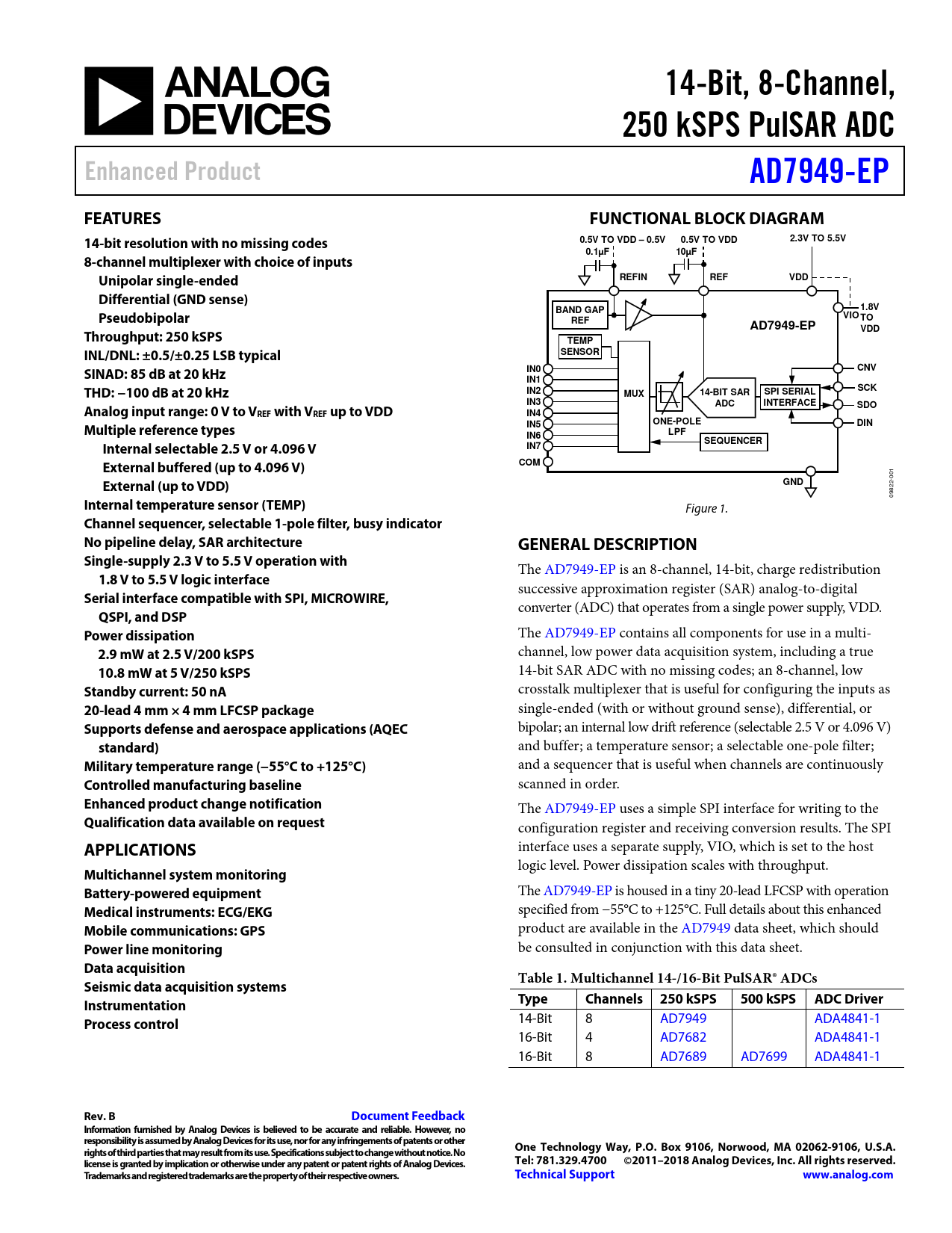

14-Bit, 8-Channel, 250 kSPS PulSAR ADC Enhanced Product AD7949-EP FEATURES FUNCTIONAL BLOCK DIAGRAM 14-bit resolution with no missing codes 0.5V TO VDD – 0.5V 0.5V TO VDD 2.3V TO 5.5V 0.1µF 10µF 8-channel multiplexer with choice of inputs Unipolar single-ended REFIN REF VDD Differential (GND sense) 1.8V BAND GAP Pseudobipolar VIO TO REF AD7949-EP VDD Throughput: 250 kSPS TEMP INL/DNL: ±0.5/±0.25 LSB typical SENSOR IN0 CNV SINAD: 85 dB at 20 kHz IN1 THD: −100 dB at 20 kHz SCK IN2 SPI SERIAL MUX 14-BIT SAR IN3 ADC INTERFACE SDO Analog input range: 0 V to VREF with VREF up to VDD IN4 IN5 ONE-POLE DIN Multiple reference types IN6 LPF SEQUENCER Internal selectable 2.5 V or 4.096 V IN7 External buffered (up to 4.096 V) COM

Figure 1.
Channel sequencer, selectable 1-pole filter, busy indicator No pipeline delay, SAR architecture GENERAL DESCRIPTION Single-supply 2.3 V to 5.5 V operation with
The AD7949-EP is an 8-channel, 14-bit, charge redistribution
1.8 V to 5.5 V logic interface
successive approximation register (SAR) analog-to-digital
Serial interface compatible with SPI, MICROWIRE,
converter (ADC) that operates from a single power supply, VDD.
QSPI, and DSP Power dissipation
The AD7949-EP contains all components for use in a multi-
2.9 mW at 2.5 V/200 kSPS
channel, low power data acquisition system, including a true
10.8 mW at 5 V/250 kSPS
14-bit SAR ADC with no missing codes; an 8-channel, low
Standby current: 50 nA
crosstalk multiplexer that is useful for configuring the inputs as
20-lead 4 mm × 4 mm LFCSP package
single-ended (with or without ground sense), differential, or
Supports defense and aerospace applications (AQEC
bipolar; an internal low drift reference (selectable 2.5 V or 4.096 V)
standard)
and buffer; a temperature sensor; a selectable one-pole filter;
Military temperature range (−55°C to +125°C)
and a sequencer that is useful when channels are continuously
Controlled manufacturing baseline
scanned in order.
Enhanced product change notification
The AD7949-EP uses a simple SPI interface for writing to the
Qualification data available on request
configuration register and receiving conversion results. The SPI
APPLICATIONS
interface uses a separate supply, VIO, which is set to the host logic level. Power dissipation scales with throughput.
Multichannel system monitoring Battery-powered equipment
The AD7949-EP is housed in a tiny 20-lead LFCSP with operation
Medical instruments: ECG/EKG
specified from −55°C to +125°C. Full details about this enhanced
Mobile communications: GPS
product are available in the AD7949 data sheet, which should
Power line monitoring
be consulted in conjunction with this data sheet.
Data acquisition Table 1. Multichannel 14-/16-Bit PulSAR® ADCs Seismic data acquisition systems Type Channels 250 kSPS 500 kSPS ADC Driver Instrumentation Process control
14-Bit 8 AD7949 ADA4841-1 16-Bit 4 AD7682 ADA4841-1 16-Bit 8 AD7689 AD7699 ADA4841-1
